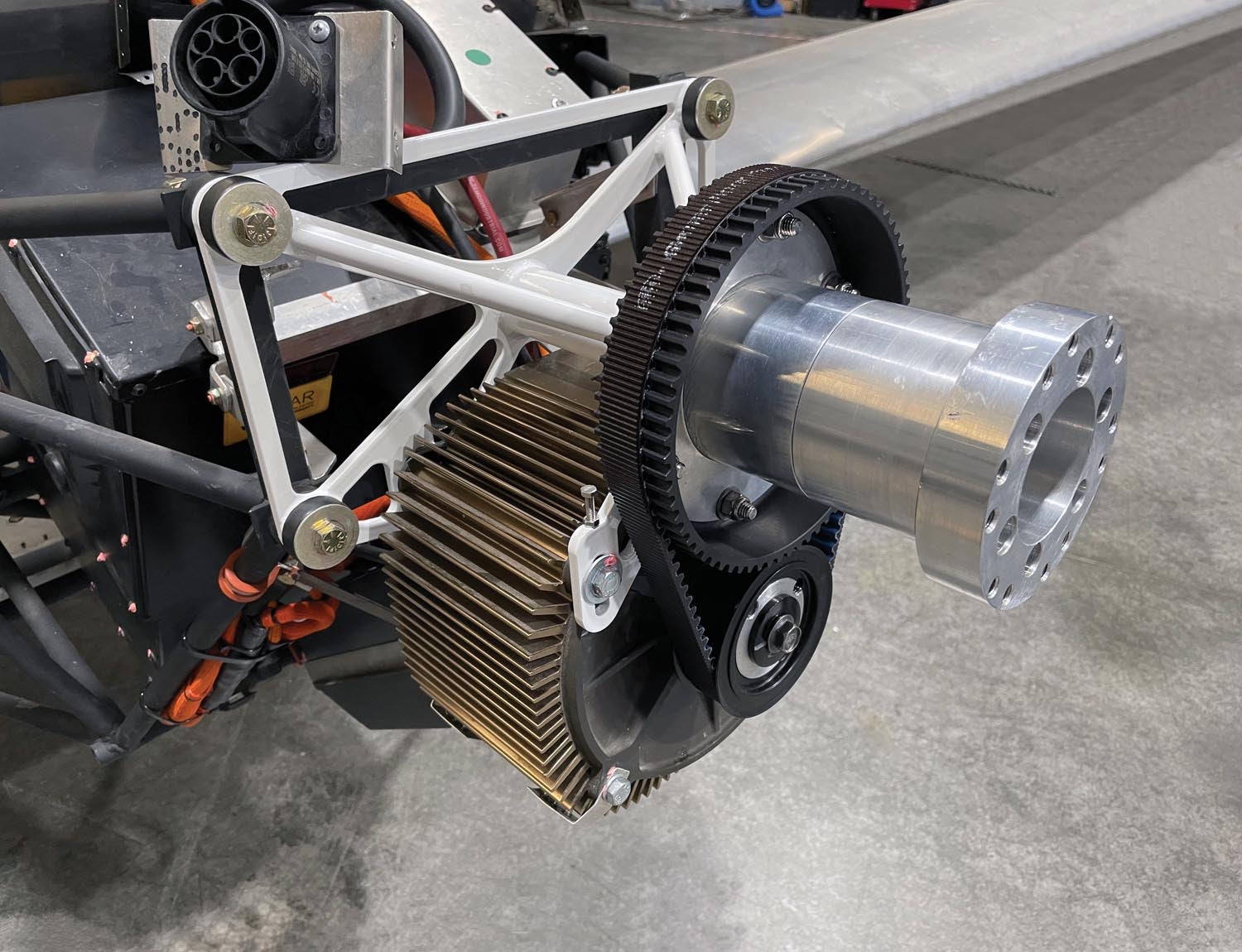

The complete Zaero reduction drive kit is spread out on the table (left). DeVault engineered the parts and has them manufactured at local machine shops to precise standards. The author and DeVault looked over the parts at delivery (right).

Once you have procured your “power system” (motorcycle) and you have the airframe on order or underway, you still need some parts to turn the motorcycle parts into an airplane engine—or more technically correct, a motor. Enter Zaero—Gabe DeVault’s company name for his reduction-drive package. The package includes everything that you need to make the conversion—a reduction drive frame, belt pulleys, drive belt and assorted fasteners. Gabe even includes a quadrant-style throttle that will be used in place of the twist throttle on the bike, as well as motor shock mounts to attach the re-drive to the actual motor/battery mount, which can be sourced from Sonex.
Gabe is also the source and repository of all knowledge relating to the conversion, and is fairly essential—as all designers are—in the early days of this conversion. Early adopters (we are one of the first two customers for his package) understand that little is written down at this point and are working off of photos and verbal instructions from Gabe when needed. Fortunately, the package is very straightforward and easy to understand from the pictures alone—but Gabe’s importance will reappear during assembly due to the need to reprogram the computer so that the power package is made compatible with its aviation use.
Because we are such an early adopter and Gabe is located about an hour’s RV flight away, it was easy to work with him to do the reprogramming and to exchange ideas and advice. The ideas and advice are available to everyone via the internet, email and telephone, no matter where you’re located. The reprogramming—for now—was convenient because of proximity, but availability to a more distant customer base is still to be determined. The actual steps to be taken can be easily documented but, at this point, Gabe is the owner of the only programming interface cable in captivity outside of the Zero dealer network, which is unlikely to be of use to aviation users.e xenos pt2 04

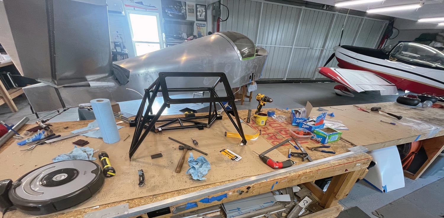

Sonex Aircraft was quick to embrace the idea of the electric Xenos and was willing to take on the task of creating a new engine/battery mount for us—and then make it available to others who follow along. The mount is a welded assembly that consists of the standard Xenos landing gear truss and mounting ears (to the fuselage) and a custom set of tubes to accommodate mounting the battery and the Zaero re-drive. The mount was done with a CAD system and the mounting tabs for the battery aligned perfectly, despite the fact that Sonex has never had one of the batteries in hand—the power of CAD.
The mount attaches to the airframe exactly the way the mounts for the AeroVee or Jabiru would and is soon going to be available for the B-model Xenos as well. For those interested in a very short-endurance sport plane (impractical at this time, but a nice thought experiment nonetheless), the same mount fits a Sonex or Waiex airframe.
e xenos pt2 14
The Sonex-built motor/battery mount is test fit to the fuselage (left). The CAD design fit perfectly after removing the standard AeroVee mount. DeVault’s re-drive frame bolts right to the front of the motor mount (right).
