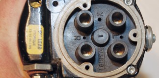

Mounting the prop-reduction drive (re-drive) is simple and has no options—it is supplied with rubber mounts and fits where intended on the big motor mount. The bike’s electric motor fits underneath the output shaft and hangs on four metric bolts, which thread into the motor housing itself. They aren’t part of the re-drive kit but are easily obtained from the usual hardware sources. The re-drive has adjusting screws for each of the four bolts—ingenious little screws (with locknuts) that allow you to fine-tune belt tension. It does take a little fiddling to make sure that you not only have the belt tension correct, but that the shaft of the motor is almost parallel to the output shaft. You actually want them very, very slightly convergent so that the belt will not run off the back end of the driven pulley. This is a place to take your time and get it right!
The re-drive itself is very simple. The bearings ride on the central shaft and support the output wheel, which mounts the driven pulley in back. On the front, you bolt the prop flange—this can be designed to fit any prop, of course, but in our case it is set up with six holes on a 4-inch circle—standard for the size prop you use on a Xenos. There is no easy way to provide for safety-wiring the prop bolts, especially if you use the machined bullet spinner from Sonex. But Nord-Lock washers do a great job of keeping the bolts from loosening and are approved in numerous prop bolt installations, even on certified aircraft.

Trial fitting the motor to the re-drive unit on the bench (it’s upside down) shows that powder coating has to be removed (left). The belt should ride on the driven pulley at least 5mm from the back edge to prevent it from running off and wearing the edge of the belt (right).
