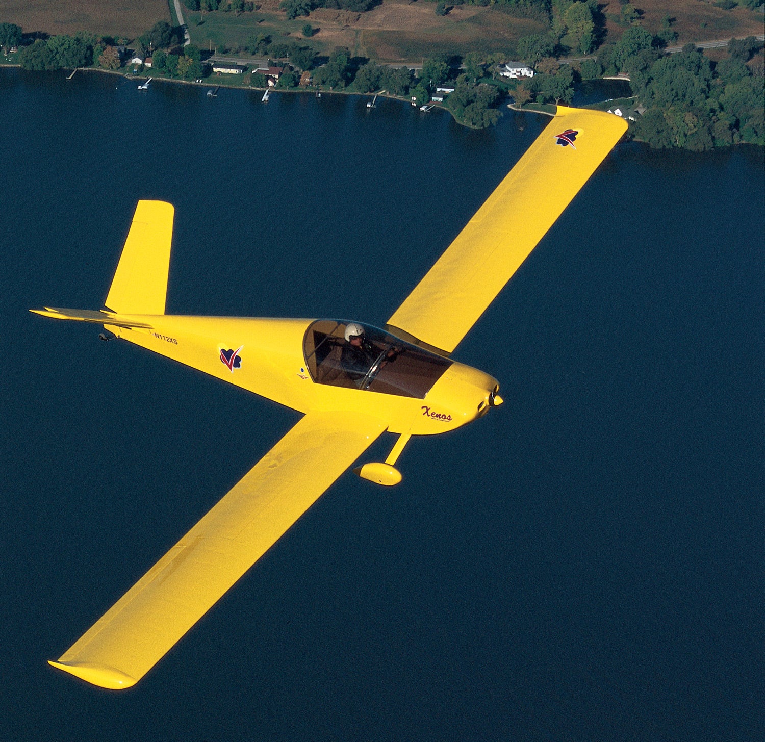

xenos cov01I have often written that before you start building an airplane, you should set your requirements: What is the airplane designed to do? What design satisfies that goal? How does it need to be equipped to perform that mission? Once you have decided on a project for a specific mission, it is important to keep those initial requirements in mind every step of the way with every decision you make. Ignoring this process is a way to set yourself up for a project that never gets finished because of mission and cost creep—it has demonstrably kept many homebuilders from achieving the goal of flight.
So it might seem odd that my wife and I decided on a very radical “left turn” with our current project. You see, we have had a Xenos motorglider project with an AeroVee powerplant gestating in the shop now for about six or seven years. I don’t usually let projects stretch out like that, but the truth is that we have other planes to fly and maintain, and the Xenos was chosen to basically give us something in the shop to work on when we have time. And to generate article ideas for this magazine and the various websites to which we contribute. In other words, we didn’t really have a schedule or a plan for when it needed to be completed. All we wanted was a recreational motorglider to fly when we weren’t planning to go anywhere—and we didn’t want to invest a great deal of money in it.

The original Xenos and Gabe DeVault’s eXenos formed the inspiration for this project: another electric-motor-powered Xenos motorglider.
