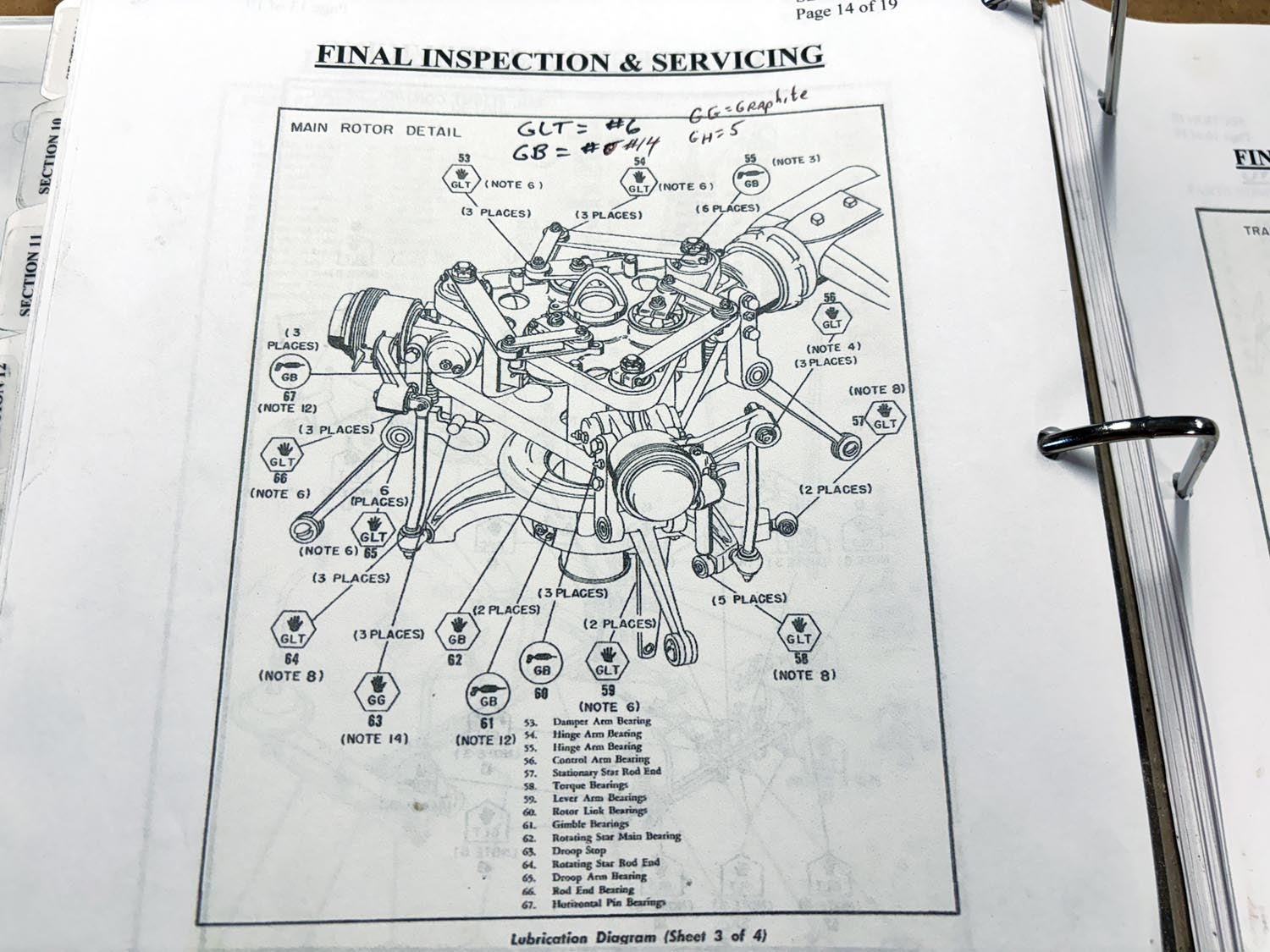

The rotor head alone has over 40 distinct lubrication points (left). There are lots of constantly moving parts here, and proper lubrication is critical. A little OCD in your personality is helpful when owning a helicopter! The tail rotor (right) has its own transmission, connected to the engine via a driveshaft and intermediate transmission. The tail rotor has approximately eight different lubrication points, requiring four different kinds of grease and oil.

Lubrication Diagram
The maintenance manual provided for the Hummingbird is really good. It clearly shows the lubrication points, lubrication type and required intervals.
While I try to not think about all the moving parts between the engine and the rotors while flying, it clearly does take more attention to maintenance. The maintenance manual is very good, clearly explaining the time interval requirements and types of lubricants for the various parts. Personally, I think it is good to have a little OCD when it comes to owning and flying a helicopter. The maintenance takes time, and a good part of it is a greasy, dirty job. I’m lucky that my hangar is at home. An hour or two every few days is all it takes to keep the Hummingbird clean and well lubricated. Of course, I’m a little OCD about the time intervals and perform all of them at much smaller intervals than recommended. It gives me peace of mind, and with it being a new aircraft I can get an early read on wear items.
