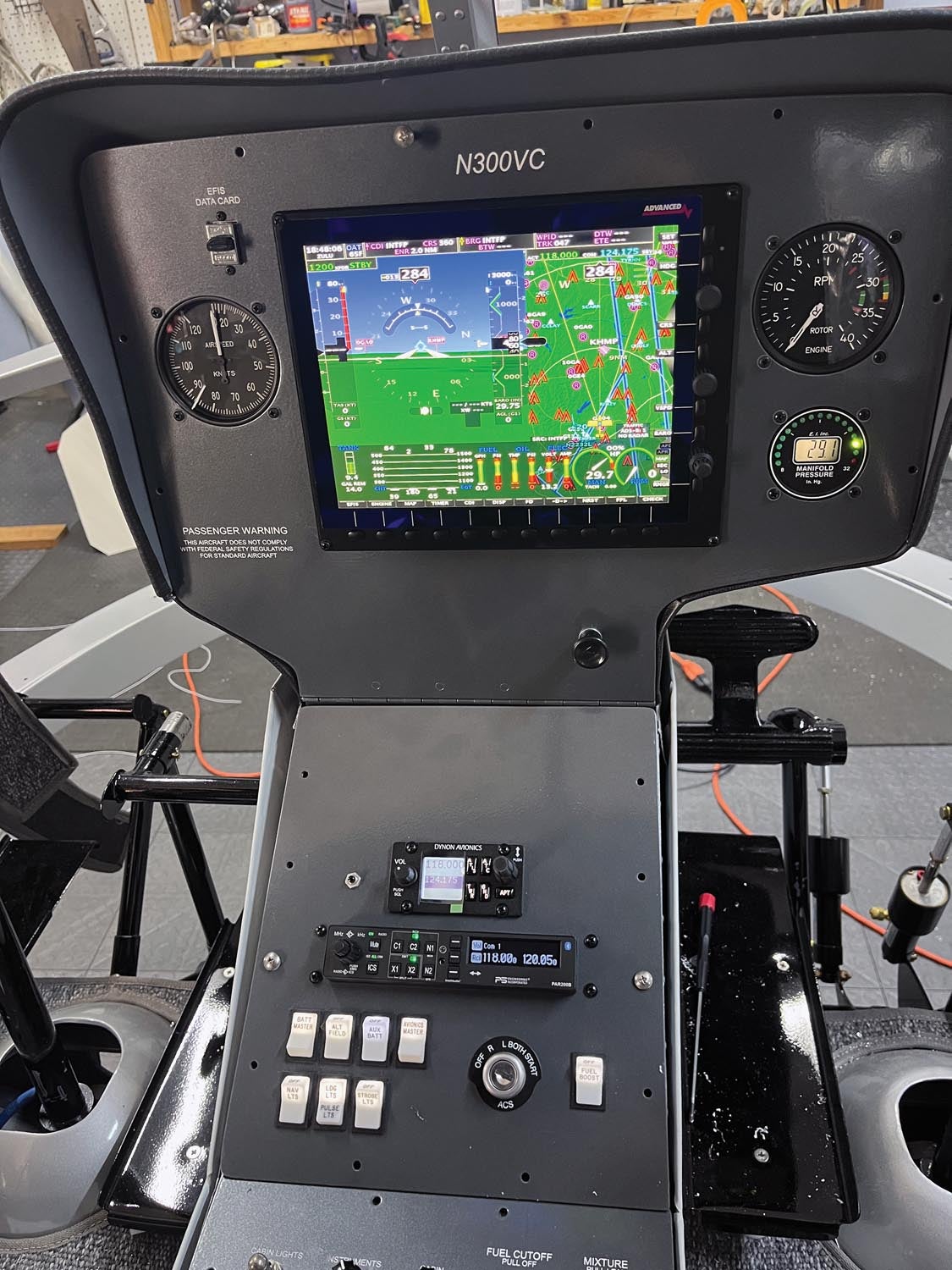

The other good thing is that Advanced Flight Systems delivered on the promise to code some software to display the transmission oil pressure on the EFIS. I really didn’t want an analog oil pressure gauge on the panel.
I also managed to get all the electrical completed. The Advanced Control Module and associated components were all installed, and then the instrument panels were sent off to AFS for powder coating and labeling. They came back looking beautiful, were accompanied with the long-awaited AF-6600 EFIS and now are completely installed. Everything powered up without any smoke, and I even have traffic displaying on the screen in the hangar! Seeing everything working was quite motivational, especially since I ran many individual wires, such as the intercom and engine sensors. I must admit I did install the wrong wire from the EMS to the manifold pressure sensor but realized that as soon as I powered it up, as there was no value displayed. It was a quick fix, and I sure felt relieved.

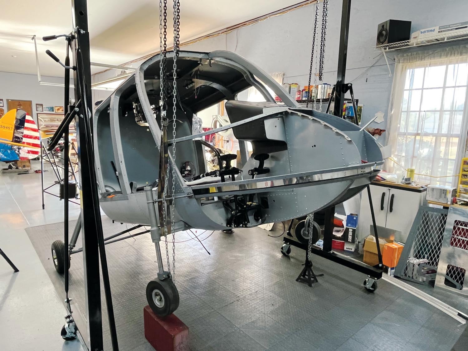

There are a lot of cables routed on the exterior bottom of the cabin, such as brake lines, control cables, throttle/mixture, etc. Again, the gantry crane I’ve mentioned in earlier columns came in very handy. The cabin sits pretty low to the ground, so lying underneath it was not very comfortable. Raising it using the gantry crane made the work very easy, including installing the chin windows, parking brake and landing lights. Yes, I added a parking brake, which I intend to use for rotor start-up and shutdown. Since this helicopter is on wheels, not skids, the initial torque at rotor engagement will cause the nose to turn without using the brakes. As a funny side note, I don’t think I ever broke the habit of stepping on the pedals in the Hughes 269 helicopter whenever I started the engine, even though it was on skids and had no brakes. Some habits die hard from flying fixed-wing aircraft. Now, it will seem natural to check the brakes.

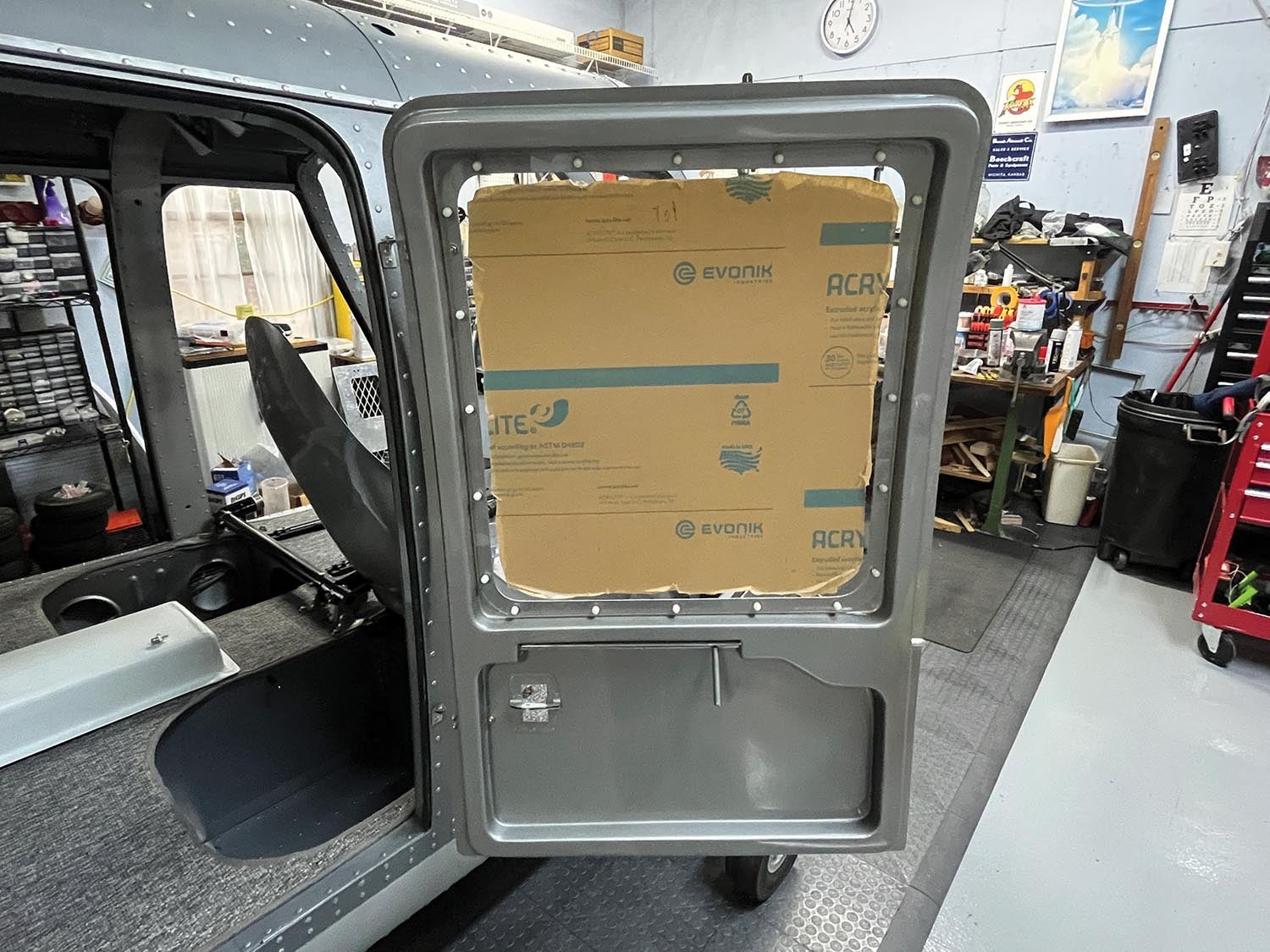

I painted the interior of the doors first, so that I could get the plexiglass installed. When installing plexiglass, don’t forget to use a plexiglass drill bit, and drill the hole larger than the diameter of the fastener so that there is room for expansion. Otherwise, there’s a high probability that it will crack.

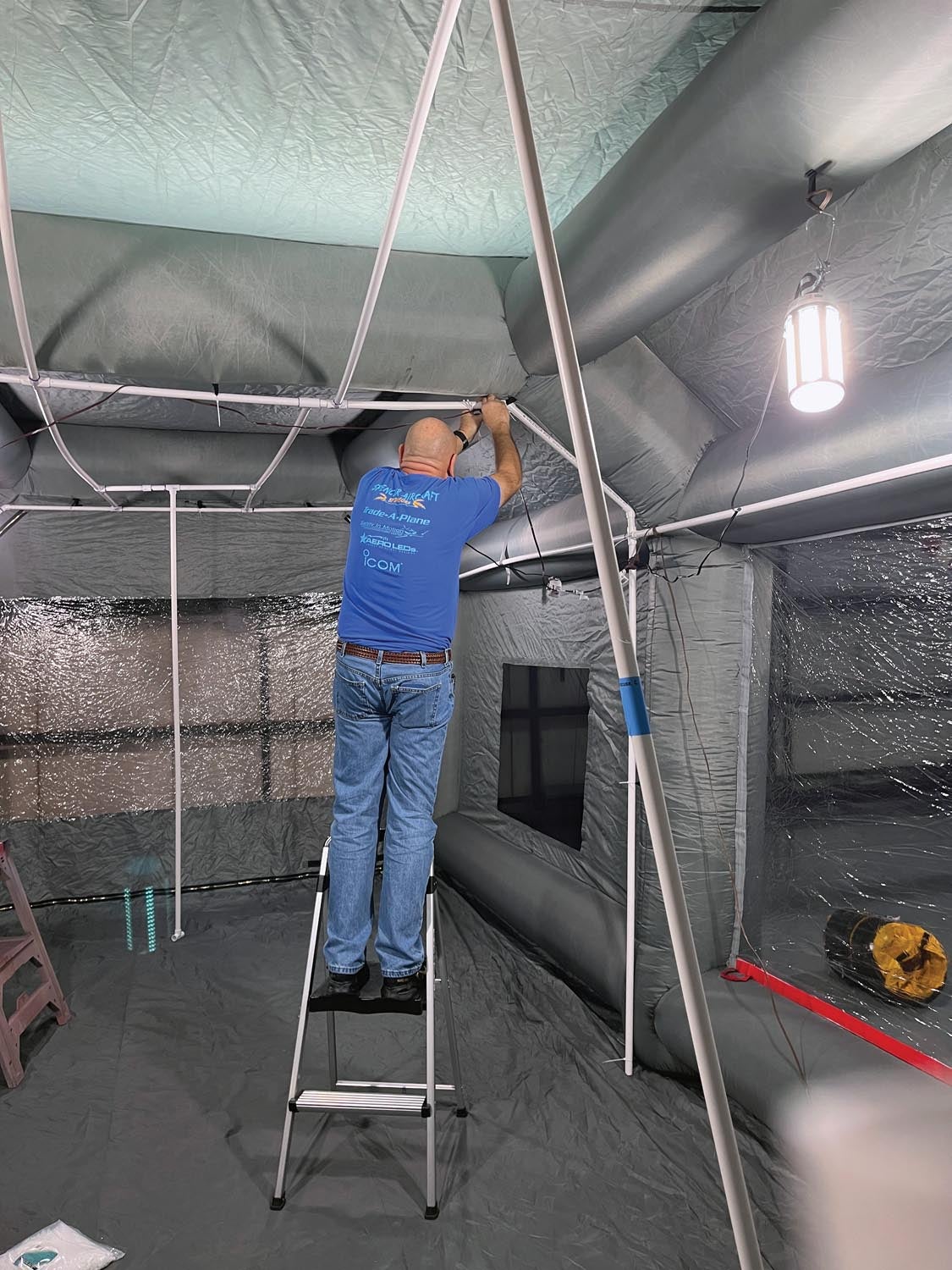

Then a lightbulb went off, or on, as I should say. I thought we had lit up the paint booth well and had even added some extra lights outside the booth shining into the windows. But the paint was black, and it was hard to see. Perhaps it’s my old eyes, and I’ll use that as an excuse, but I decided to try something different. The bottom of the cabin was going to be quite hard to paint, and I was wrestling with how to do it. The gantry crane process I had been using to work underneath it was not going to work in the paint booth, so I decided I needed to raise it another way. Brad Clark mentioned that pumping the struts up all the way would help, and I decided that jacking it just a little higher would even be better. I figured out a way to do that, but it still left me with the hard-to-see black paint.
I needed more light and it had to be underneath the helicopter. I don’t know when it hit me, but the brightest light I know is the sun. So, one evening when the weather conditions were perfect—no wind, low humidity, no bugs, etc.—we placed a big tarp on the taxiway, and as the sun got lower on the horizon it lit up the bottom of the cabin beautifully. I managed to get a gorgeous paint job on the bottom that exceed my expectations. The trick was the light, so we found the brightest LED cone lights we could find for the booth, and it made a huge difference.
I know you are wondering, and yes, I sanded down the tail cone and repainted it in the booth with all the extra lighting. It’s gorgeous now, too.
