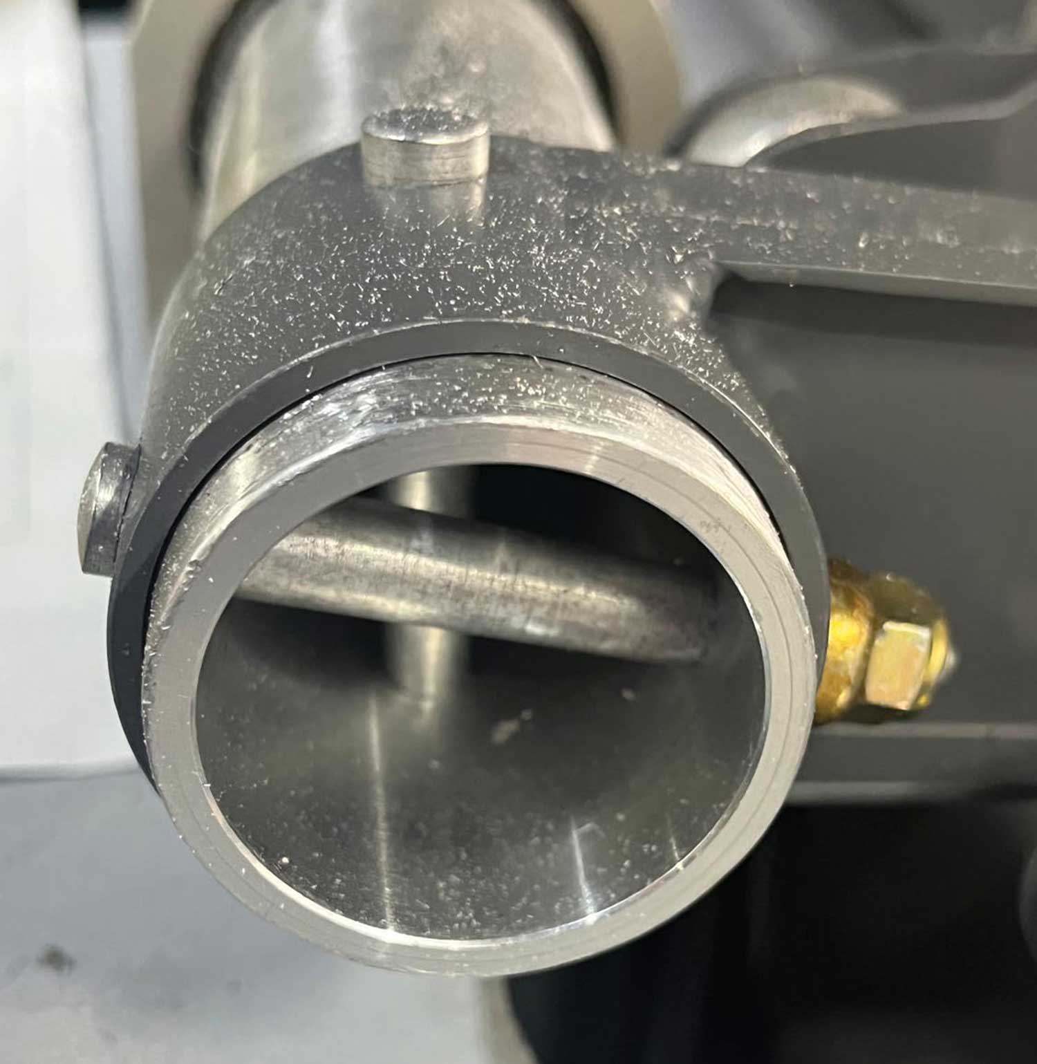

view of tapered pin
Each of the brackets is held in place with two tapered pins.

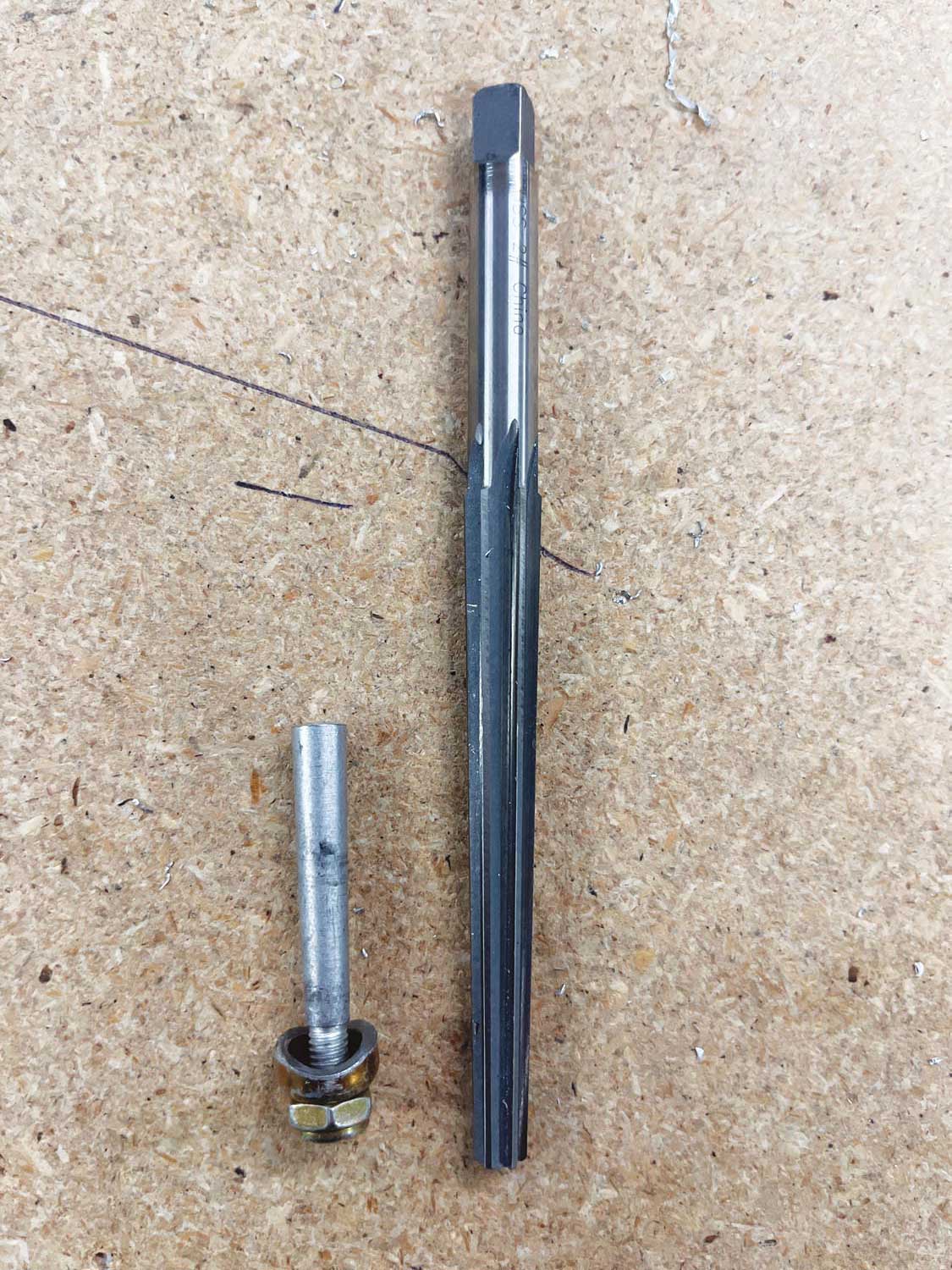

Tapered pin and reamer
Installation of tapered pins required buying a Brown & Sharpe #2 reamer. The trick is to drill slowly and use Boelube, and to not drill too deeply.

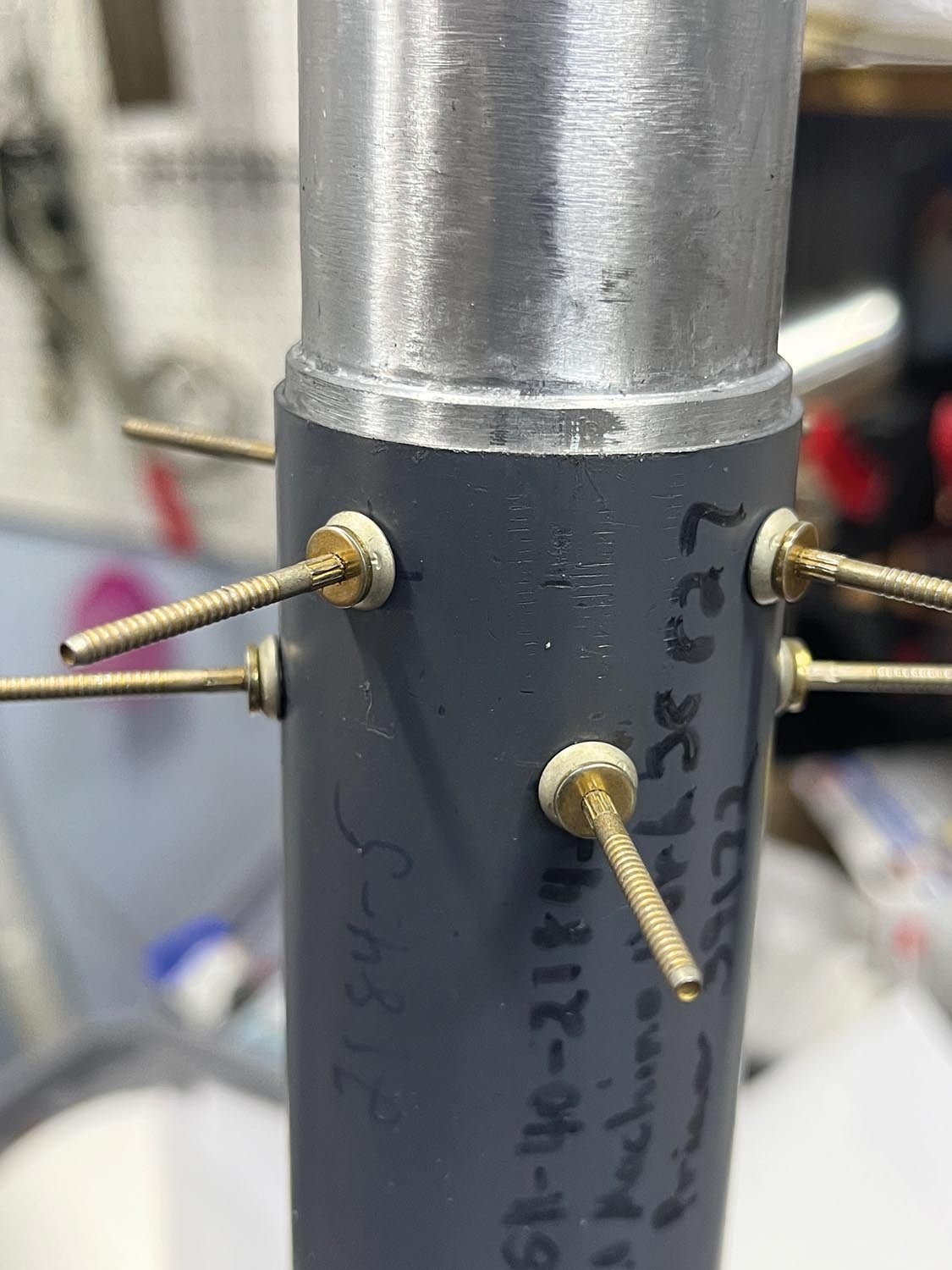

There are three long torque tubes mounted in the aft cabin that are a part of the pitch, roll and azimuth controls. It took quite a while to get all of the machined parts fitting properly with each other, verifying the correct lengths, and then adding the control arms to them with the proper angles. Each of the control arms is mounted with tapered pins in order to promote a tight fit without any sloppiness. Every time I think I have all of the tools I need, I find a step requiring another particular tool. In this case, I needed a Brown & Sharpe taper pin reamer, of which I have never used on 11 prior aircraft.
Tube cleaning
Each of the control torque tubes had machined aluminum fittings that needed to be riveted inside the tubes. Unfortunately, epoxy primer from the factory got inside the tubes, which took some time to clean out before the pieces would fit together.
The torque tubes required the end fittings to be riveted on with AN470 rivets. I would love to see the rivet tool they had at the factory for that step, as there was no way I could figure out how to get inside the tube to set the rivets. In the end, with consultation from Brad at Vertical Aviation, it was decided that CherryMAX rivets were an approved substitute.
Cherry max on torque tubes
CherryMAX rivets were used in place of AN470 rivets due to the inability to buck them without a very special bucking bar.

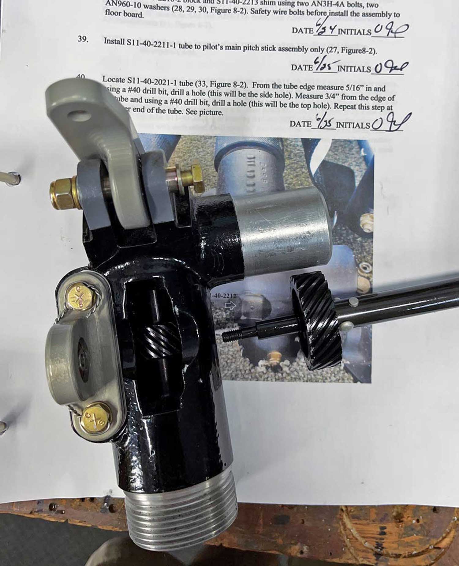

To date, it has been a matter of getting all the control system infrastructure installed. The actual rigging will come after final assembly. Many of the components require some delicate assembly, such as the collective control, as it contains the throttle linkage as well as a shaft connection between the pilot’s and copilot’s respective collectives. It required shimming the gears in the drive shafts to ensure a nice smooth motion between them. Paying attention to detail now will be rewarded with the ability to make smooth minor throttle adjustments, especially while hovering. Just like my Hughes 269C, the Hummingbird does not have an autothrottle, such as on the Robinsons. It has a “correlator,” which somewhat adjusts the throttle as collective is increased or decreased, but otherwise it takes a constant twisting of the throttle to keep the engine rpm in range.
collective underside
The collective is an important part of the control system. It looks simple, but there are moving parts and gears that are hidden and must be properly installed and shimmed in order for it to work smoothly. Attention to detail here will pay off with smooth throttle movements.

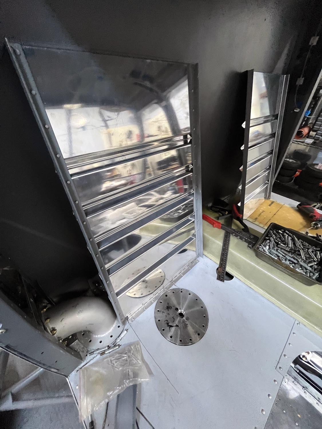

To improve the ergonomics of the rear seats in the Hummingbird, I built two seatbacks à la RV-style.
Another aspect of the interior that’s been on my mind for a while has to do with the rear seats. Quite honestly, the ergonomics seemed like an afterthought, with the seatbacks basically straight up and down against the rear bulkhead. It didn’t seem comfortable to me, and we know passenger comfort can make all the difference when it comes to flying. Then, as I was packing all of the camping gear for OSH into the RV-10, I happened to remove the rear seatbacks, and the light bulb went off! The rear seats of the RV10 are very comfortable, so why not steal a good idea? Sure enough, I built two rear seatbacks à la RV-style (yes, they are pretty much the same seatback in all of the RV models), and I am very happy with the result, especially since I was able to ask Oregon Aero to just build me two RV-10-style rear seat sets. Problem solved!
