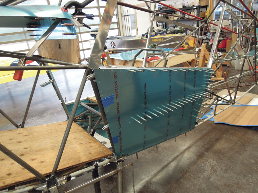

With the floors in, I tackled the skins between the firewall and the door/window. The cross-section of a Bearhawk fuselage is not the simple rectangle created by the steel tube structure. In between the doorpost and the firewall, the shape of the fuselage varies continuously. There are a few dimensions on the plans to get you started, but it’s best to check the actual airplane before you commit to making parts. A few string lines, stretched between the fore and aft terminations—that would be the curved shape of the firewall at the front and the shallow vertical triangle of bent aluminum fastened to the rear doorpost—simulated the surface of the skin and defined the shape of the forward doorpost bulkheads. The idea is to establish the line of the side skins and build the bulkheads to fit, rather than the other way around. Once I knew what was needed, I bent the horizontal door and windowsills with a brake and used particleboard form blocks to form the curved doorpost bulkheads.
Because the side skins overlap the belly skins, I needed to make the belly skins first. This wasn’t difficult, as the skins are simple single-curvature rectangles, but the job did entail a lot of lying on my back, clamping, taping, and readjusting before I could finally drill the holes in the fuselage bulkheads and match drill the nutplates in the tabs. We used screws to attach the belly skins, rather than rivets, thinking that if we ever need to get to the control or fuel systems, it would be easier to come in from the bottom than to remove the seats and floorboards.

The best way to determine the shape of the skin was to use patterns made of stiff paper. Carton cardboard was too thick and regular paper too thin…something the thickness of a manila folder was just right. We found our material at the local feed store where it was used to separate loads on forklift pallets (we were soon on first-name basis with the warehouse guys because we never seemed to have enough paper and made several trips to scrounge up more). After several iterations and lots of tape and scissors work, we had our patterns. The Beverly shear quickly transformed a couple of large sheets of 2024-T3 aluminum into side skins.
After the side skins were drilled and Clecoed on, the last task was to make the upper skin underneath the windshield. This has to fit around a couple of structural steel diagonals. Instead of cutting long slots, we cut a rectangle in the rear of the skin and filled the gap with a removable piece that runs from the instrument panel to the steel tubes. We made a rough plywood model of the panel to support the aft edge of this skin, splicing in bits to fit the gaps where the panel didn’t fit the natural arc of the skin. The real panel would be cut to fit the arc.
