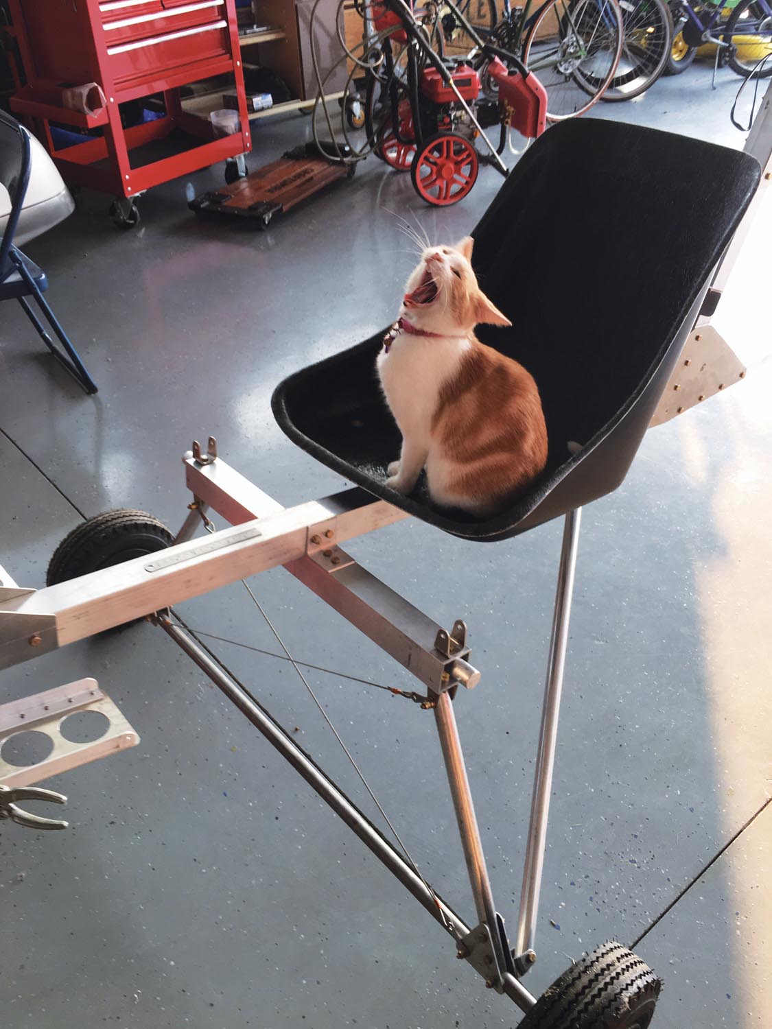

affordaplane catonseat
The fiberglass seat mounts to the fuselage behind the landing gear.
The same issue is found with substituting rivets. While most builders can understand this and respect the decision to never weld or rivet, others are vocal about not agreeing and telling the community that they know better. My concern about this forum is that future new builders will read these comments made by “professional” welders and believe that it is OK to skip the bolts. It is certainly OK to experiment with your own butt on the line, but giving life to the idea that this might work well for others is not something I want my project to be associated with! This is the nature of public forums. But when it comes to building airplanes, we should take special effort to guard the facts that ensure safety. Remember—ultralights do not get inspected by the FAA. This places a huge responsibility on the builder.
