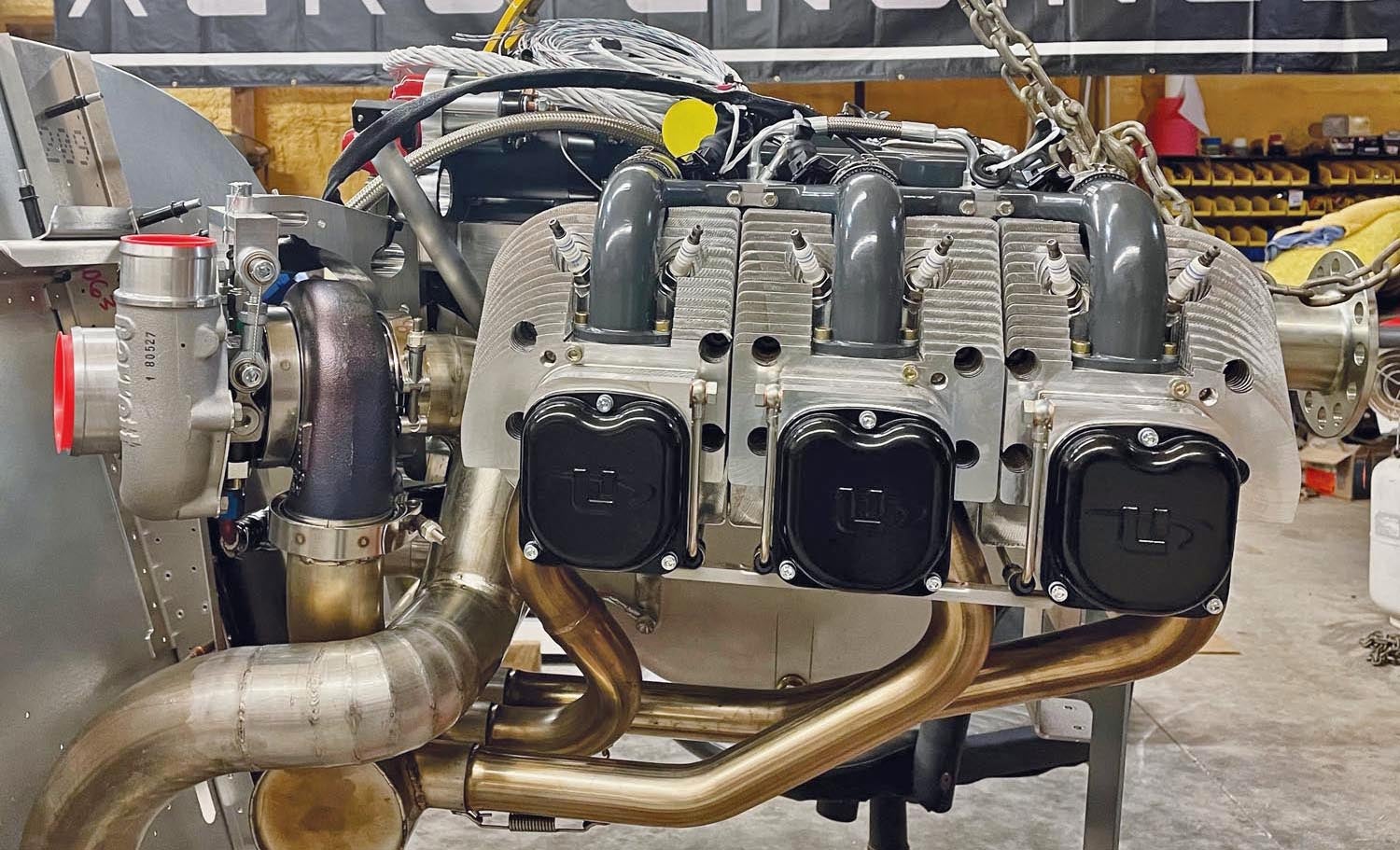

The 2023 airshow season has begun and life has been busy since the last article, but there has been one particularly big moment for the 750SDX build. The week before Sun ’n Fun, I took delivery of a nicely packed crate full of components intended to turn the big fan up front and move lots and lots of air. Yes, the ULPower 520T engine has arrived!

A mysterious crate arrives at Humberd Farms with a suspected motor inside (left). A very nicely packed crate with the 520T engine (right) and all the components needed to wire and plumb the six-cylinder engine. Let the work begin!
Now that I have the engine uncrated and hanging on a hoist in front of the firewall, I can really begin to visualize the possibilities and make calculations on how to proceed. One of the biggest choices I am having to make is whether or not to go with a totally custom firewall-forward build. I got into a debate with myself because there is now an engine mount available for this engine/airframe combination that should work very well. That said, I still find myself wanting to take this project one step further and build a shorter engine mount in order to get the center of gravity farther back to help with STOL missions and performance.

Freshly unwrapped in the packing crate (left) to hung on the engine hoist (right), the ULPower 520T turbo engine is about to join the fun. There are off-the-shelf engine mounts for this engine, but I’m going to try something different.

In spite of that, and against common wisdom that says “just buy the components, bolt them together, and fly,” I am almost determined at this point to build my own mount and do some more custom work around joining the airframe and engine. It will be a lot of extra work, but I think it will ultimately be a noticeable gain in performance for my very specific STOL missions. While, to be totally honest, the modifications that I am planning to undertake will most likely never be worth the effort for the average builder, sometimes I like a challenge and I can be a bit of a perfectionist when it comes to certain things.
In reality, most of the extra time so far has been spent sitting in my shop chair looking everything over and contemplating how to proceed. I have run tons and tons of numbers through my weight and balance spreadsheet and already spent countless hours thinking about this during my off hours, while driving and while I’m awake at night. The performance gains might be minimal but when you look at all the internal metal pieces where I have shaped, trimmed and cut a few grams here and there, you begin to realize that I’m not trying to build “just another SD.” Sometimes these minimal benefits can win competitions or narrowly get you out of a potentially dangerous situation.

My goal is to build an engine mount that is more than 5 inches shorter than the currently available mount. I’m pretty sure this is possible, but it is going to take several modifications around the mount area of the engine bay to make it work. Things are also going to get tricky with the amount of available space left for everything else, like the intake, intercooler, exhaust, etc. Space underneath the cowl became very tight with the Super701 as well, but it has worked as flawlessly as anyone could ever hope for, so I am optimistic. I have a basic plan, several mount pins from ULPower, an engine backplate to use as a jig and am about ready to start cutting some chrome-moly tubing.
