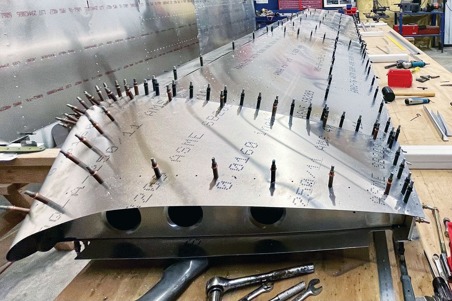

Wing Work
I am getting very close to permanently buttoning up the wings. The fuel system in an airplane is something that needs a great deal of consideration because it has to work, period. I used rubber hoses to plumb the fuel system in the Super701, but am planning to build aluminum fuel lines to connect the wing tanks in the 750SD build.
If done correctly, the aluminum lines should require less maintenance over the life of the airplane whereas hoses would need to be inspected and replaced periodically. The aluminum lines also have a mostly uniform inside diameter even through the fittings. Since sometimes fittings for a rubber hose can have a much smaller diameter port inside the barbed nipple, I am hoping using the aluminum lines will optimize fuel flow in the relatively small-diameter tubes by eliminating that potential bottleneck. In addition, the aluminum lines should have the benefit of being slightly lighter.
I will be running a header tank in the rear fuselage, just like I have done before. All the venting in the tanks will be handled through the vented fuel caps, leaving only one wing tank outlet for the main fuel supply line to the header tank and one small drain/check valve in the bottom of the wing. Although not having an extra vent line running from the header tank back to the wing tank is probably a hot topic, this setup has worked without a glitch in my Super701 for 700 hours and it really helps to keep things simple by eliminating the extra return lines and several connections.
The only other thing required before final assembly of the wings is installing the wiring for navigation, strobe and landing lights. This is a relatively easy task but it is taking some careful planning to install everything correctly through the spars and ribs and to get it all secured properly across the length of the wing. I will be using AeroLEDs lighting, just as I did on the Super701. In my experience, it is an excellent lightweight, bright and effective lighting system that requires less power consumption than most of the older bulbs.
I catch myself thinking a lot about how to make the wiring and plumbing connections as clean as possible, especially where the wings join the fuselage. I have several ideas in mind, but integrating an idea into a finished product can sometimes be a challenge. While I tend to like challenges, I also want to get this thing in the air—and challenges always cost time.
