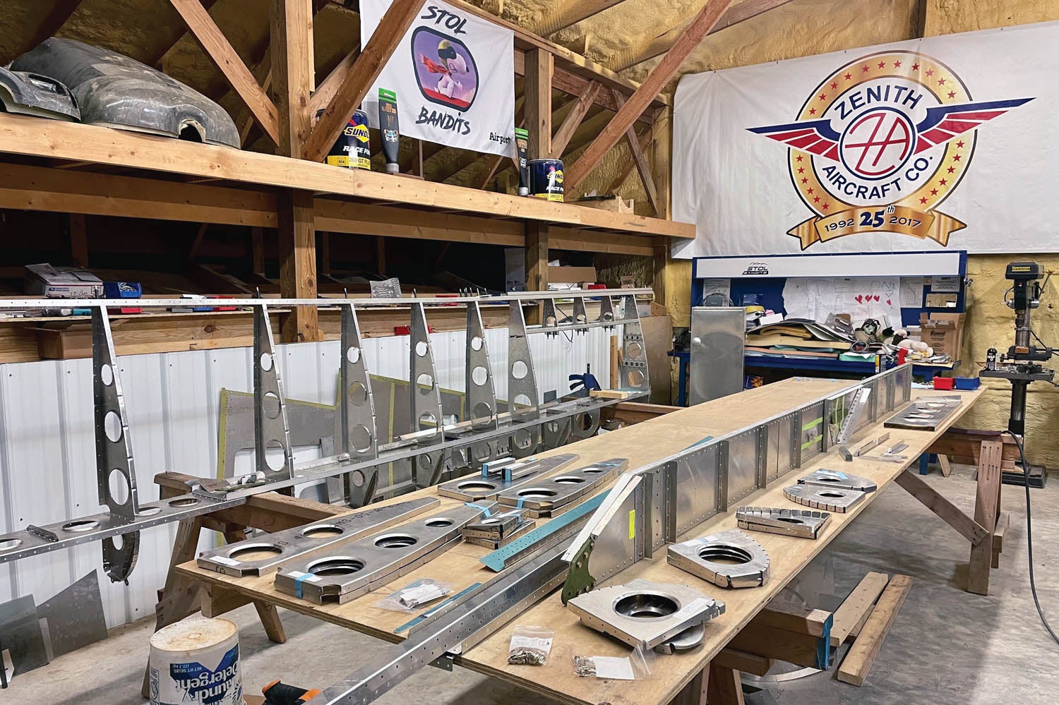

SD750 Xtreme 01 e1676488376364
Both wing skeletons are mocked up and on the workbench, which is another sign of progress.

I also have the wings in process on the workbench. I have decided to build both wings at the same time. As I build one wing skeleton, I switch over and also do the other skeleton while that part of the build is fresh in my mind. A lot of time is (still) going to deburring, smoothing edges and rounding corners of various pieces. In addition, I’m currently working on logistics and planning for the fuel system, wiring and other things inside the wings. Long story short, I hope to have the wings mostly complete and ready to hang on the fuselage soon.
