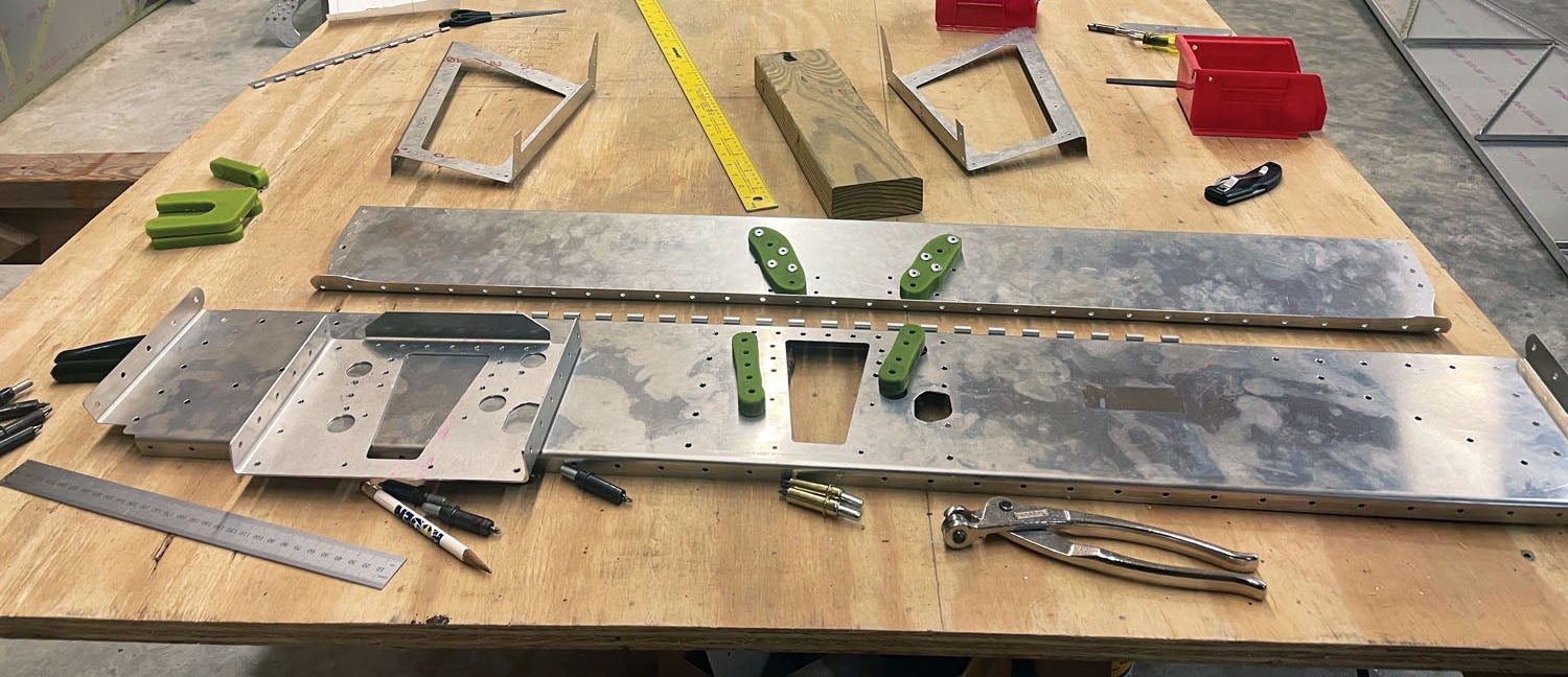

The first component coming together for final assembly is the bottom of the rear fuselage. The Zenith is a simple sheet metal design intended to be easy to build. Unmodified, that is!

Realistically, the mockup process probably prolongs the build. In the early stages, I do not focus on any one component. Instead, I am partially mocking up several pieces and implementing all my customizations in my head before the airplane actually starts coming together.
I don’t really know how to describe when it’s time to move on from the mockup stage. For me, it may be when the holes do not need to be deburred because the edges have been worn smooth from taking the Clecoes in and out so many times. For what it’s worth, the plans and build guides for the 750 are amazingly straightforward and easy to follow. Almost all of my extra mockups are due to personal customizations and trying different concepts.

The rear fuselage is currently completely disassembled (again) and I’m now in the process of cleaning and dressing it up as it is slowly going back together. At this stage, I am paying extra close attention to details since I’m planning for this build to be more show-worthy than my Super701. I painted the first few pieces yesterday and am applying some carbon fiber vinyl as I put the rear fuselage back together—hopefully for the final time this round.
