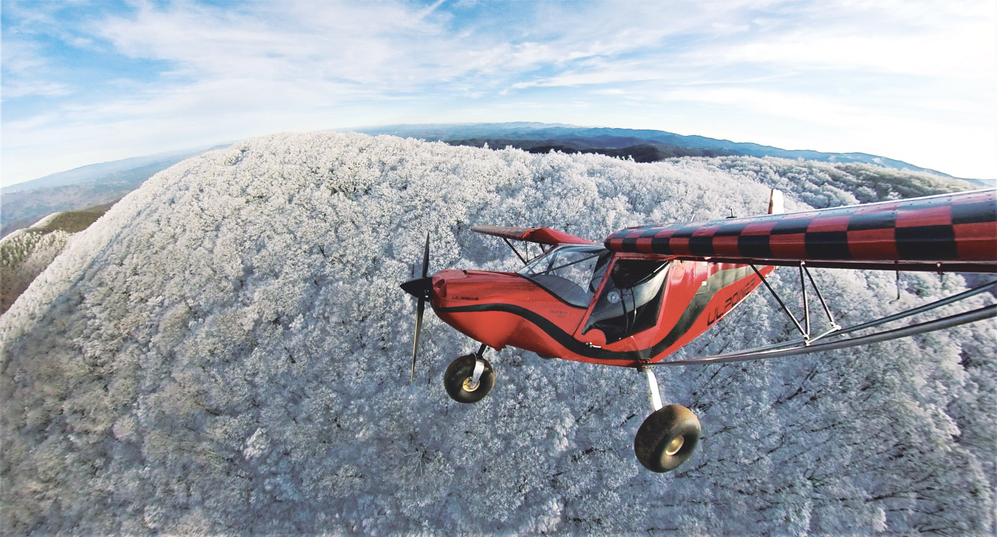

zenith 750xd part 13 02
Humberd’s Super701 demonstrating frigid winter flying and why sealing the cabin against unwanted breezes is important.

My Super701 is extremely well insulated/sealed and I like to fly year-round, so it is not uncommon for me to push out the plane and fly during the cold winter months around our Appalachian Mountains. I had to add extra latches to the Super701 doors to help make them airtight so I could withstand temps down to 0° F. This had to be done because the 701 doors close against the outside of the cabin frame, whereas the 750 series doors close into the cabin’s doorframes against an internal door trim that also holds a rubber trim piece (much like an automotive door setup).
The one area that I noticed where the Super701 is not airtight is along the piano hinges. I have mostly sealed those using foam rubber, but with the 750 SDX, I wanted a cleaner and tighter fit to begin with. So the 750 SDX door hinges are being fitted closed against each other when the door is shut, which almost completely eliminates them visibly and any gap they would create. I should also mention that I am using the extruded piano hinges for the doors. This started because I had enough extruded hinge left over from previous projects to complete one door.
