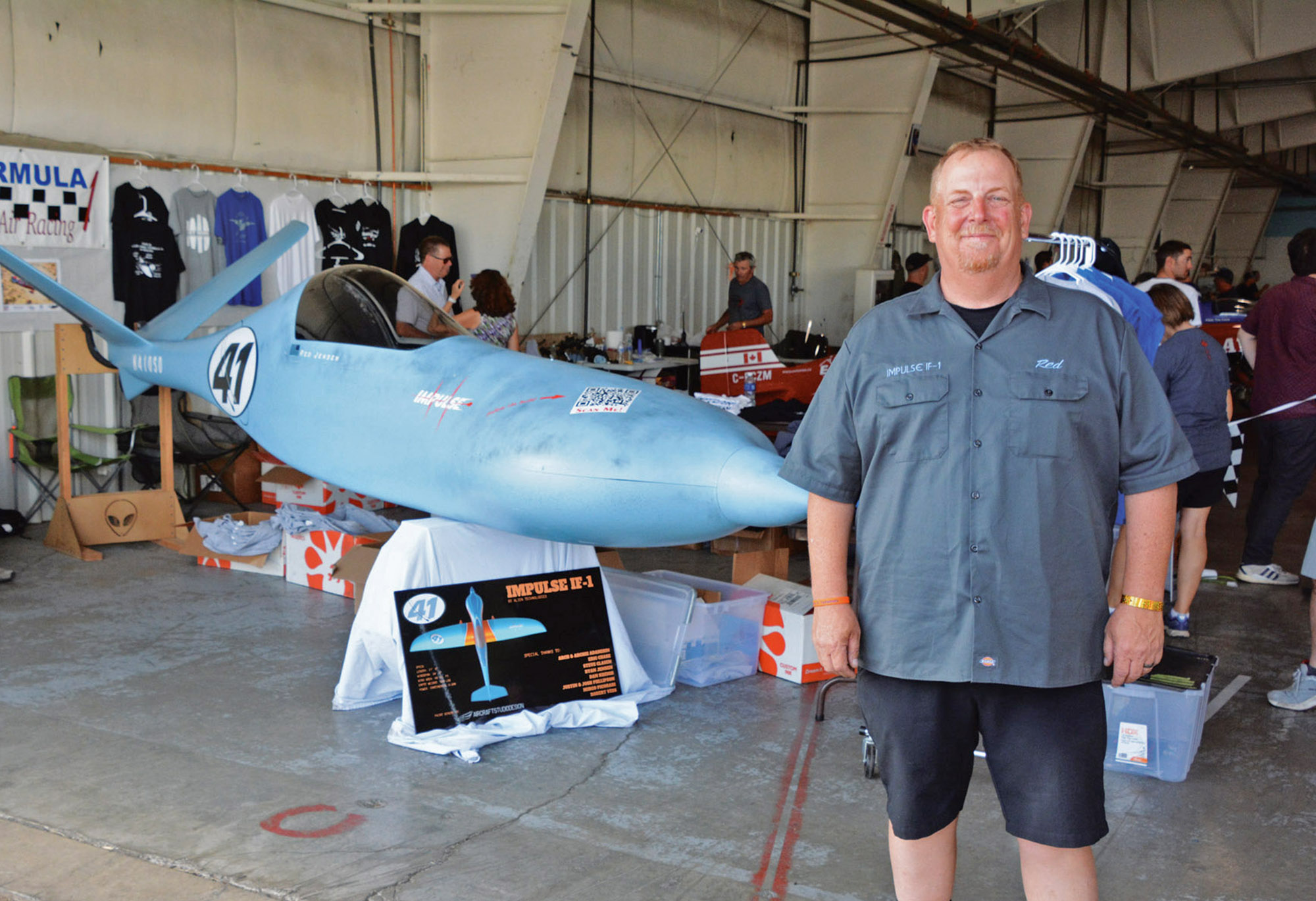

Red Jensen and budding new friend. Knowing that building a one-off single-seater is “nuts” hasn’t stopped Red from really trying. The fuselage seen here is part of a rigid, 15 G airframe yet weighs just 68 pounds, for example.

Red Jensen’s one-off F1 racer Impulse was started perhaps five years before the loss of Reno and if anything has gained momentum in the last year. The carbon fuselage is finished and was shown at the last Reno looking like a cross between a V-tailed sailplane and a Baka bomb; with a 22-inch-wide cockpit it will be worn like a second skin. Fittingly, a set of wing skins just came out of the molds one of Red’s many friends routed out for him, and with progress now tangible Red says the urge to build is only gaining strength. As always, success breeds success.
The wing structure is next, with Red having just purchased an immense 500-foot roll of 0.125-inch pre-cured carbon fiber pultrusion. That explains what looks like one of the telephone company’s giant wooden spools next to the house. The pultrusion will eventually form the spar cap on the 15 G rated wing.
