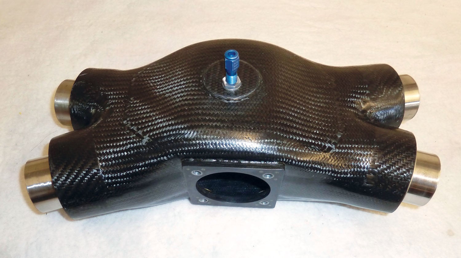

The first full-sized plenum part allowing individually adjustable runner lengths.

As it turned out, this plenum is the most difficult project I’ve ever attempted in composite. I’m certain that composite builders are scratching their heads and wondering, What’s so difficult about building a plenum? For the uninitiated, let me explain:
Composite work is a discipline that requires more planning and time organizational skills than most metal-plane builders are used to. A metal-plane guy just goes out to the shop and drills something, deburrs it and then drives a rivet into it. Well it’s actually a bit more difficult than that.

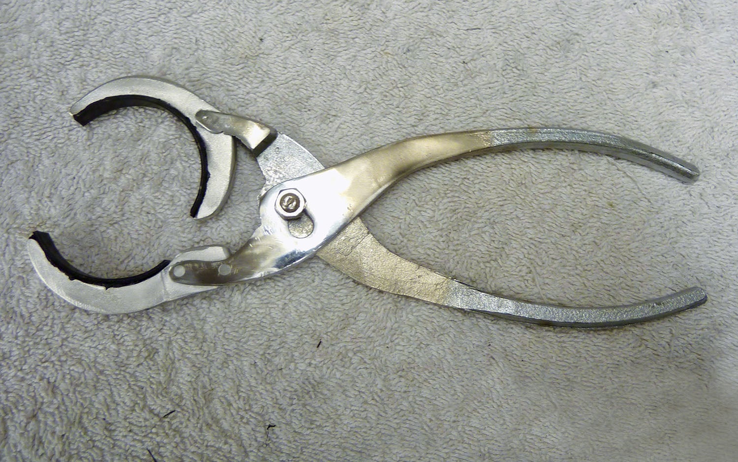

A simple type of homemade oil filter wrench was fabricated from old pliers to allow the runner to be adjusted.

A simple type of homemade oil filter wrench was fabricated from old pliers to allow the runner to be adjusted. Between the carbon fiber plenum and runner, there is about 3/8 inch of the exposed portion of the adjustable velocity stack. O-ring seals are on both sides of the exposed portion. The load from the two O-rings on the velocity stack makes it difficult to turn and holds its position during engine operation. Each revolution of the velocity stack changes the runner length 0.050 inch.

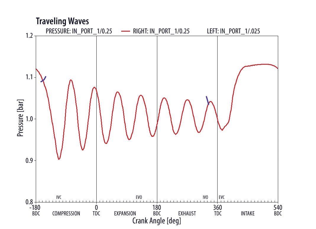

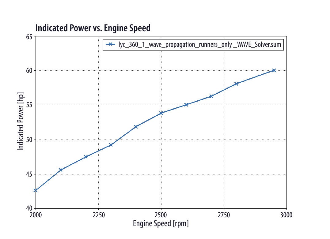

Figure 3: A single Lycoming cylinder under standard conditions with the optimum runner length. The most effective rpm settings for power or volumetric efficiency are around 2100, 2400 and 2900 rpm.
I plugged the engine specifications for my Lycoming IO-360 into Ricardo WAVE, then calibrated the program against real performance numbers from Ly-Con Engine Manufacturing and my own numbers from Savvy Analysis until the agreement was within 0.006%. All of the flow elements in the program are adjustable so you can change runner lengths, diameters, taper angles, bend angles, fluid state pressure and temperatures (or as we would say, IAT and MAP), surface conditions, air fuel ratio and rpm.
From running multiple iterations and cases, you can determine the runner length that produces maximum power. It turned out that with our low-rpm engines, the maximum pressure needs to occur at 44.4 degrees BIVC (before intake valve close). But this program does even more than that by calculating the maximum horsepower produced when considering maximum pressure in the intake runner BIVC while including the maximum pressure at the back of the valve at IVO. Then you can run cases to determine when the N number comes back at a desirable position for other rpm.
tunable induction plenum 13
Figure 4: Optimum position for wave peaking at 2100 rpm, showing 7N.
Figure 3 is a graph for a Lycoming single cylinder under “standard conditions” with the optimum runner length. You can see that the proper wave timing comes back into phase at three different rpm positions. These would be the most effective rpm for power or VE (volumetric efficiency) peaking at around 2100, 2400 and 2900 rpm.

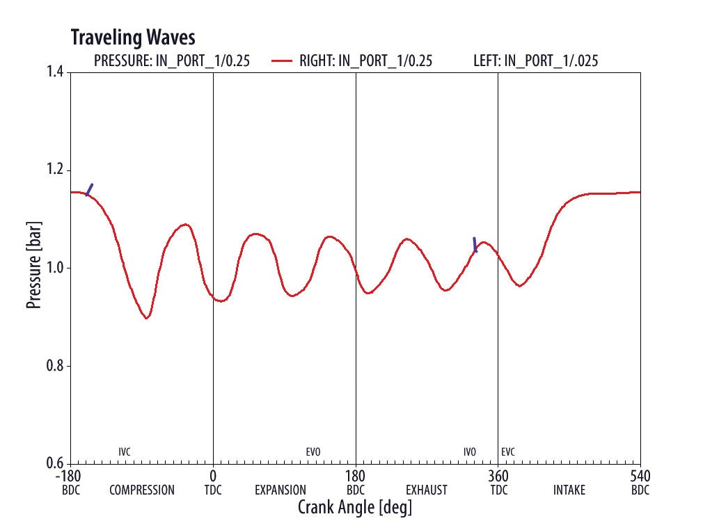

The traveling wave diagrams (Figures 4, 5 and 6) represent the optimum positions for wave peaking at each rpm, which are the wave pressures manufactured by Ricardo WAVE at the position of the valve seat. The blue marks indicate pressure at 44.4° BIVC and IVO.
tunable induction plenum 14

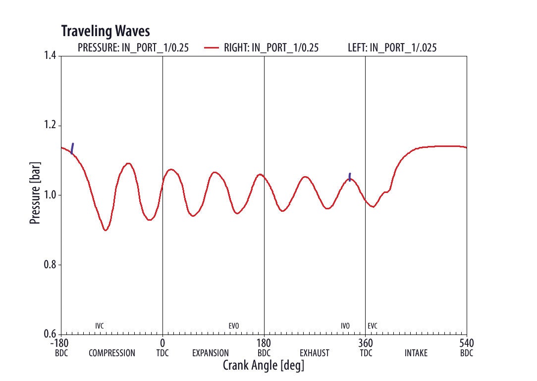

Figure 5: Traveling wave at 2400 rpm, showing 6N.
The graphs also show that the N number increases with lower rpm due to the increased time between intake valve events. At 2900 rpm the engine is at the third N between IVO to IVC, which has less attenuation of the wave energy, so there is higher pressure for a more optimum cylinder fill. It appears the tuned plenum with optimum-length runner can increase the power and VE by approximately 7%. That would increase the VE of my engine, which is about 83.7%, to around 91%.
