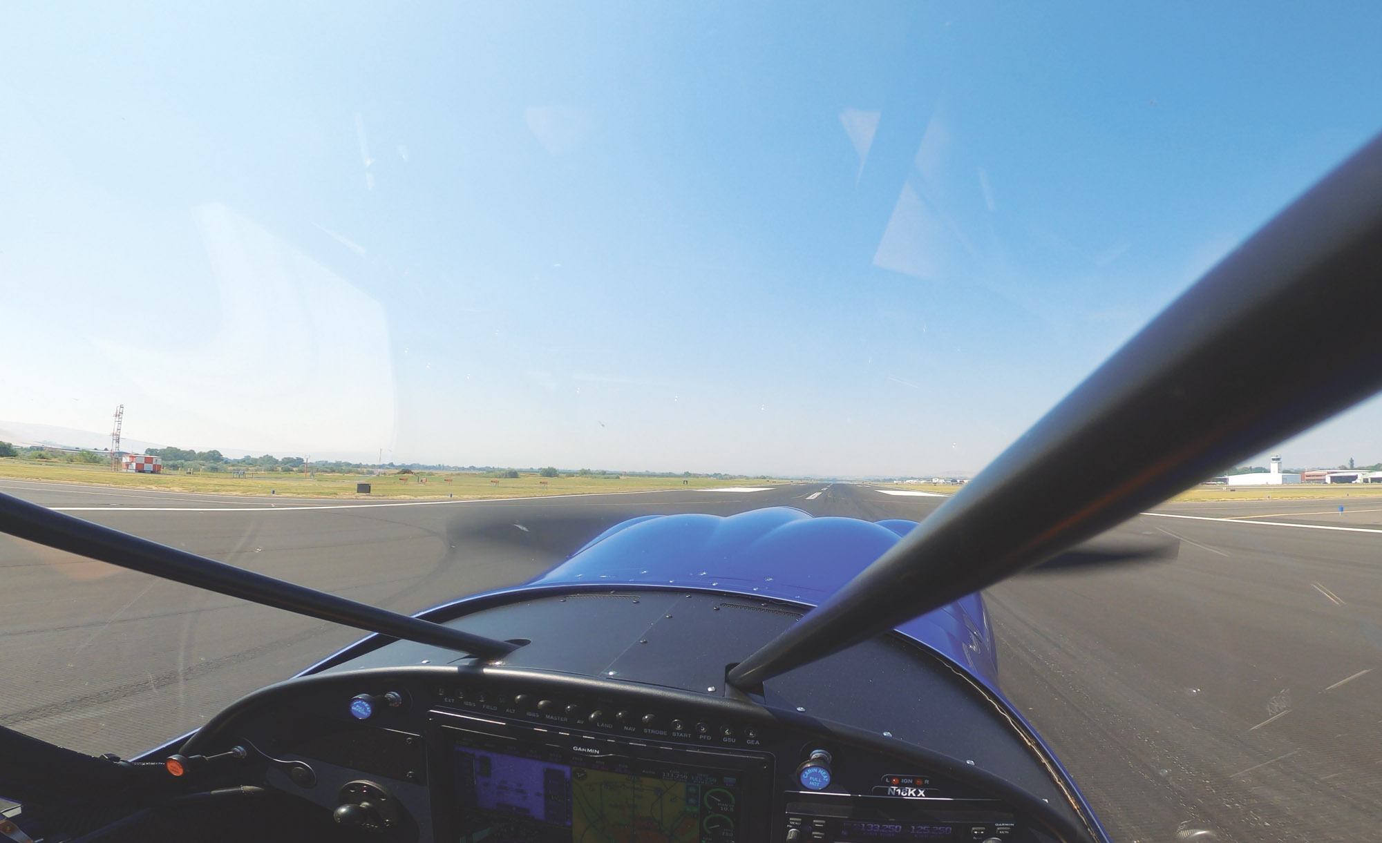

Ideally, the slow-speed portion of taxi testing should take place where you have lots of room. But the airplane also needs to be ready to fly. Just in case.

All aircraft testing, including taxi tests, requires planning and discipline. Each run should be planned. The pilot should execute only the predetermined profile and not improvise or try to do more. The taxi tests are a series of runs down the runway. They start at speeds slightly above normal taxi speed and ideally build up to at least takeoff rotation speed.
Each test run follows essentially the same sequence. Before going onto the runway, ensure the airplane is configured for the planned run, then:
Line up and wait: Taxi onto the runway and line up on the centerline.
Brake release: Release the brakes and smoothly apply power. The power level will vary depending on the run plan. Early runs will be at reduced power. Later, faster runs will use full power to accelerate.
Track centerline and accelerate to target speed: During the acceleration phase of the run, the pilot holds the controls steady, making only those control inputs needed to hold attitude and track the runway centerline.
Reduce power: When the airplane gets to the target speed, the pilot should either reduce power to hold speed or pull the throttle to start coasting down. The goal here is to ensure that the airplane does not continue to accelerate during the controls exploration to follow.
Make planned control inputs and observe response: With the speed stabilized, the pilot can now perform the specific controls exploration for this run.
Decelerate and exit runway: Reduce power to idle if it is not already there, neutralize the controls and brake as needed to slow or stop. Exit the runway.
