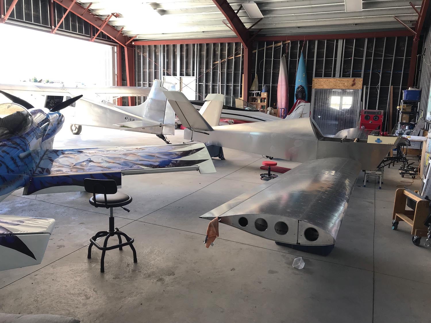

hangar with planes IMG 6169
If you’re lucky enough to have more than one airplane in your fleet, chances are you’ll be doing less flying and more maintaining of each.

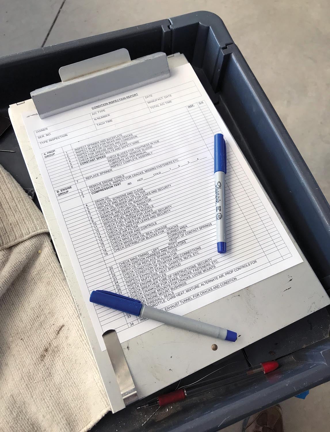

maintenance checklist IMG 6173
A checklist is a necessity, the best way to keep track of what you’ve done and to compare how your airplane is “wearing” year over year.
Why is this important? Well, first, there’s that bit about deferring maintenance “until the inspection.” Wrong, wrong, wrong. You do maintenance when it is time to do maintenance, based on flight time, calendar time, cycles or wear. Maintain when needed, record it in the book, and when it comes time to do an inspection, review what has been done to see if it needs to be repeated.
When it comes time to do an inspection, the guidance we are given by the FAA is to be found in Appendix D of Part 43—the thing you reference when you sign the logbook declaring that the airplane is in a condition for safe operation. It’s easy to find, and I bet that most builders have never actually read it. Go ahead and Google it right now—type “Appendix D to Part 43” into your browser—it will pop up. Got it? Good—it’s not very long, is it? As you go through the few paragraphs, you’ll note that there is nothing there mandating an oil change, brake pad replacement, or anything else that comes under the heading of  “maintenance.” It says “inspect the condition”…“look for excessive leaks”…“inspect for deterioration or breakage.” Nope, nothing there about doing anything other than looking and identifying.
The fact that Appendix D is all about inspecting and not maintaining should tell you something about the difference between the two, and this is why I suggest that people see them as two separate functions. I change the oil when it comes due—and if I have done that five hours before I do the inspection, I don’t change it again. Appendix D doesn’t say I have to, and the maintenance manual doesn’t say I have to. Same thing is true with all of the serviceable components. I have a number of aircraft in my fleet, which means that most of them don’t fly very many hours in a year. My RV-8 flew a total of 30 hours last year, and had about that many landings—do I really need to repack the wheel bearings because a year is up? Well not according to Appendix D, which is our guide for inspecting. Brake linings last me hundreds of hours on my taildraggers (I don’t fly most of them into very short strips requiring lots of braking.) So they get changed when the minimum thickness specified by the Cleveland manual is reached.
