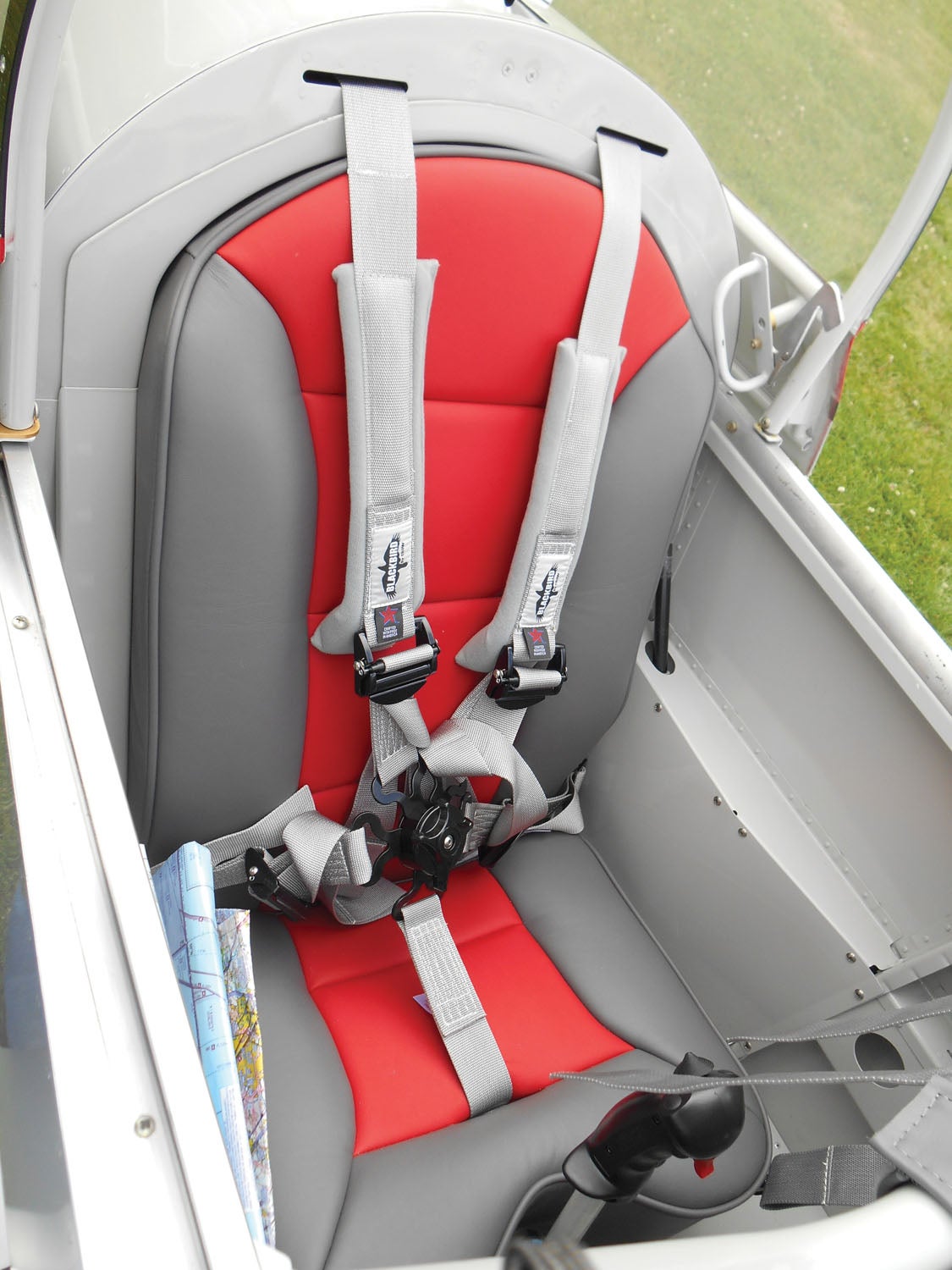

Four-point harnesses provide excellent security but aren’t always the most comfortable choice for passengers and aren’t so commonly found in the back seats.

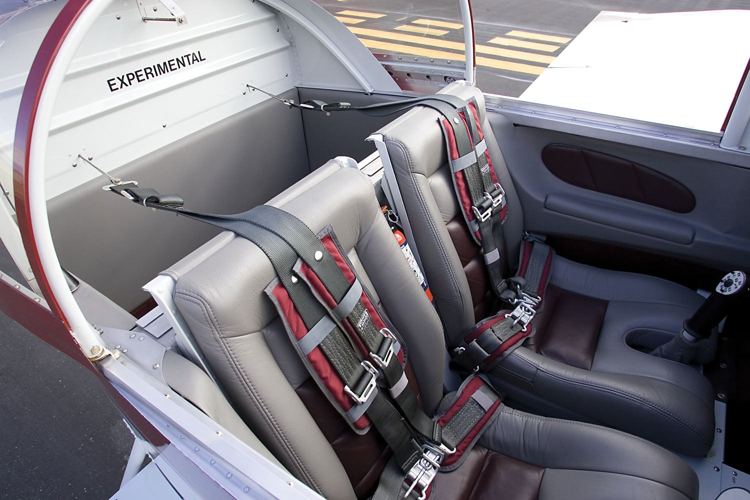

The approach angle of the shoulder strap is important both for retention and for comfort. The goal is to have the strap approach angle be somewhere between 5° below horizontal to 30° above horizontal.
Placing Attachments
Proper mounting of the seat belts and‭ ‬shoulder harnesses is critical‭. ‬The lap‭ ‬belts should attach so as to slant at approximately a 45‭° ‬to 55‭° ‬angle relative to the longitudinal axis of the aircraft‭ (‬which allows for some adjustment of seat position‭), ‬so the belt remains‭ ‬over‭ ‬the hips and pelvic region during a‭ ‬crash‭, ‬rather than across the thighs or abdomen‭. ‬The shoulder harness‭, ‬as part of a total system‭, ‬must not contribute to migration of the seat belt or displacement of the occupant from the seat‭. ‬To do this‭, ‬shoulder harness attachments and guides should lead harness straps to approach from behind the shoulder in a range from 5‭° ‬below horizontal to 30‭° ‬above‭. ‬
Lap belts are simple‭, ‬with few options‭; ‬shoulder harness restraints‭, ‬on the other‭ ‬hand‭, ‬are available in various forms‭, ‬from single belts fitting diagonally across‭ ‬the body like automobile restraints‭, ‬to‭ ‬dual belts across both shoulders‭, ‬usually attached to a single fitting directly behind the seat‭. ‬Five-point restraints‭, ‬incorporating a‭ ‬“crotch strap‭,‬”‭ ‬are commonly‭ ‬installed in airplanes used for aerobatics‭, ‬properly termed a‭ ‬“negative G”‭ ‬strap‭, ‬to prevent upward migration of the lap belt‭. ‬For crash protection‭, ‬the single shoulder harness is perfectly suitable‭, ‬if‭ ‬properly‭ ‬installed and adjusted in conjunction‭ ‬with the lap belt‭. ‬Dual harness spreads the load of a crash but can allow‭ ‬“submarining”‭ ‬of the body in some circumstances‭, ‬unless a crotch strap is added‭. ‬For serious aerobatics‭, ‬IAC competitors must wear a dual lap belt as part of the five-way harness‭, ‬and ratcheting adjustment devices are part of harnesses specifically designed for aerobatics‭.‬
To perform properly‭, ‬a single-belt‭ ‬shoulder harness must lie across the‭ ‬shoulder and chest‭, ‬crossing at the midpoint of the shoulder and extending to the opposite hip‭, ‬at an angle that neither touches‭ ‬the head and neck nor permits the harness to slip off the shoulder‭. ‬The lower end of a diagonal single-belt harness should not connect to the mid‭-‬point of the lap belt‭, ‬but at or near the belt’s attachment beside the hip‭.‬
Dual harnesses‭, ‬extending over each shoulder and connecting to a common release point with the lap belt‭, ‬depend on having the lap belt rising from attachments 45‭° ‬behind the hips‭, ‬in order to prevent the lap belt from being pulled upward in a crash‭. ‬If the‭ ‬harness originates at a central attachment behind the seat‭, ‬an adjustable yoke can be used to prevent neck injury from having the two‭ ‬harnesses lie too close together‭. ‬Connecting the dual-strap harness to a floor attachment requires having guides at the top of the seat back to keep the geometry correct‭. ‬The seat back must rise to shoulder height‭, ‬typically about 25‭ ‬inches‭ ‬above the seat cushion‭.‬
If attaching belts and harnesses to the seat structure instead of the airframe‭, ‬consideration has to be given to the‭ ‬strength of the seat’s mounting‭, ‬which now assumes the task of retaining the occupant in a crash‭. ‬While having the belts on the seat frame is an attractive option‭, ‬allowing you to adjust the seat‭ ‬after tightening your belts‭, ‬hard-point‭ ‬attachments to the airframe are probably more preferable‭.‬
Seat belt end fittings are available‭ ‬in quick-disconnect style‭, ‬as well as simple bolt-on types‭. ‬If using a quick-disconnect fitting‭, ‬be sure to install a cotter‭ ‬pin to immobilize the swiveling arm‭ ‬that allows it to unhook from the attach point so it can’t be tripped inadvertently and come loose‭.‬

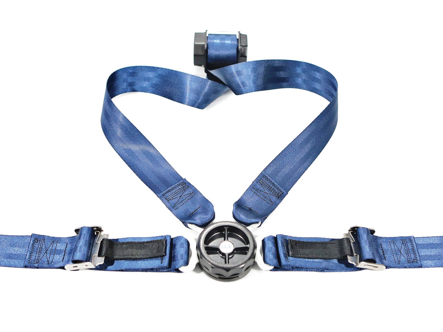

belts abi model sa four point 2
Aircraft Belts’ four-point, inertia-reel system.
Aircraft Belts‭, ‬Inc‭.‬
Long famous for replacement and refurbishing of certificated airplane restraints‭, ‬ABI is expanding into the Experimental‭ ‬aircraft market‭. ‬By mid-2020‭, ‬in time‭ ‬for AirVenture‭, ‬it will offer a low-cost non-TSO’d four-point restraint with a rotary buckle release‭, ‬in a full choice of webbing colors‭. ‬Pull tested to 3000‭ ‬pounds‭, ‬the new harness system will‭ ‬be sized to fit RVs and other popular‭ ‬Experimental aircraft‭, ‬for which the‭ ‬TSO process is not required‭.‬

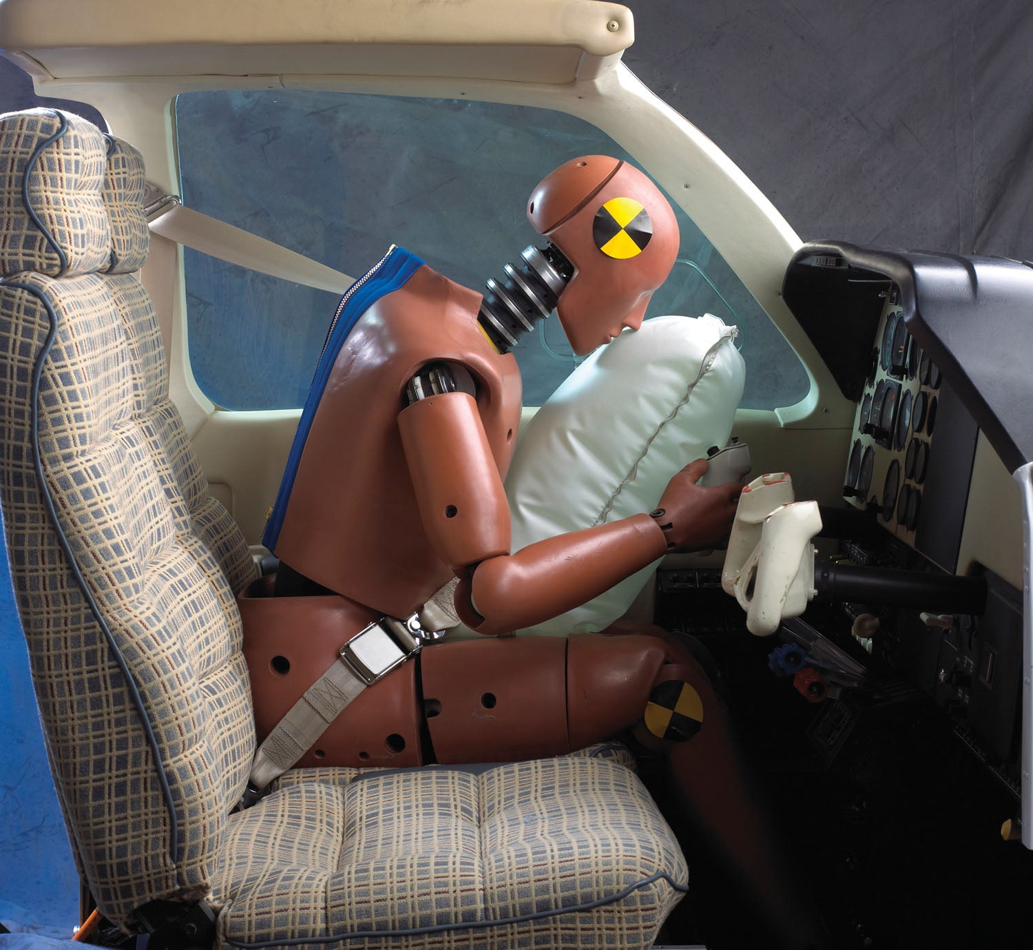

belts airbag deployed 1
While not yet common in homebuilts, the AmSafe SOARS airbag seat-belt system has become a hit in the certified world. The pillow-like bag inflates with a 9-G load and helps reduce head and torso injuries.
AmSafe
As a primary supplier of airliner and‭ ‬military restraint systems‭, ‬AmSafe‭ ‬has belts for a wide variety of general aviation aircraft‭. ‬For even more crash protection‭, ‬AmSafe markets an airbag‭ ‬system‭, ‬suitable for certificated and‭ ‬Experimental airplanes‭, ‬that inflates‭ ‬in a crash situation to reduce injury‭. ‬Unlike dashboard-mounted automotive systems‭, ‬the bags in AmSafe’s State Of The Art Restraint System‭ (‬SOARS‭) ‬are contained in the harness‭. ‬If it detects a sustained acceleration of 9‭ ‬G’s or more‭, ‬SOARS automatically inflates a pillowing cushion away from the occupant‭, ‬reducing head and torso injuries‭.‬
