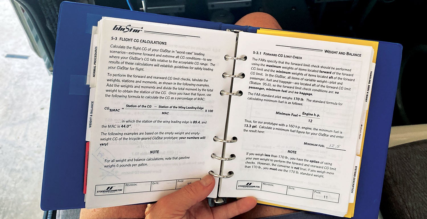

Some kit companies produce very nice “generic” owner’s manuals, as the old Stoddard-Hamilton did for the GlaStars and Glasairs (left). Creating a POH from your builder notes/manuals can help bring detail to the project (right).

Your builder log, kit materials and flight-test records can all be distilled into useful elements of your POH. For you, and for future owners.

The physical form for your book can be anything from a notebook to a 5×8-inch printed manual to a kneeboard assembly (see “What’s in Your POH,” by Glen Salmon, April 2015 KITPLANES®). The ability to print a single perfect bound book (get two) as a service from most commercial printers is surprisingly affordable. Put the content together first, and then decide how you will format it.
Here are the standard sections in a typical POH. Edit to suit. Each section will draw from the work you did assembling the data during the building process. Since some of the information is in the form of originals in your notebooks, make copies of these to place in the POH. That way, you can put the binders in a safe place and work from the handbook.
