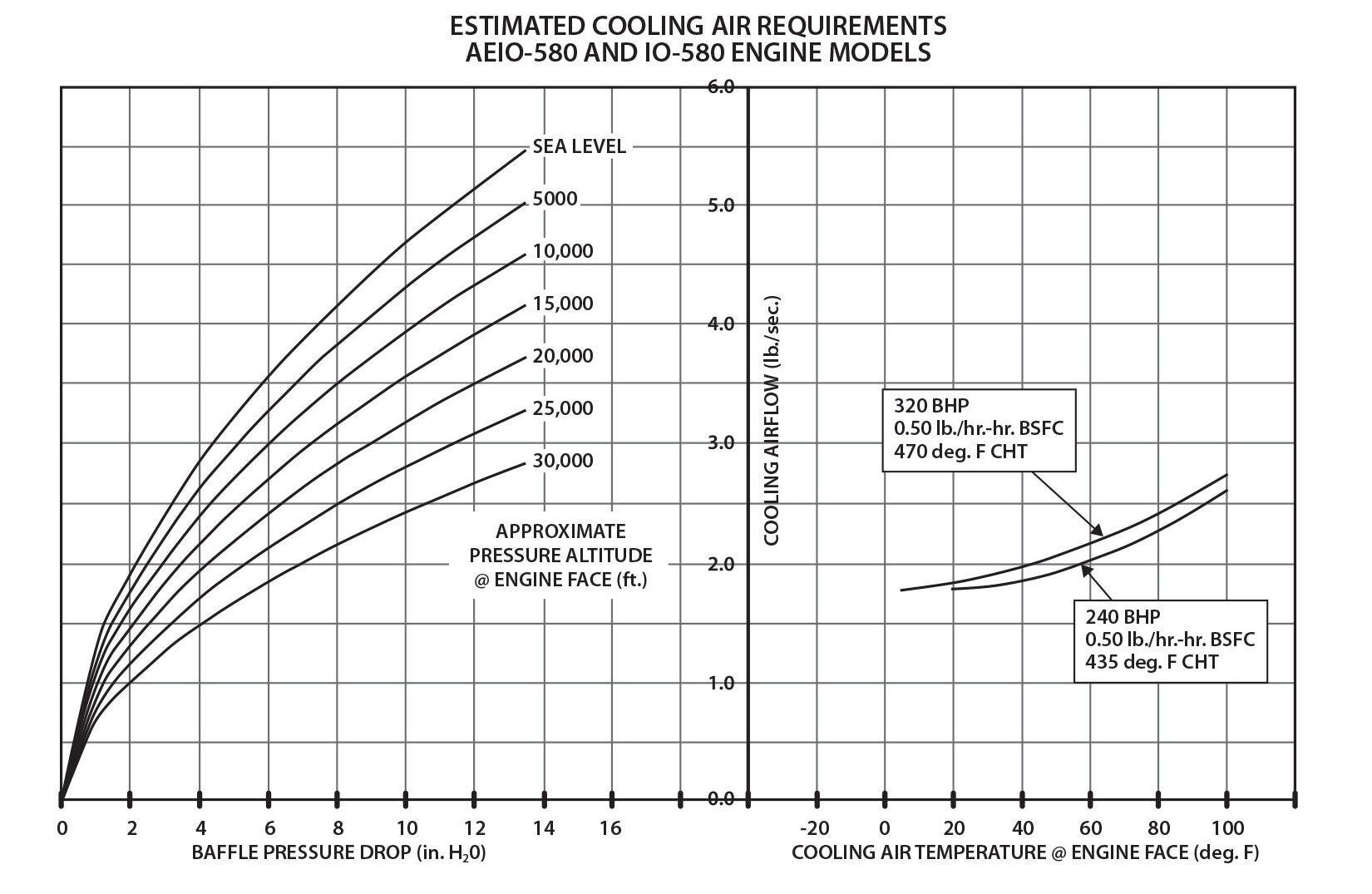

Before you start anything, sit down at your table and calculate the requirements for your plenum, which depend on the engine cooling flow requirements for your mission. Everyone has seen the cooling requirement graphs for engines (Figure 1). These graphs are going to let you know before you start to build anything that your outcome will meet the mission.
LycomingCoolingTable fig 2
Figure 2: This graph shows that with 100° F cooling air temperature and 435° F cylinder head temperatures, an AEIO-580 or IO-580 will require 2.65 pounds per second of cooling airflow.
If you don’t have access to the manufacturer’s cooling requirements graph, you can look at one for a similar engine with the same single-cylinder displacement. This is not best practice, but if you have a Lycoming 540 with 90-cubic-inch cylinders, it will compare somewhat with the Continental 550 that has 91.67-cubic-inch cylinders. Then you have to take into consideration that both engines produce a similar amount of horsepower per cubic inch.
So, let’s say you are comparing a 260-hp engine to a 310-hp engine; the higher-horsepower engine is producing 50 hp more BTU, so it may require 19.2% more mass flow to cool it. I know this is a very poor way to estimate cooling requirements but it tends to be close.

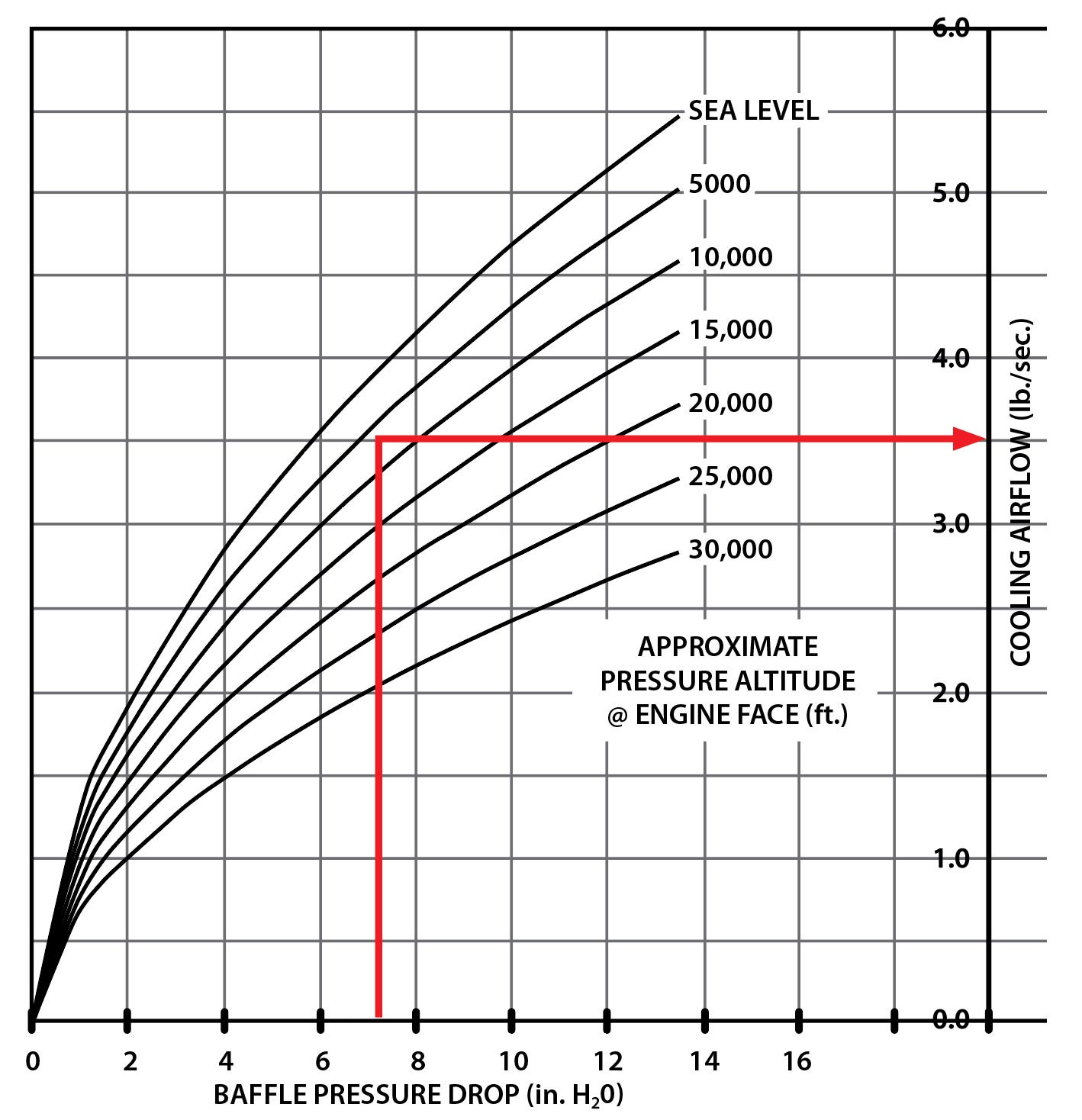

Figure 4: Without decreasing pressure under the cylinders from the exhaust, delta p will be around 7 inches of water. This will produce about 3.45 pounds per seconds of airflow.

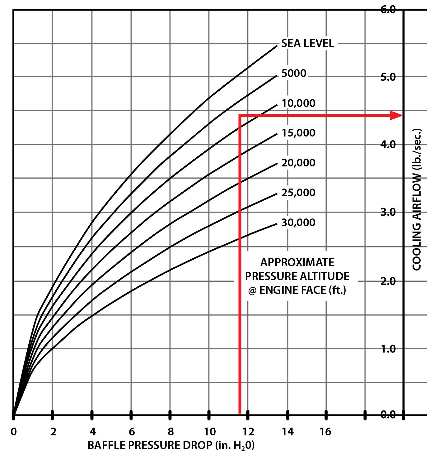

At 150 knots you can get about an 11.5-inch water delta p across the cylinders…if you are running good convergence zones or augmenters. Without convergence zones or augmenters you may get about 7 inches of water at 150 knots. The middle line in Figure 3 is from piccolo tubes, which were attached immediately above and below the cylinders that were connected to a Magnehelic test gauge. The top line is from a piccolo tube at the back of the plenum at the case midline. The lower line was from a piccolo tube on the firewall convergence zone about 3 inches above the exhaust. These locations are good enough to predict the delta p possible.

Figure 5: With exhaust assistance lowering pressure, delta p will be about 11.5 inches of water, which will produce about 4.4 pounds per second.
If you don’t have any help decreasing the pressure under the cylinders from your exhaust, your delta p across the cylinders will be around 7 inches of water. As shown in Figure 4, this will only produce about 3.45 pounds per second of airflow. According to the manufacturer’s cooling requirement chart, this should be adequate if you are making every cubic inch of air do its work.
However, with exhaust assistance lowering pressure in the lower plenum, the delta p from immediately above and below the cylinders can be 11.5 inches of water, which would produce about 4.4 pounds per second (Figure 5).  This could decrease the potential maximum CHT temperatures during a 150-knot climb with an ambient temperature of 100° F.  It could also get the CHTs to around 390° to 400° F with an ambient OAT around 80° to 90° F, but you may have to cool with fuel on extended climbs. Cooling should also increase as you gain altitude, so you’ll have to do some testing to see the actual result.

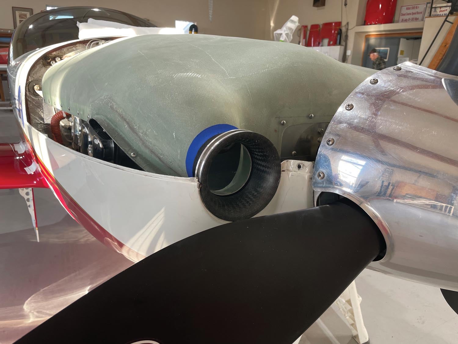

4. Position the inlet and mark the forward position of the plenum opening. The inlet you see below is vacuum bagged carbon fiber tube sock material, and it is positioned according to the cowl inlet position. We used the blue foam, which was hot glued to the forward plenum support bracket, to locate the inlet position for the plenum.

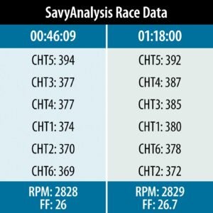

Joe Coraggio is one of the principal organizers of the AirVenture Cup Race. He also competed in the 430-mile race this year in his Lancair Legacy, equipped with the plenum you see in the last photo.
custom engine cooling plenum 17We did the calculations for the mission so the plane could run flat out indefinitely, based on his SDS electronic fuel injection and ignition, and not sustain a problematic temperature. This aircraft is being cooled with 19.25 square inches of total inlet for cylinder cooling, engine induction and oil cooling. The OAT during the race was 62.5° to 79° F depending on altitude. Joe is producing around 340 +/- hp at race rpm.

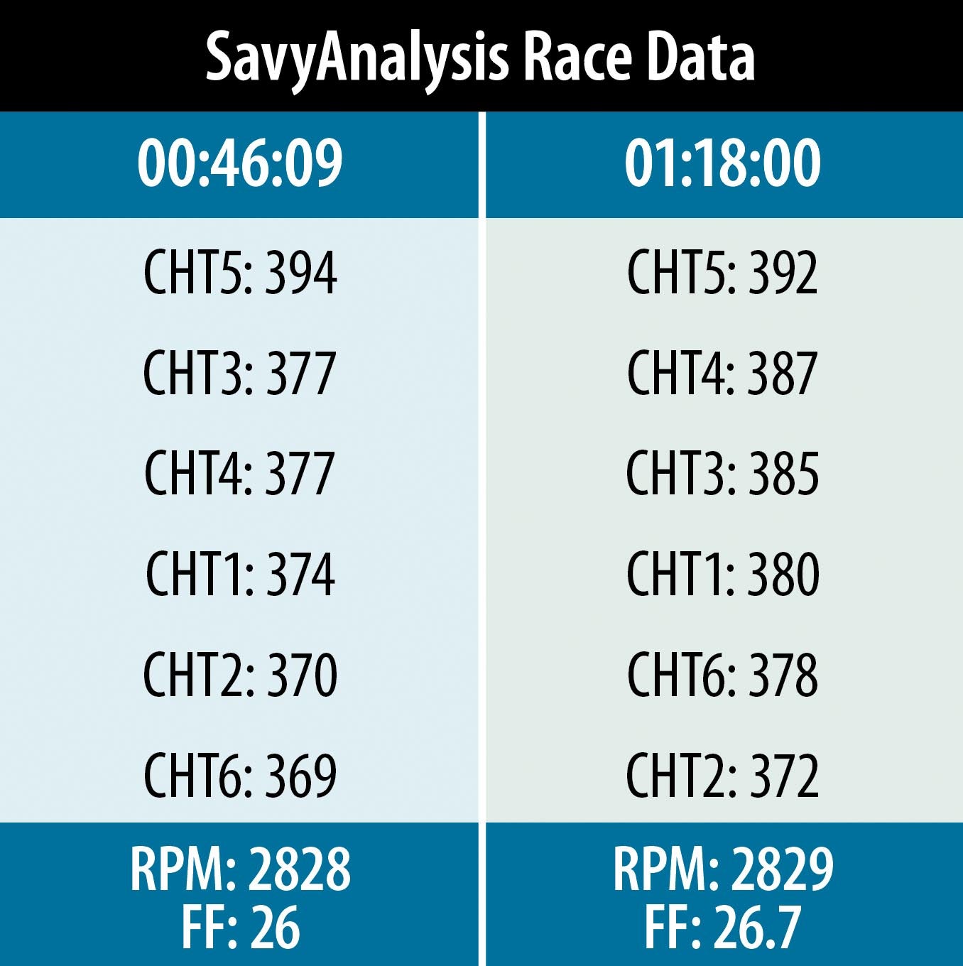

Here is SavvyAnalysis data during the race at 46 minutes and again at 1 hour 18 minutes. The maximum oil temperature was 225° F, and all temperatures were quite stable at +/-5° throughout the race.
So how did Joe place? First in his class.
