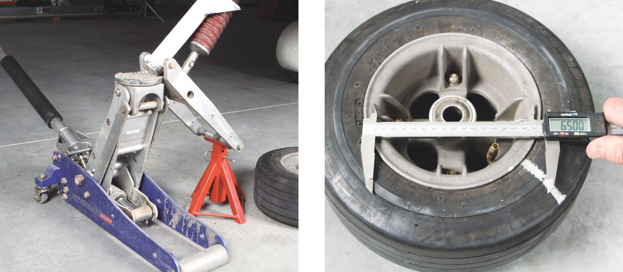

Always use a jack stand for safety when changing wheels or tires (left). The red stand was a home shop project in the March 2019 issue of KITPLANES. Measuring the wheel to figure the tool shape (right).

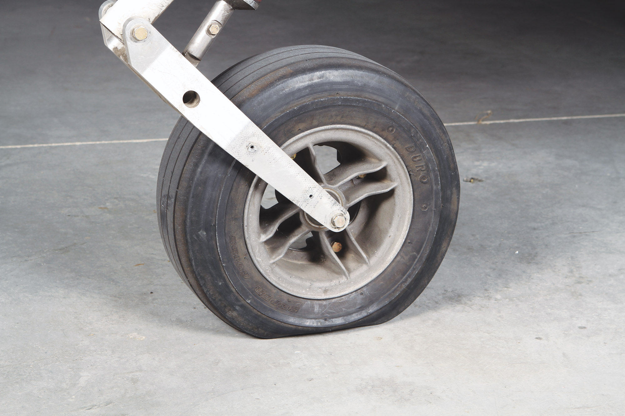

After filling up, I pushed the Jabiru away from the pump and hit the porta-potty. In the 20 minutes or so between shutting down, fueling and coming back from the loo, my front tire went completely flat. Hmm. Away from home. Sunday afternoon. No tools and no spare tube. Worst case scenario, I could tie down the airplane and get an Uber ride home (20 miles). I lucked out. My buddy Jere was nearby and could come and get me. In the meantime, I found a traveling A&P working on a jet in a nearby hangar who took pity on me. He not only loaned me a couple wrenches and a screwdriver, he came out and held the nose gear off the ground so I could remove the wheel.
With the wheel off and the nose gear resting safely on some two-by-fours, I set about disassembling the wheel to remove the tire and tube. I got as far as splitting the rim, but the tire was so firmly seated to the rim that no amount of pushing, pulling or cussing would separate them. Luckily, Jere arrived and we took the wheel over to his hangar where, horror of horrors, the only “pry tools” on hand were some large screwdrivers. I eventually managed to pry the tire off (with the aid of some soapy water), but I put a few scratches on the rim in the process.

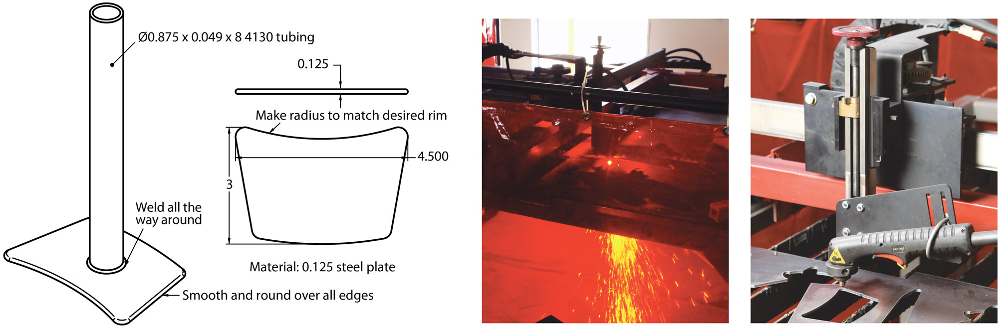

Sketch of the bead breaker lever plate and handle (left). Plasma cutting the lever plate (center). The business end of the plasma torch and table (right).

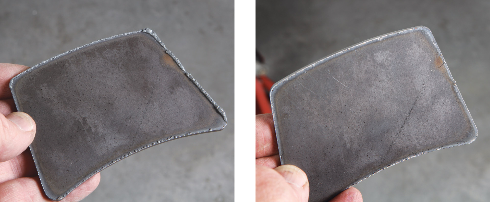

tire bead breaker 05
Plasma cutting tends to leave a bead of slag on the back edges of the part (left). The slag (also called dross) is easily broken off using a chisel or a welder’s chipping hammer (right).

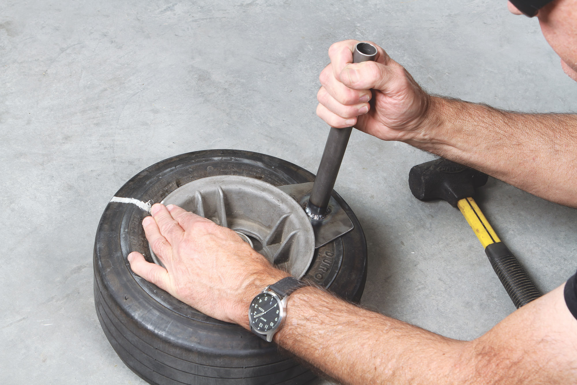

One thing I was not going to repeat was using screwdrivers to unseat the tire from the rim. I needed a bead breaker, so I decided to make one. While not as fancy as some of the tire changing tools you’d find in a repair shop, it works and that’s what counts.

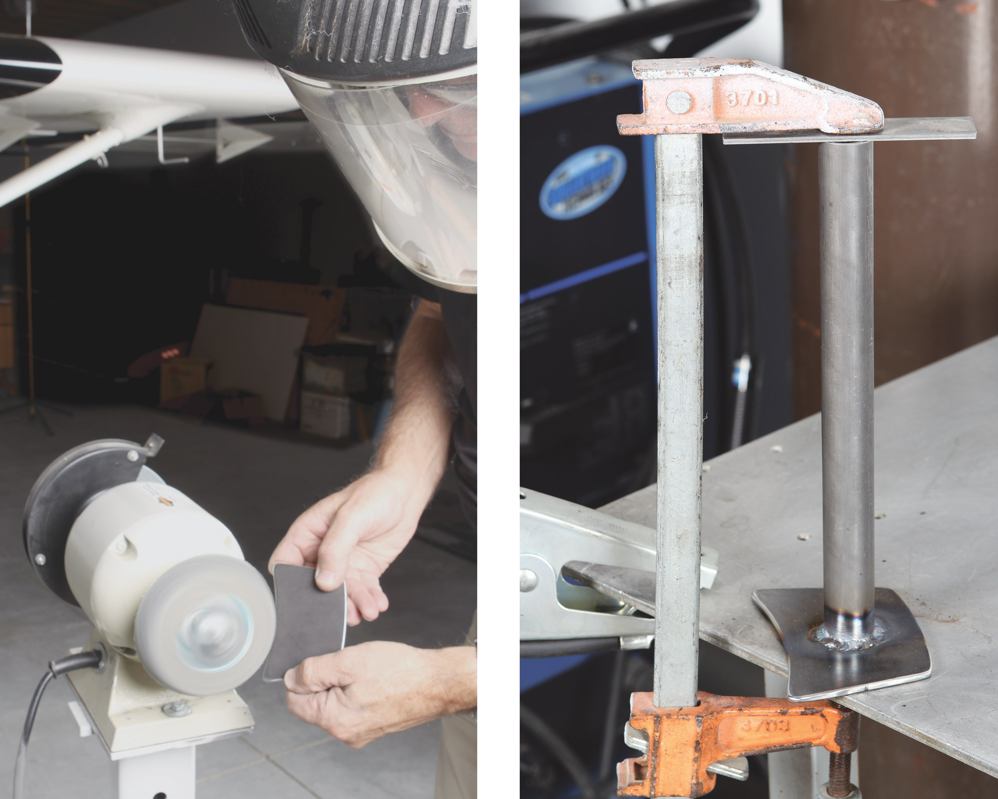

An abrasive fiber polishing wheel was used to smooth over all the edges (left). Clamping and welding the handle to the lever plate (right).
The material for the lever plate was made from 1/8-inch steel plate and the handle was made from ⅞-inch 4130 steel tubing. The tubing came from a “bargain bag” purchase from Aircraft Spruce. The bargain bag (part number 03-15900) consists of random sizes and lengths of 4130 tubing. The batch I got consisted mostly of ⅞ x 0.049 tubes 12 inches long.

Good tools help you do a good job. No more screwdriver scratches on the rim!
I happened to be in the middle of making a bunch of yard art signs with a kitbuilt Torchmate CNC plasma cutting machine, so that’s what I used to cut out the lever plate. Plasma cutting is a fast but somewhat crude method of part making. It’s sort of a poor man’s laser cutter. In any case, for this project you don’t need a plasma cutter: a hacksaw or band saw and hand files can do the same job.
