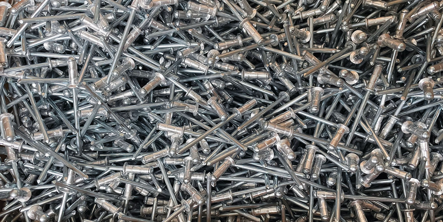

aluminum rivets
Aluminum rivets.
Rivet Material: The two most common materials used for the body of the rivet are aluminum or stainless steel. (The rivet stem or mandrel might be a different material than the body.) As you can imagine, a big decision in choosing these materials has to do with the desired strength of the fastener. If you think that an aluminum blind rivet should not be used in the structure of an airplane, be aware that one of the most popular kit aircraft sold and flying today (and for the last 40 years) is primarily constructed with thousands of aluminum blind rivets! (It’s found in the Zenith Aircraft family of planes.)
So, it is the creative, calculated use of these fasteners that makes them strong. One example of strength: a typical aluminum 1/8-inch diameter rivet has a shear strength in the range of 100–200 pounds. A stainless steel rivet of the same size is typically double that strength. Shear strength measures how hard it is to cut through the rivet body. If tensile strength is critical, stainless steel rivets have greater than three times the strength of aluminum blind rivets of that same 1/8-inch diameter. Tensile strength measures how hard it is to pull the rivet apart (pull the head off, for example).
Rivet Diameter: Just like any round fastener, you have a choice of the rivet’s diameter. Looking at a table of rivet specifications, we see that both shear and tensile strength increase as the diameter grows. Typical diameters used in kit aircraft include 1/8, 5/32, and 3/16 inch. The tiny 3/32-inch diameter rivet is wonderful for quick installation of small nut plates with small ears.
