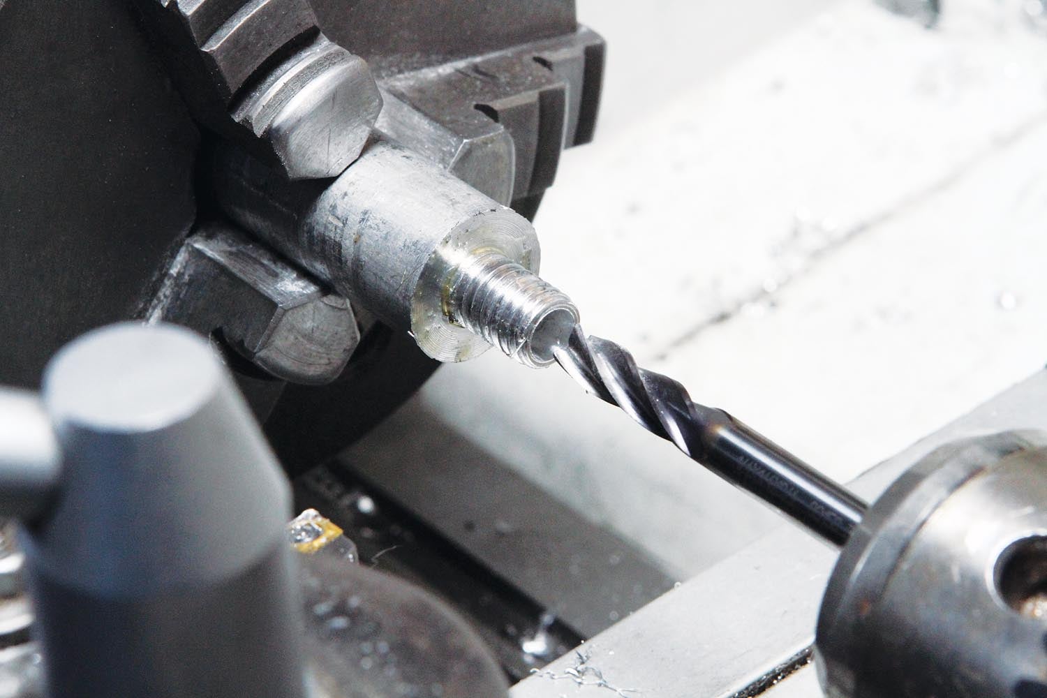

The retaining sleeve was turned to size, hand-threaded using a 3/8-16 die (left), then through-drilled using a #23 bit (right).

The retaining sleeve was counterbored to depth using a 1/4-inch end mill mounted in the tailstock chuck.

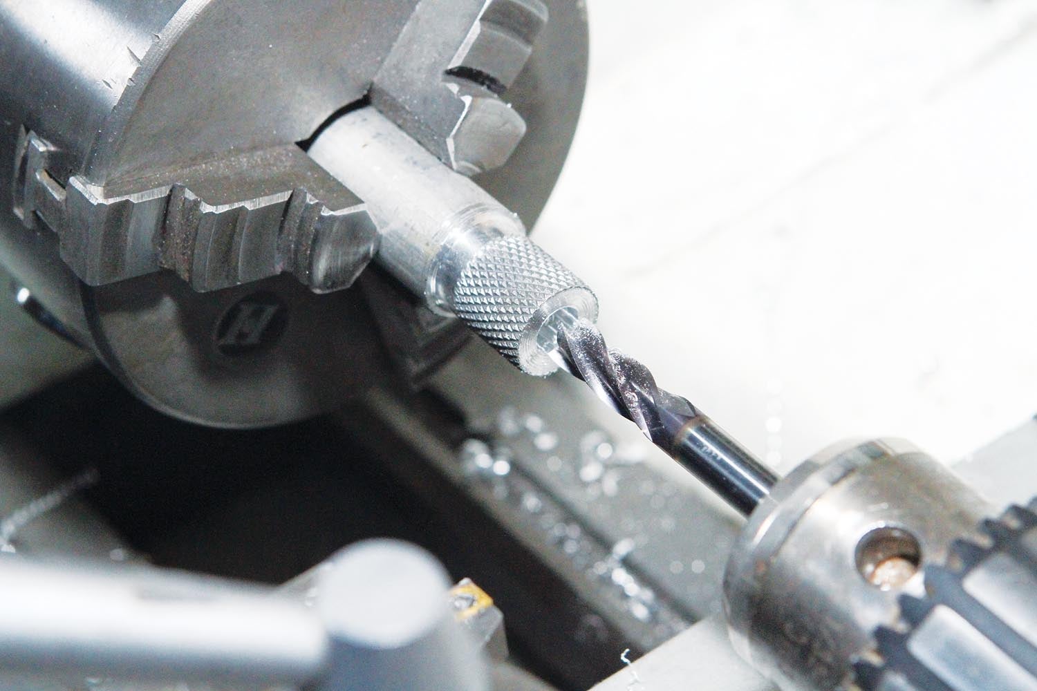

The compression sleeve was turned to 5/8 inch (left), then knurled using a scissor tool (right). See “Gnarly Good Knurls,” November 2016, for a full article on making knurled parts.

After knurling, the compression sleeve was “tap drilled/counterbored” using a 5/16-inch end mill in the tailstock chuck.

My recent experience got me thinking about a home shop solution. The result was a simple bleeder coupling that can be made in an afternoon with about 6 inches of 3/4-inch-diameter aluminum bar stock. To keep things simple, I used a small O-ring instead of relying on a metal-to-metal taper to make the seal, and it has a long hose barb with a 1/4-inch OD so you can easily hook it to whatever pressure system you have using a standard 1/4-inch ID poly hose.
