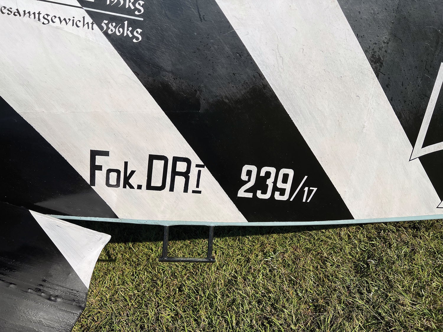

fokker dreidecker serial number
The serial number honors Werner Voss, who was killed in a seven-versus-one dogfight on September 23, 1917.
You’ve probably noticed that the paint scheme is rather striking and different from the standard Red Baron motif. In part, this was to distinguish it from the crowd, but also to pay tribute to the numerous other Dr.I pilots in WW-I. The serial and registration numbers were chosen specifically in honor of Werner Voss, who was killed in a legendary seven-versus-one dogfight on September 23, 1917, in which he brilliantly used the renowned maneuverability of the Dr.I against numerous British S.E.5a aircraft. The number is written in the European fashion of having the day then the month listed, so it is 239/17. This serial number actually falls in a window of time when Dr.I production was halted, so it isn’t a number that was ever assigned to an actual aircraft.
The black and white paint scheme on the cowl mimics Jasta 2’s (famous for Oswald Boelcke) squadron motif. The cross on the horizontal surface of the tail mirrored the scheme of another Jasta 2 Dr.I pilot, Paul Bäumer. This combination of subtle touches was designed as an amalgam saluting all the Dreidecker pilots and an homage to Voss rather than any specific aircraft.

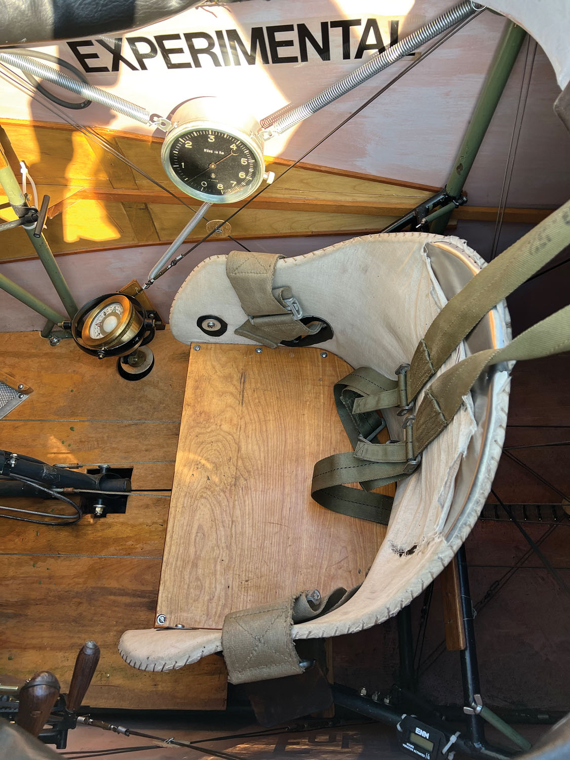

fokker dreidecker cockipt seat
The rather basic pilot’s seat. Instruments are scattered about the cockpit, very much like they were in an actual 1917 Dreidecker.

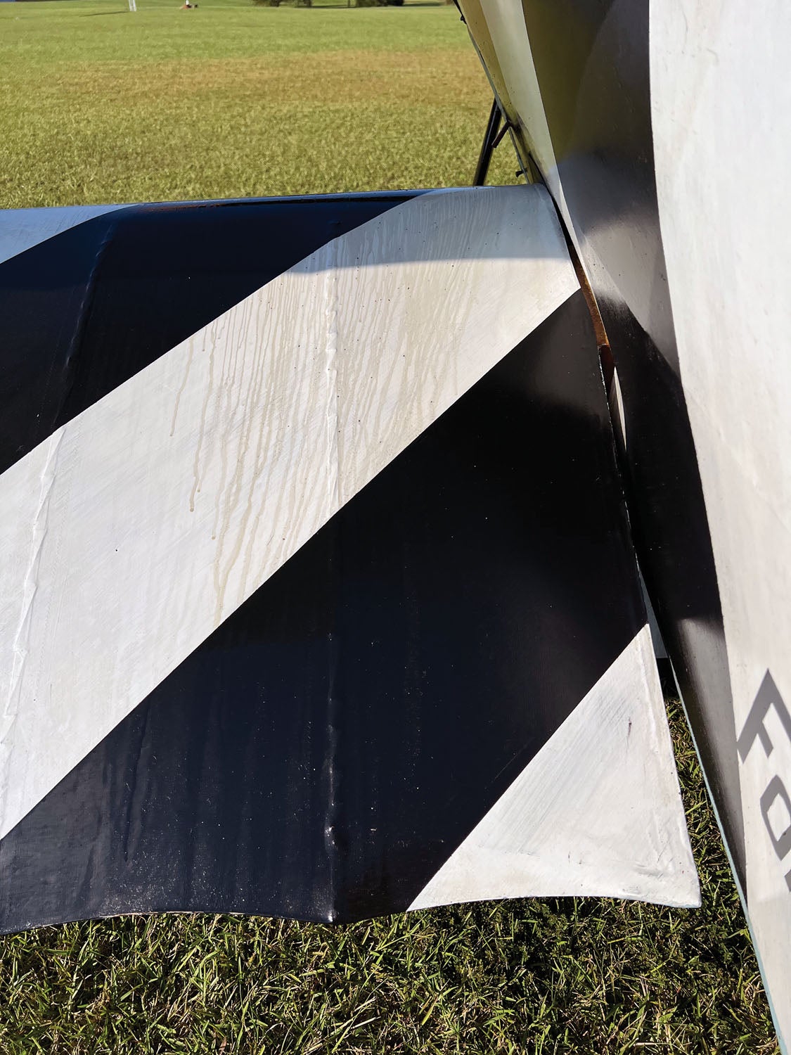

fokker dreidecker oily wing
Once on the ground, the rags come out and cleaning begins because the plane has effectively been bathed in castor oil. The left lower wing is shown here.
