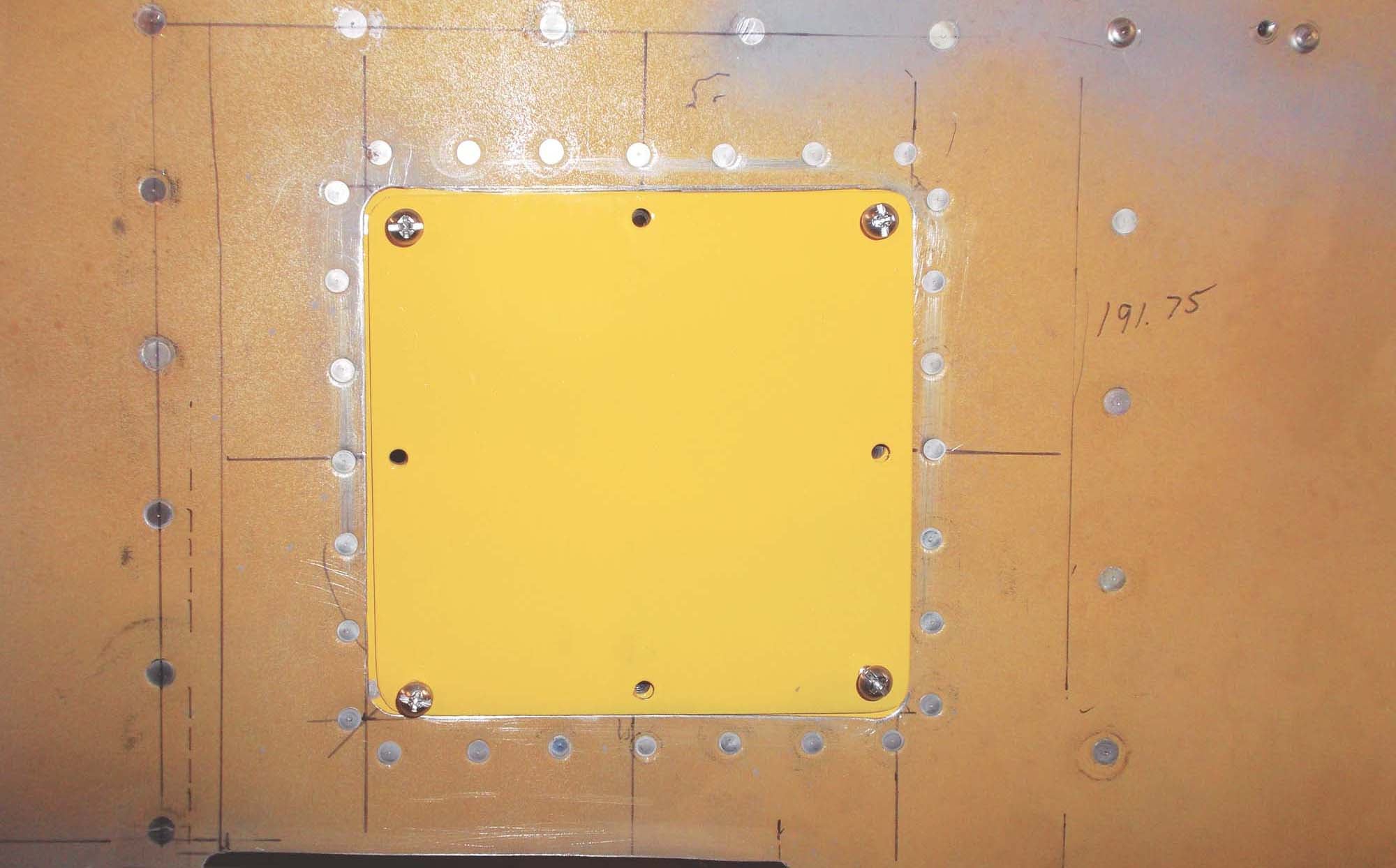

access panels 03I find it unsettling to cut a hole in a perfectly good fuselage, but there are times when it needs to be done. In this case I needed to provide access to bolts associated with the horizontal tail of my T-18 project. Browsing the Thorp forum and examining T-18s at Sun ’n Fun convinced me that I would later regret the lack of access panels if I did not incorporate them during the build phase.
To get dimensions, I measured the area for the openings on completed aircraft, plus I cut some openings in cardboard to see how comfortably my hands would fit. I settled on 3.5×3.5 inches as a good size for the opening. Don’t forget that the access cover will be that size plus enough on each side for edge distance from the screw holes, about 0.30 inch to either side of the holes.
To be honest, the edge distance for the screw holes is not critical since it is a loose-fit hole that should not have sideways forces creating a tear-out situation. In my case, that meant 4.7×4.7 inches for the cover itself. To provide edge distance for the attach rivets, I added yet another 0.25 inch on either side of the fastener row, so the doubler itself winds up with overall dimensions of 5.7×5.7 inches. Size yours accordingly depending on the size of your hands and what needs to be accessed, especially if you need to get a tool through the opening.
One problem was how to smoothly create a rectangular opening and minimize sanding and filing afterward. Using hand shears will distort the cut edges, plus they are unwieldy for smaller, internal cuts. To get a better result, I turned to a technique I read about some years ago: using a knife instead of shears to cut the metal.

The trick is to score the metal to create a bend line with a V-shaped groove in it, i.e., a stress riser. On thinner metal, 0.020 to 0.025 inch thick, I have cut all the way through in about 20 or so passes in a situation where there weren’t any free edges. If there are free edges and you are able to bend the metal, five or six passes will be enough.
A good rule of thumb for skin doublers around openings is to go a gauge thicker than the parent metal. With 0.025-inch fuselage skin, that meant I needed 0.032-inch-thick doublers. But in a senior moment, I forgot that I had re-skinned my outer wings a gauge thicker. This meant that the old skins I was using as raw material were only 0.025-inch 2024-T3, not 0.032. Oops! And when I did make the second set, I observed that 0.007 inches of thickness does make a noticeable difference in being able to bend the metal. (No, I couldn’t think of a good 007 reference there.)

1 2 The dotted lines show the area where access is needed under the horizontal tail. 3 Laying out the corners of the opening and drilling the pilot holes. Note that the opening is the outer square. 4 The corner holes and the large center hole are drilled. If you look closely, you can see the scribe lines tangent to the corners. 5 The cuts to the corners look ugly and illustrate how much the snips would be distorting the metal. 6 Here you can see where I started to use a cutoff wheel. After that, I decided to go with the scoring method. Note how cleanly the right side piece is separating.
For thinner gauges, you can use a disposable craft knife, but my preference is a hook-shaped knife for cutting vinyl flooring. I found mine in one of the aviation aisles at a big-box hardware store. After determining dimensions, I laid out where to have corners with a 0.25-inch radius and drilled them out. For thin sheet metal, the best results come from drilling a pilot hole with a 1/8- or 3/16-inch bit and then using a Unibit step drill to take the hole up to a 0.50-inch diameter. For this I used a cordless drill and slow rpm to minimize the bit wanting to “walk.” Even so, it will try to walk (don’t ask me how I know this), so take your time.
With the corner holes drilled, drill a large hole in the center of the metal to be cut out. Drill it as large as possible, as you will use snips to cut from this hole to the corner holes. Be sure to clamp the work, as the bigger the hole, the more the bit wants to grab the work and turn it, possibly leading to you needing bandages.
After getting the holes drilled, use a fine Sharpie to lay out a cut line tangent to the holes. Use a metal straightedge to guide the knife, taking care not to score the metal past the tangents of the holes; I used the steel ruler component of a vintage square. If possible, clamp the straightedge into place.
Draw the knife down the line at least five times for 0.025 inch or thinner and up to 10 times for 0.032 inch. The goal is to make all subsequent passes in the same groove as the first pass. If you look closely, you should see a tiny ribbon of metal shaving being removed with each pass.
After all four lines have been scribed, use your snips to cut from the center hole to the corners. You may have to cut out wedges of metal to get all the way to the corner without distorting the surrounding metal.
You will now have four triangular pieces of metal still attached at the scribe lines. Clamp the doubler along the line so that when you bend the triangular piece over, it does so at the scribe line. With the 0.025-inch versions, I was able to hold them in a crimping tool and easily bend the to-be-removed pieces with pliers or a gloved hand. With 0.032-inch metal, it was much more difficult and would have been easier (if I were patient enough to wait until I was at the shop) to clamp it in a vise. In either case, the pieces usually snapped right off on the return motion after being bent 90°, a good reminder as to why we smooth and blend scratches in the skin and work so hard to prevent stress risers.
After removing all four sections, a few passes with a file were needed to clean up any places where the edge didn’t have a clean break or the cut line wasn’t exactly tangent to the corner. I then dressed the edges with some emery cloth. Remember that you’ll be reaching through this opening, so smooth edges are very important.
access panels 05
1 Scoring the 0.025-inch version of the inspection panel with a disposable craft knife. 2 The doubler held in a crimper while removing the triangular pieces. Note that the lower edge wasn’t scored exactly on the line; this will be cleaned up with a file. 3 The triangular dropouts. The 0.032-inch ones tend to bend at the root before snapping off. Note that a couple of them were used to test dimpling and countersink settings. 4 Interior edges ready for dressing and smoothing. Outside corners have yet to be rounded off.
The openings in the fuselage were cut the same way as the doublers except that it wasn’t feasible to clamp the edge of the scribe line. Fortunately, with the side skins being 0.025-inch thick, it was easy to bend the pieces by hand (wearing work gloves) and they popped right out.
In both cases, there is no distortion of the parent metal from the shears, nor is there a ragged line from trying to get snips parallel to the cut line. Notice how much the metal is distorted in the cuts to the corners versus along the scored lines. Yes, you can also cut out an opening with a cutoff wheel, but for thin metal this is just as quick and easy, and there’s less risk of an uneven cut due to a miscue or slip of the hand. One of the photos shows where I initially was going to use a cutoff wheel before switching to a knife.

Using a Whitney punch to make ⅛-inch holes in both parts at the same time.

After fabricating the doublers, I laid out the rivet locations and marked them with a spring-loaded center punch (again located in an aviation aisle at the hardware store) to be followed by punching them out with a Whitney punch. If you don’t have one, a Whitney punch is invaluable for making clean holes without a drill bit possibly “walking.” Drop the nib of the Whitney punch into the punch mark and squeeze. The holes will be ⅛ inch, but easily drilled out to #30 in the next step. The Whitney punch is also very quiet when you are working in the garage and someone is trying to nap in the adjacent room.

The cover plate is held to the fuselage and traced for a close fit to the exact shape of the opening.
The cover plate material is cut slightly oversized and then held up to the fuselage openings to trace the exact shape. After the plates are trimmed for a close fit to the fuselage, they are Clecoed to the back side of the doublers and used to center the doublers over the fuselage opening. The doublers are then match drilled to the fuselage openings; be sure to mark them afterward since they are now “handed” and directional. Yes, in theory they are identical, but minor deviations during backdrilling mean they now fit one side better than the other, plus the fuselage openings may not be perfectly square/rectangular.

1 The cover plate is Clecoed to the back of the doubler. The cover plate locates the doubler to the fuselage opening. 2 Prior to dimpling, the doubler is used as a template to match drill the fuselage to the doubler. 3 The doubler is now located exactly where it will be installed. Note the 0.60-inch-wide flange where the cover plate attaches. 4 The finished cover Clecoed in place to the doubler. Note the close fit to the fuselage opening.

5 The rivet squeezer is also used as a dimpling tool. 6 Drilling a #19 hole for the nut plate installation tool, plus the opening for the screw. 7 Put the nut plate tool in the center hole, drill one #40 hole, then flip the tool over for the second #40 hole. 8 Very lightly countersink the rivet holes for the nut plates.
Use a Sharpie liberally to know which side faces out and which way is up. Since the fuselage itself is used to trace each access panel for its final shape, even if the fuselage cutouts are not perfectly square, they will have a very close-fitting cover tailored to that opening. Due to the Unibit drifting once or twice (no comment), my openings are not quite the precision geometric shapes that I wanted, but they are close and it will be difficult to discern that because they are located under the horizontal tail.
The cover plates will be held in place with #8 screws going into floating nut plates. Drill the screw holes using a #19 drill bit. This hole will be used to center your nut plate drill jig. Don’t have a nut plate tool? Then get one. I tried do it once without the jig by putting a screw in the nut plate and backdrilling the attach holes, but the results are far less than optimal. Spend the money for a nut plate tool; you will thank yourself later. The nut plate tool is placed in the screw hole to drill one attach hole, then flipped over for the second hole. The attach rivets are 3/32 inch, so a #40 bit is used.

1 A completed nut plate hole with countersunk holes for the flush 3/32-inch attach rivets. 2 The doubler drilled, dimpled and the nut plate holes countersunk, plus the outer corners rounded. 3 Outside faces in the paint booth, painted yellow to match the exterior paint scheme.
For the cover plate to fit flush, countersunk rivets are needed to attach the nut plates. The head height on a 3/32-inch solid rivet is about 0.036 inch, making it difficult to countersink holes for them in 0.032-inch metal without knife-edging the holes. Because of this, I set the countersink tool to leave the heads protruding by about 0.005 inch, which won’t be a factor in this application. Why? Because installing the rivets will squeeze the heads down nearly flush, and the inside of the cover plate won’t care if the rivets stand proud by a few thousandths of an inch afterward.
The dropout pieces removed earlier served as scrap metal to get the countersink tool set. A scrap piece of molding makes for a flat surface for drilling and using the countersink tool. A ¼-inch hole in the wood allows the tip of the countersink bit to drop below the plane of the metal. Take your time and check the fit of the holes after countersinking.
The rivet squeezer is again employed, this time to set the nut plate rivets. The nut plate itself will prevent getting the squeezer anvils centered on the rivet, but get it as far onto the rivet as possible. If it does slip, you will likely put a crease in the rivet head. Carefully resetting the tool on the rivet and giving another squeeze is usually enough to flatten out the rivet head instead of having to drill it out.

1 Inside faces painted white and identified with adhesive labels. 2 Finished items ready for installation. Note the additional orientation markings on the doubler.
access panels 10
3 One of the youth-build kids Clecoing the left-hand doubler into place. 4 Using the rivet squeezer to attach the doubler to the fuselage. 5 The finished doubler flush riveted into place. Visible through the opening is the back of the doubler plate on the other side of the fuselage. 6 The completed doubler with its access cover loosely installed.
