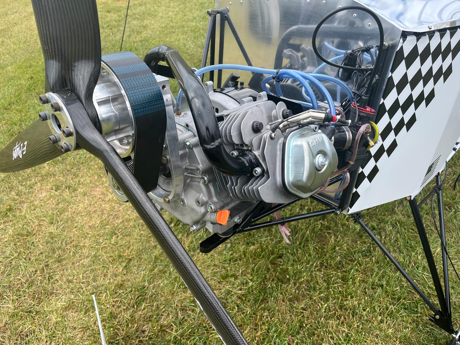

Badland Aircraft of Truman, Minnesota, premiered its F-1 (named for the Fujita tornado scale) Ultralight in 2015. Since then, they have sold 29 kits and have 9 aircraft flying. For the past year, Badland has been working on a new and more powerful four stroke engine for the F-1, based on a Honda single cylinder, 420cc industrial engine. Badland’s CEO, Chris Deuel, developed the engine using a custom cam, engineered crankshaft, roller rockers and titanium valves. He also designed, fabricated and perfected his own 2.55 to 1 re-drive for the engine. The result is a light and reliable powerplant that puts out just under 40 horsepower and 270 pounds of thrust, using a three-blade ground adjustable E-Prop.

Thump Air single cylinder four stroke engine, with Badland re-drive, based on a Honda industrial engine.
Deuel has run the new engine through 35 hours of reliability testing, 15 of which were in the air on the F-1. He could not be happier. He reports the “Thump Air “ engine is so powerful that he has to adjust the propeller to keep from exceeding the 55 knot ultralight top speed restriction. Duel also noted an 800 fpm climb in the F-1 with a 180 pound pilot.badland f1 img 1587
