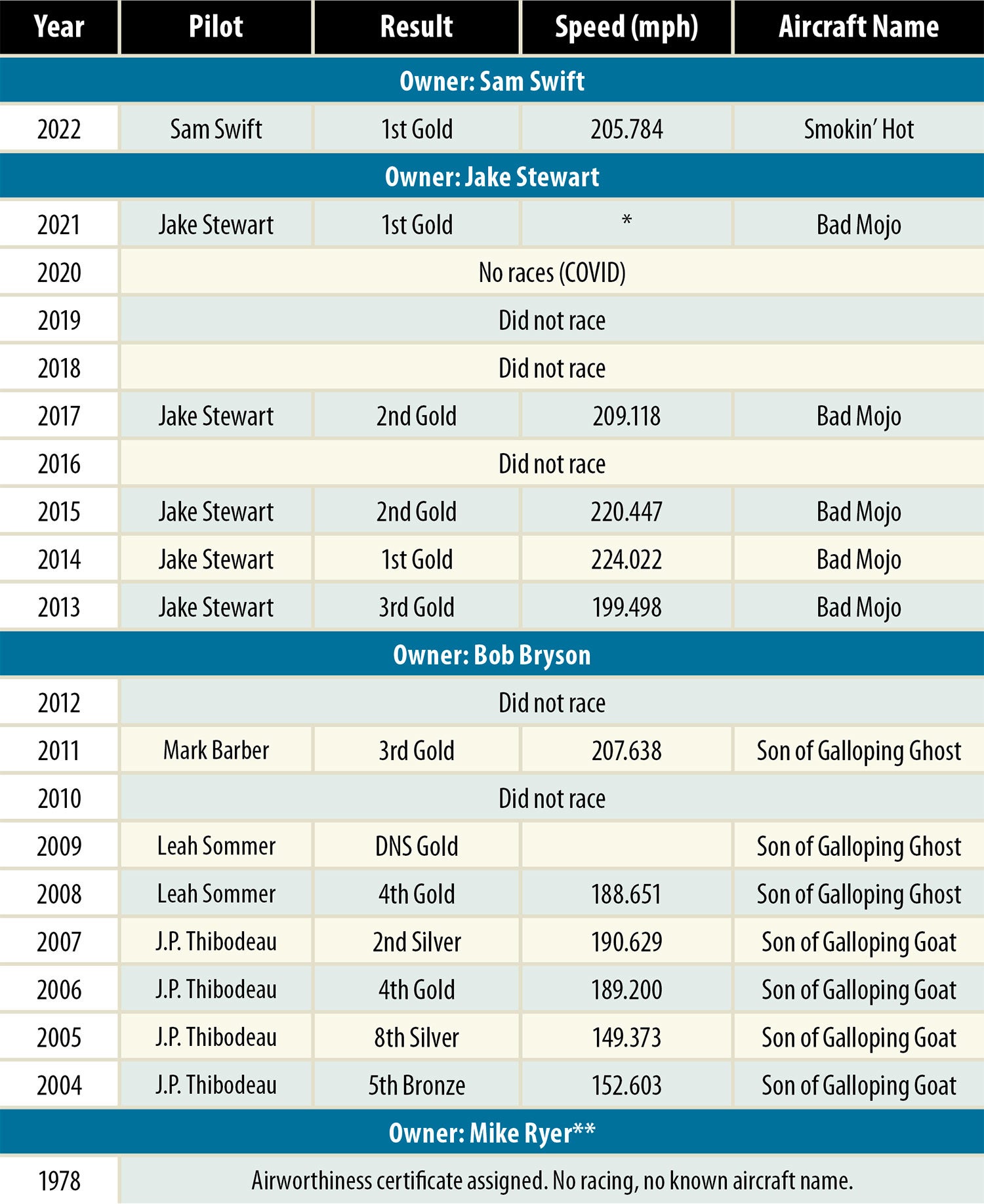

The story begins in 1978 when a young Mike Ryer was awarded a certificate of airworthiness for the Pitts S-1S he had just built in Boulder, Colorado. Ryer constructed his Pitts for strenuous aerobatics in contests and airshows and in 25 years accumulated 3000 hours on the little sportster before slipping away from hardcore acro. There is little written record of Ryer’s time with his stock, red S-1S sport plane, other than an August 27, 1981, mention in The Steamboat Pilot newspaper. Documenting a local airshow with a three-paragraph bit surrounded by huge display ads for mundanely local businesses, The Steamboat Pilot noted, “Mike Ryer flew his high-performance Pitts Special to the delight of audiences…” We bet Ryer got a kick out of it, too.
What is documented is Ryer sold the Pitts to Bob Bryson in 2003. Not a race pilot, but “a big time Experimental builder,” according to later owner Jake Stewart, Bryson was the first to bend the S-1S toward air racing. Not afraid to make notable changes, Bryson’s ambitions stopped short of piloting around pylons, and instead he had pilots J.P. Thibodeau and later Leah Sommer and Mark Barber tend the stick at Reno. During Thibodeau’s time the plane was whimsically Son of Galloping Goat; Sommers and Barber opted for the less cheeky Son of Galloping Ghost. Both names undoubtably played off the P-51 racer Galloping Ghost, iconic for its Cleveland appearances and later coming to huge grief when crashed into the spectator area at Reno in 2011. But that was in the future in Bryson’s day.

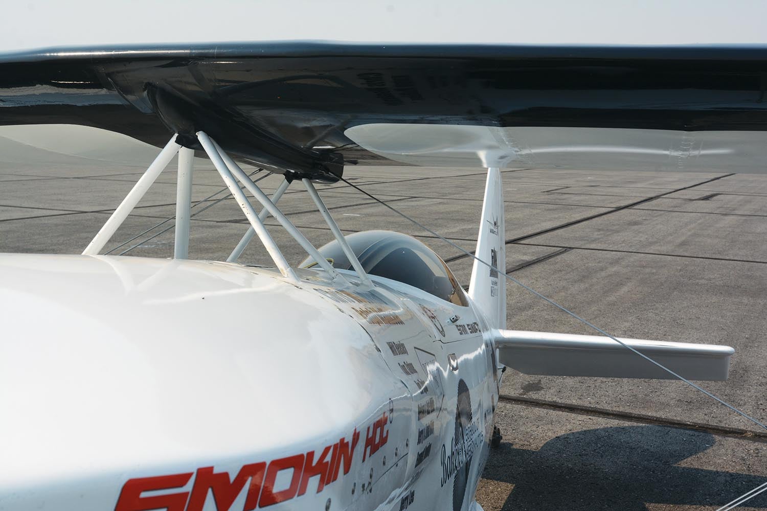

smokin hot pitts mojo 07
Payoff for the low canopy is reduced wind resistance through the choked cabane space. While there is a lot here with the cabane strut intersections, wires and much wetted area, the smooth transitions and general aero cleanliness of the build is also on display.

And it worked. Mounted in the ex-Bad Mojo (now Smokin’ Hot), Swift had the Biplane field covered last year and he took the Gold win at 206 mph. This was Swift’s first Biplane championship and the airplane’s third as it took the Gold in 2014 and ’21, both with Stewart, plus the 2022 win with Swift at the stick.
