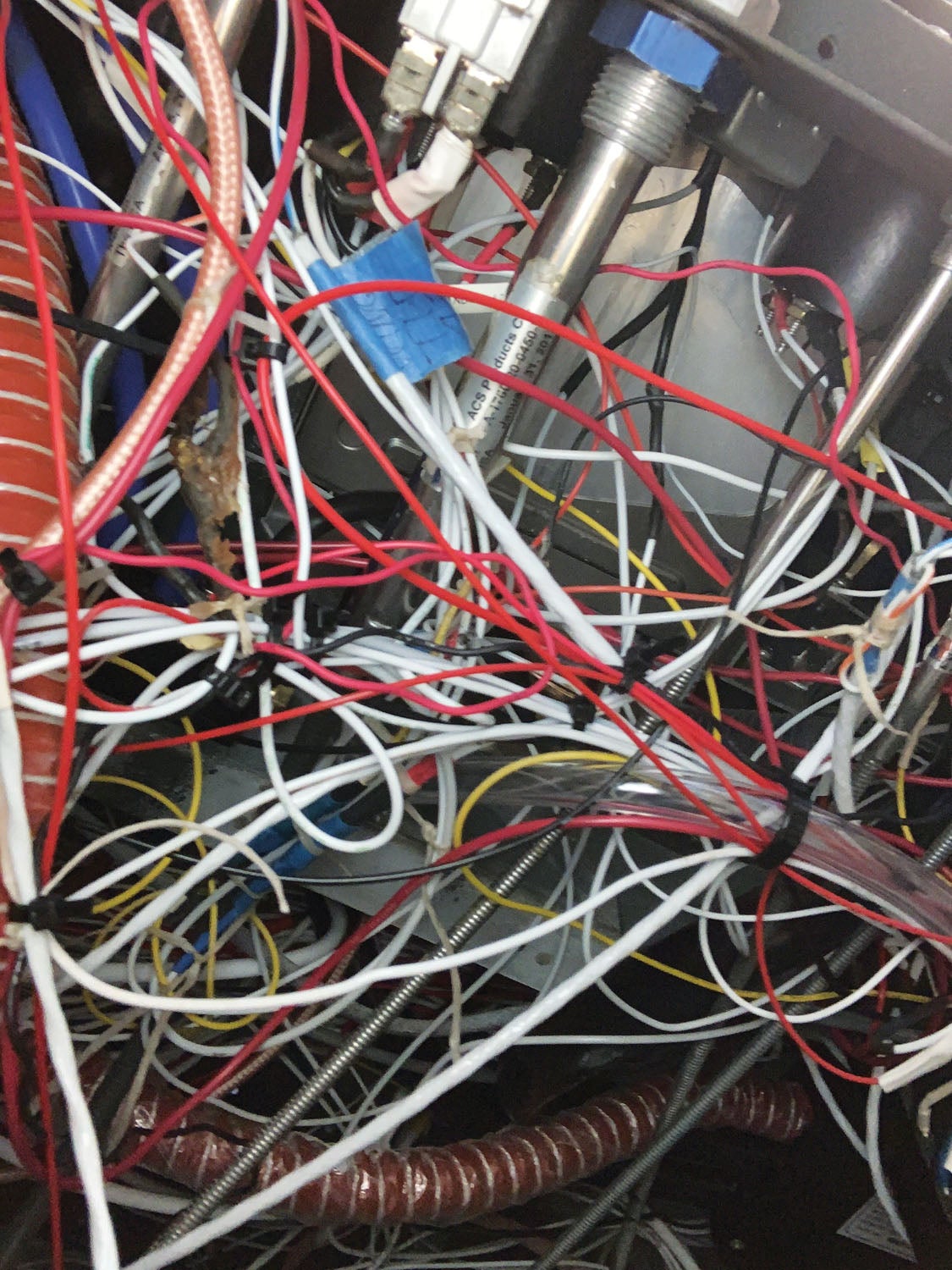

rats nest
Having a rat’s nest of wiring ensures a problematic aircraft for its entire life. Taking the time to organize and support all of the wiring goes a long way.
