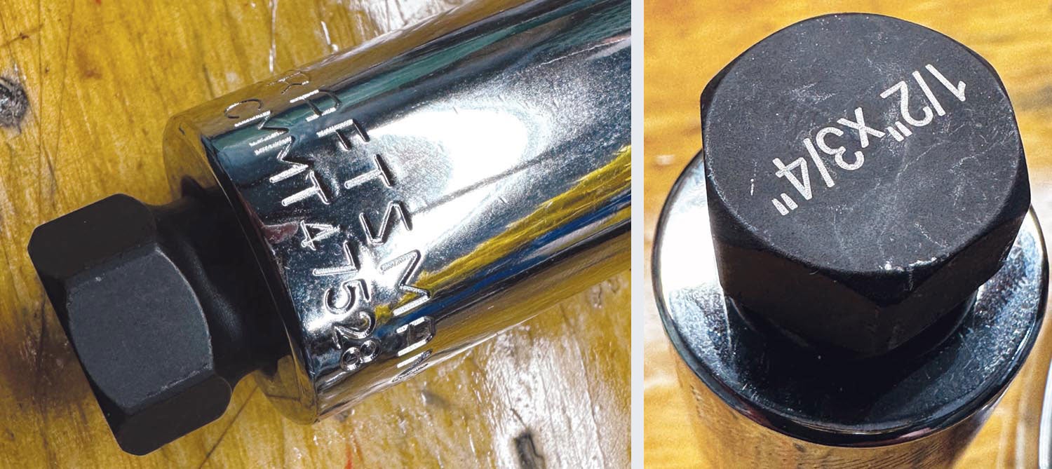

To make a crowfoot adapter for your deep socket, start with a short 1/2-inch bolt and a cheap 1/2-inch to 3/8-inch drive adapter.

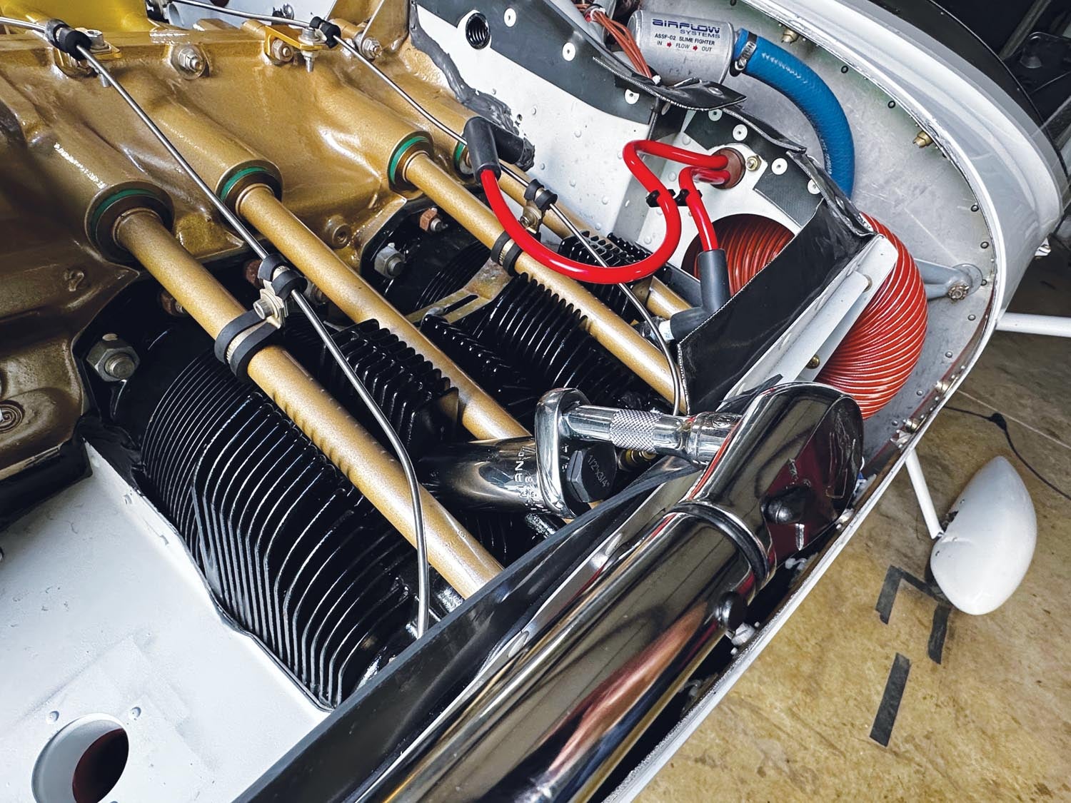

Of course, automotive spark plugs don’t just screw into a Lycoming engine—they are too small. Automotive plugs screw into a 14mm hole, whereas aviation plugs traditionally are 18mm. That means you’ll need an adapter for each plug, and these are usually supplied by your electronic ignition provider. They are generally made of brass, but some have been known to be steel. We’ve used both, but generally use the brass sets because they are more generally supplied.
Using an adapter means that there are two seals for every spark plug: one that seals the plug to the adapter and one that seals the adapter to the cylinder head. The first comes on the automotive plug and is generally a crush washer—hollow soft steel that crushes down when you torque the plug in place. While most mechanics will remove a plug and put it back in place again, the engineer who designed them probably considers these crush washers to be single use. I haven’t heard of problems (such as leakage or a plug backing out) from reusing them; I generally will only put one of these plugs in and out a couple of times. Again, they are cheap to simply replace.
The seal between the adapter and the cylinder head is accomplished the old-fashioned way—with a copper gasket. These gaskets come with aviation plugs (and can be bought separately by the thousands) and when new are in an annealed condition, which is to say “soft.” Using them properly (with a torque wrench) crushes them, providing a seal and adding tension that prevents the spark plug (or adapter) from backing out. Many mechanics routinely reanneal old gaskets and use them over, while many others declare that those who reuse them are just cheapskates—so why not use new ones every time? I personally reuse them sometimes because I enjoy the process of heating them up with a torch, watching them change color and then letting them cool down. Of course then you have to clean them to make them pretty…the whole process taking more time than simply buying a bag of new ones from Aircraft Spruce. It’s a religious argument; do what you’d like!

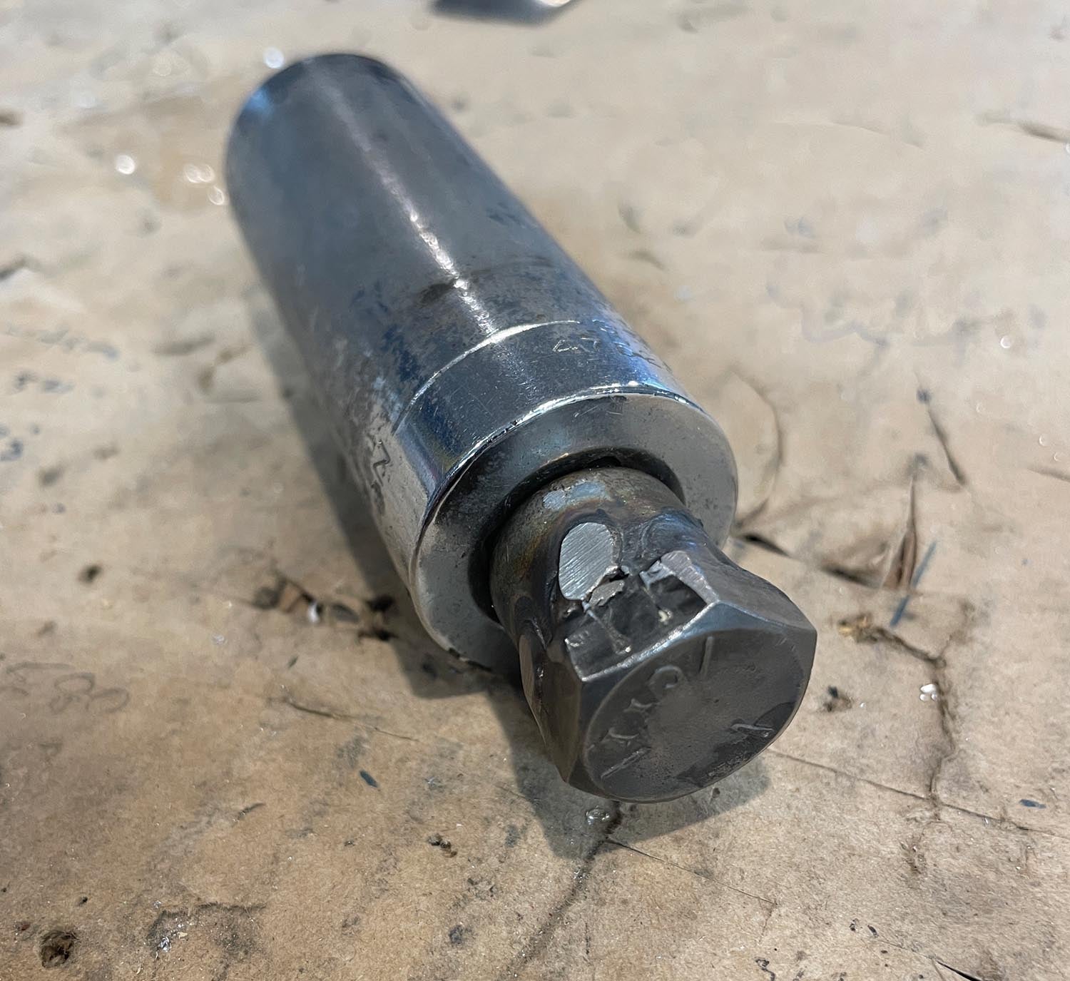

The modified bolt and shortened adapter nested together before welding (left). A little TIG welding and some touch-up with a file or grinder gives you a crowfoot adapter (right).
lycoming auto spark plug adapter 09
You can now use a crowfoot on your torque wrench to properly torque the spark plug adapters with the plugs in place.

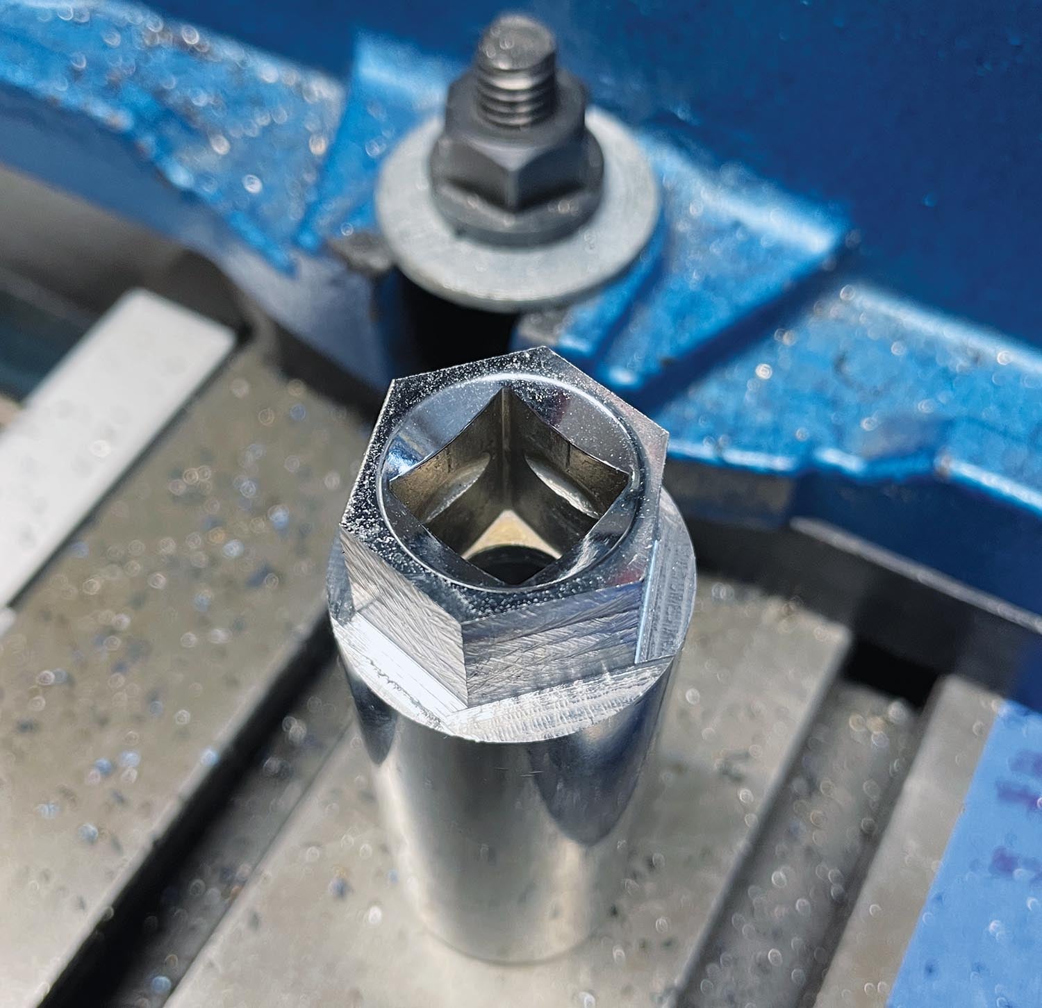

If you happen to have a milling machine, you can add a hex end to a deep 7/8-inch socket for a compact wrench that will work with baffling. Use a carbide end mill because the socket is very hard.

Four flats cut, two to go (left)! Using a square-drive socket cap in the end of the socket will help you line up each flat. A 1/16-inch shim will help you set the depth if the socket cap is ¾ inch and you want to end up with a 7/8-inch hex (right).

What we did was take a cheap 1/2-inch to 3/8-inch drive adapter and a short 1/2-inch bolt from the hardware store. We chucked the bolt up in the lathe and cut off all the threads, leaving a 3/4-inch hex head with a cylindrical 3/8-inch diameter shaft. We then chucked up the adapter and drilled out the inside about 1/4 inch deeper using a 3/8-inch drill bit. We cut as much off the open end of the adapter as we dared while leaving enough material to create a sturdy assembly, then cut enough of the “shaft” off the ¾-inch hex head so that it nested fully down into the adapter. Then it was a simple stop at the TIG welding table to join the two things together, and we had a 3/4-inch hex head to pop into the big socket. Use the 3/4-inch crowfoot on your torque wrench, and you’re ready to go.
An alternative is to use a mill to put “flats” on the end of the big socket and use the appropriate (larger) crowfoot directly on the socket. Essentially, it duplicates the configuration of a standard aircraft plug socket wrench that has both a ratchet drive socket and a hex head (usually for a 7/8-inch wrench) as well. This is easier if you don’t have access to a welder, but you have a friend with a mill—or you have a vise, a mill bastard file and some patience. You can start with a Craftsman CMMT47528 (1/2-inch drive, 7/8-inch deep socket—available at Ace Hardware or your favorite online retailer) and use a carbide end mill to do the work. The socket is very hard and it simply laughed at our regular (cheap) end mills that we use for aluminum. This solution gives you the best fit for top plugs where cooling baffles might be in the way, while also preserving the option of using a 1/2-inch-drive torque wrench directly. The spark plug and adapter fit snuggly inside this particular Craftsman socket.

Automotive plugs are a simple solution for experimental Lycomings when using any of the popular electronic ignition systems. They fire great with a factory gap of about 0.032 inch, and they are cheap so that you will never worry about maintaining them. I have heard less discussion about lead fouling with these plugs than in the old days, when everyone used massive-electrode aviation plugs. I don’t know if this is because people do a better job of leaning on the ground, the plugs are less prone to fouling or people just throw them away before fouling becomes an issue!
It’s hard to break the habits of decades of aircraft maintenance, but not having to clean and re-gap plugs is a boon to those of us that have spent years of our lives digging out little lead balls and sandblasting expensive plugs. I first used the BR8ES in two-stroke jet skis, where the tuning process was to run the engine hard, then pull the safety lanyard off at high rpm, killing the motor instantly and preserving the combustion signatures on the plugs. You pulled the plugs, looked at the color of the deposits, threw the plug away, retuned, put in a new plug and did it over. Yeah, we went through a ton of plugs, but they were even cheaper back then.
