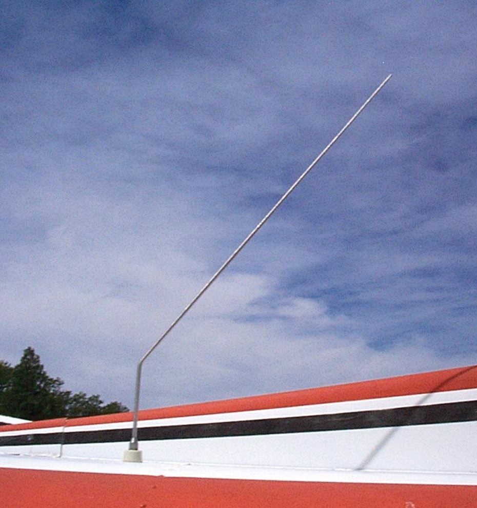

antennas according to jim 2 02 e1564960446899
A vertical com ground plane mounted near the vertical stabilizer. Note how the side of the fuselage (ground plane) slopes to vertical almost immediately. This will provide good coverage to ground stations.

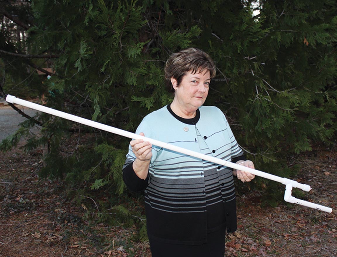

antennas according to jim 2 01
The author’s personal editor holding a copper tape dipole inside of a weatherproof radome (plastic water pipe). This will be a vertical com-band antenna using the right-angle mount by the editor’s left hand.

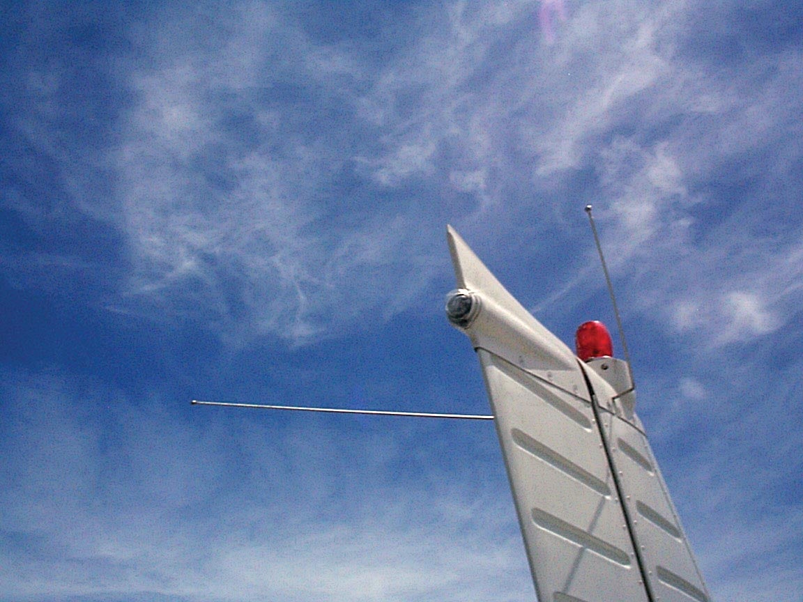

antennas according to jim 2 04
A horizontal “cat’s whisker” VOR/LOC antenna mounted on the top of the vertical stabilizer. This particular antenna will have best reception to the aft of the aircraft.

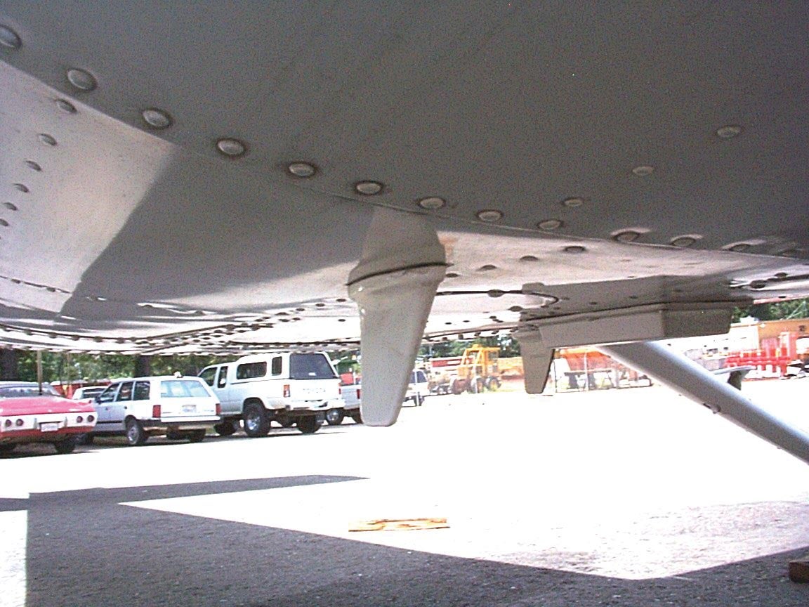

antennas according to jim 2 05
A broadband transponder antenna. Almost all of the radiated power will be directly down to the ground station.
