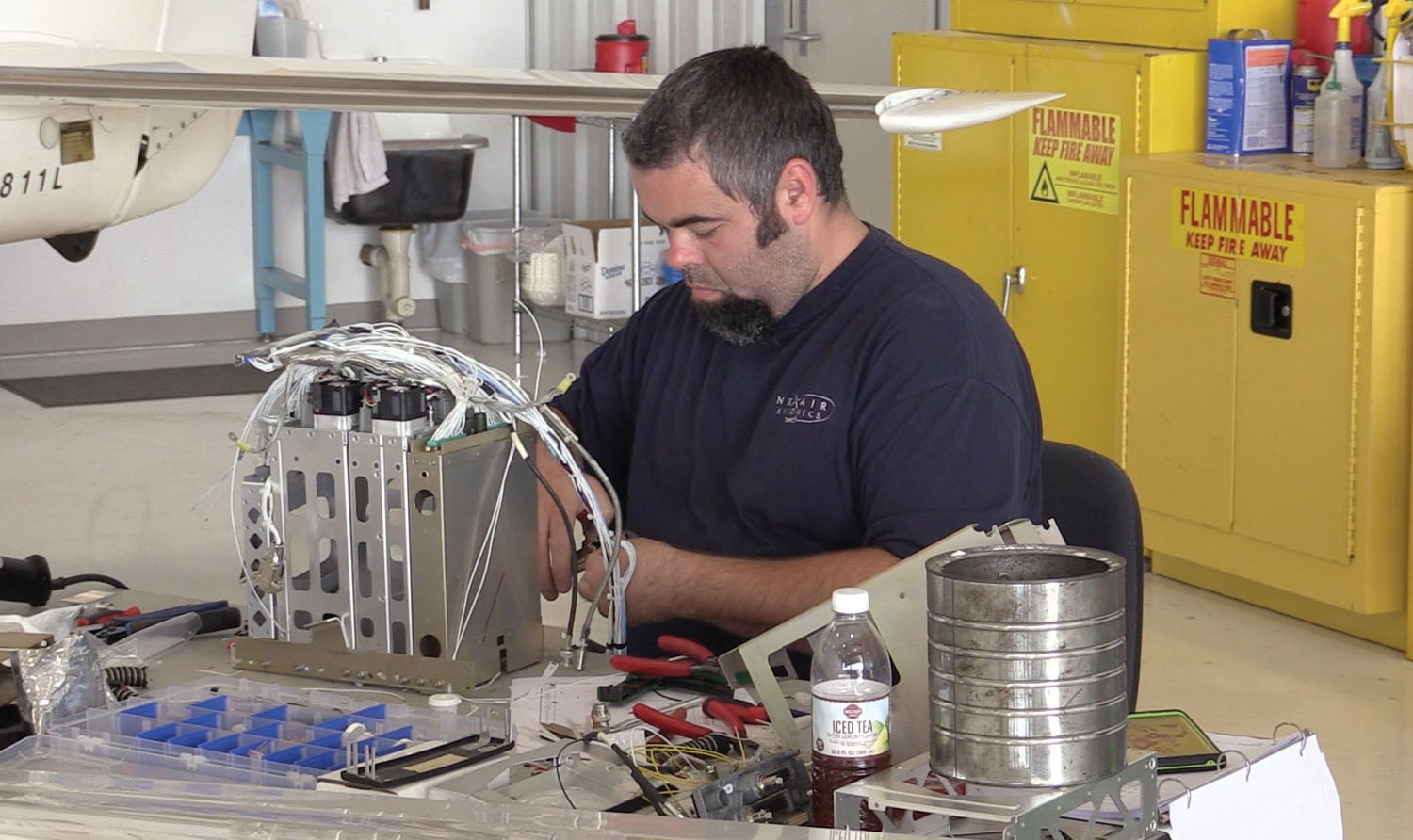

Here a tech at NexAir Avionics in Massachusetts wires a stack of Garmin gear on the bench—a considerable amount of bundling you want to get right the first time.

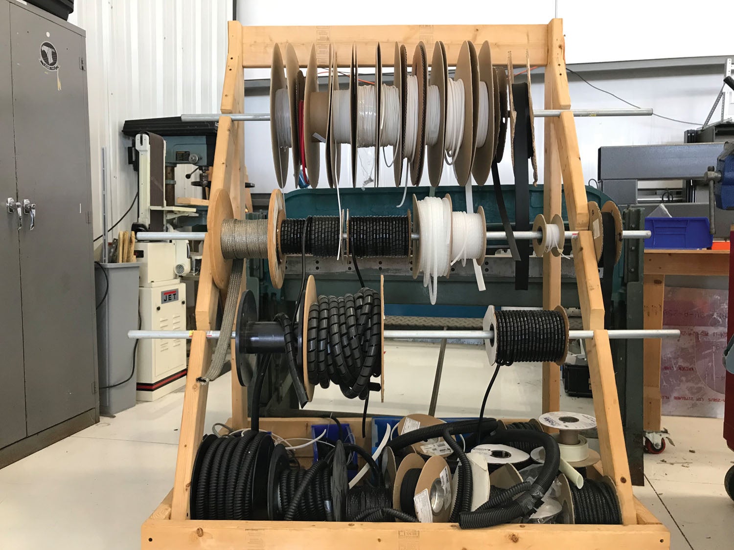

It could make sense to source your own spools of cable, even sharing the cost with another builder. Shops generally don’t like parting with their own wire.
