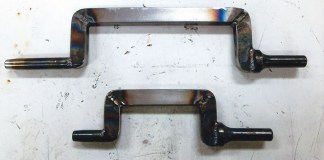

The counterbored end was lathe turned to be a slip fit over the axle threads. The two guide holes were located 0.375 inch from the center and drilled using a #29 twist bit (the tap drill for an 8-32 thread).

Sketch of the drill guide. The center was spot drilled on the lathe to make it easier to reference the center for drilling the two guide holes on the mill.

With the cotter pin removed and the guide held firmly against the end of the axle (left), the first hole was drilled. A spare #29 drill was inserted in the first hole to prevent the guide from rotating (right) before the second hole was drilled. Both holes were just under ½ inch deep, which was set up to be when the chuck jaws bottomed out against the guide.
The two options were to hand drill them in place or jack the plane up and remove the axles and take them to the drill press. I suggested to Kevin that, with a drill guide, we could do just as good with a hand drill as a drill press and save a lot of work. To be sure, it was “just” four holes, but even if it were only one, if I wasn’t 100% confident the job would be on par, I would have suggested taking the axles off regardless.
After taking the basic dimensions of the axle (diameter, length of exposed thread and the position of the hole for the cotter pin) and rummaging through the scrap bin for a suitable blank, I sketched up an idea for the drill guide.

The most basic feature of any drill guide is that it must be able to stabilize the drill square to the work. To do that, a guide has to be long enough to thwart the bit from flexing or tipping. At a minimum, it should be at least four times as long as the drill diameter and, if possible, longer. In fact, the longer the better. Another consideration is how to hold (or clamp) the guide in place. Since this was going to be a handheld guide, some extra length was added to the design. In fact, I made the guide long enough that I could set the bit in the drill chuck and drill the hole to full depth (1/2 inch) using the guide as a depth stop against the drill chuck.
