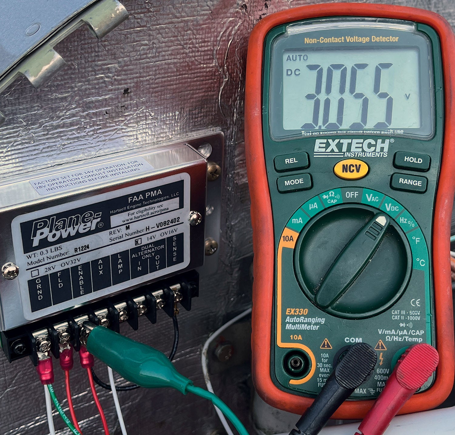

Field voltage measurement
The measured voltage at the Enable pin on the external regulator shows 3.055 volts. One should expect to see battery voltage (approximately 12 volts) here when the alternator is powered on the ground and not running. This was a sure sign that something was not right on the cockpit side of the wiring.

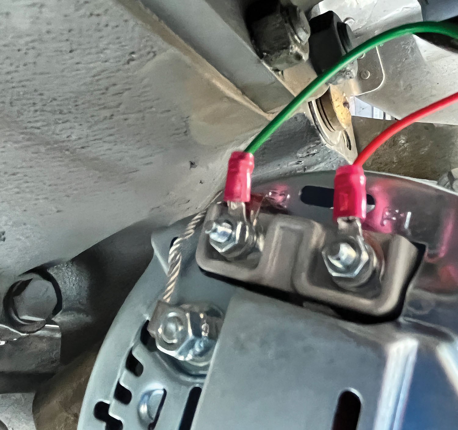

New alternator connections
The new alternator had two threaded terminals instead of a molded connector, which had two jumpered wires. The left terminal of this alternator requires a ground and is already grounded to the case. Connecting the jumpered field wire to it caused the field wire fuse to blow but went unnoticed by the installer.
So now the chain continues. Anyone who has changed alternators recently knows that many of the manufacturers have changed the field connector over the years. It’s usually no big deal to cut the wires and splice the new connector into the circuit. Many of the connectors have a wire jumpered across two pins on the connector. The new alternator had two threaded terminals, so it seemed logical for the owner to connect the field wire to both terminals. He called and said the alternator was still not working.
I looked at the texted picture of the new alternator and realized that one of the terminals needed to be tied to ground, not to the field wire. He did that, and it still didn’t work. He also assured me that there was power on the field wire. Hmm…it seemed as though he may have received a bad alternator, so he got another one and it still didn’t work. Now I needed to dig in a little closer, still all remotely, of course.

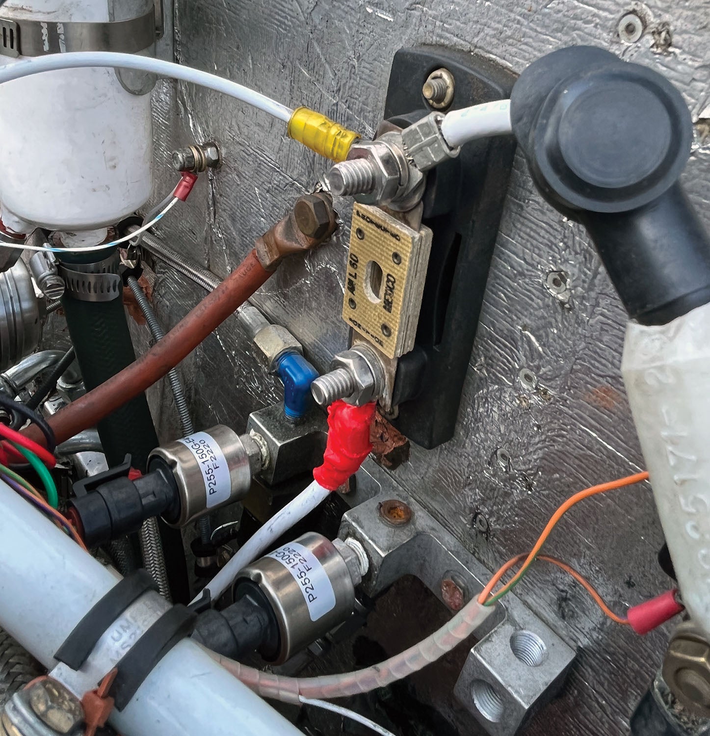

alternator tie in
Since the main and standby alternators were electrically connected on the firewall side of the aircraft, and the standby alternator was working, I was confident that the cabin side of the alternator output circuit was OK.

Alternators are very simple in that they need power applied to the field for them to generate power. So, the first thing I always measure is the field wire. In this case, he had installed the regulator right on the firewall, with easy access, and I measured the voltage at the Enable pin, which should be the wire coming from the alternator switch in the cockpit. The meter showed 3.05 volts. Well, it sure isn’t going to work with that voltage level, as normally on the ground you will have somewhere around battery voltage at the field wire, approximately 12 volts. In flight, once the battery is charged, the field voltage will taper off to some lower steady-state voltage. As a matter of fact, what had been bothering me during our back-and-forth troubleshooting was why the alternator had not “run away” prior to the regulator being installed.

Another tidbit that made the troubleshooting quick and easy for me is that the standby alternator was working. Since they are both electrically connected on the firewall side of the aircraft, I was immediately convinced that everything on the output side of the alternator aft of the firewall was intact.
