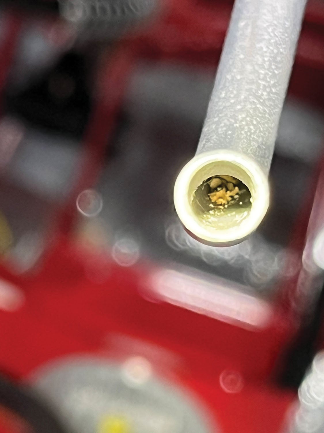

When troubleshooting pitot problems, be sure to disconnect the tubing from the aircraft, and do not blow into the system. In this case, I disconnected the tubing on the back side of the pitot tube and verified it was plugged by the inability to force a cable tie through the pitot tube. It took a 10 AWG wire to break up the obstruction.

I checked the ground speed on ForeFlight, and it was reading 75 knots. The view out the canopy confirmed to me I was doing 75 knots or so across the ground. I know, some of you are already wondering how I can tell the groundspeed visually. Well, I’m much lower in the helicopter at 700 feet, as opposed to an airplane at 3000 feet, so yes, it is easier to recognize groundspeed.mud daubers
This was getting interesting now. I decided to do a quick 180° turn and check the groundspeed against the airspeed. The groundspeed remained at 75 knots, but now the airspeed was reading 50 knots! I finally decided I had an indication problem. I was only 5 miles from home, so I told myself to just use the normal power settings and use the groundspeed indication to keep it above 51 knots until over the runway. Helicopters have a height velocity envelope, which you need to maintain to properly execute an autorotation in the event of an engine failure. Yes, you can hover out of ground effect at some very high altitudes, but it leaves you pretty exposed if there is a powerplant or drivetrain failure.

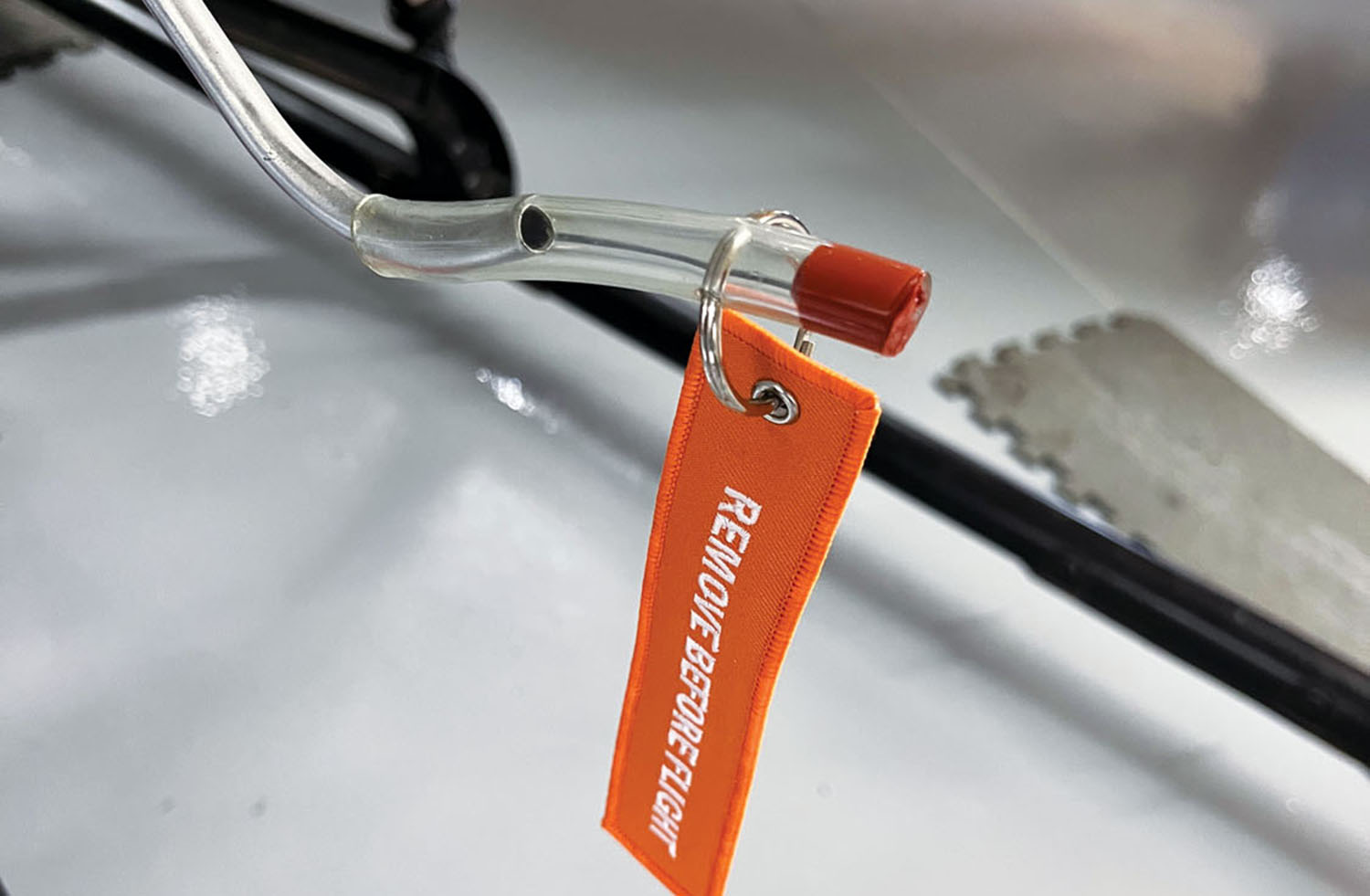

pitot coverEverything worked out fine, but I sure was curious. I convinced myself it could be a plugged pitot tube, as it is that time of year in the Southeast for mud daubers. Once I landed and pulled it in the hangar, I shined a flashlight into the pitot tube. Sure enough, I could see little bits of dirt way down inside. I disconnected the tubing from the aft side of the pitot tube and tried to force a cable tie through the tube, to no avail. It took a stiff piece of 10 AWG wire to clear it, followed up with some compressed air. I then reconnected the tubing and connected it to the pitot-static tester, which now showed a fully functioning airspeed indicator in the cockpit. Yea! I also now have a pitot cover for it. In 31 years of flying in Georgia, that is the first mud dauber that has found any of my aircraft pitot tubes. I’m thinking it won’t be the last, as I have heard many other pilots complain about them.
