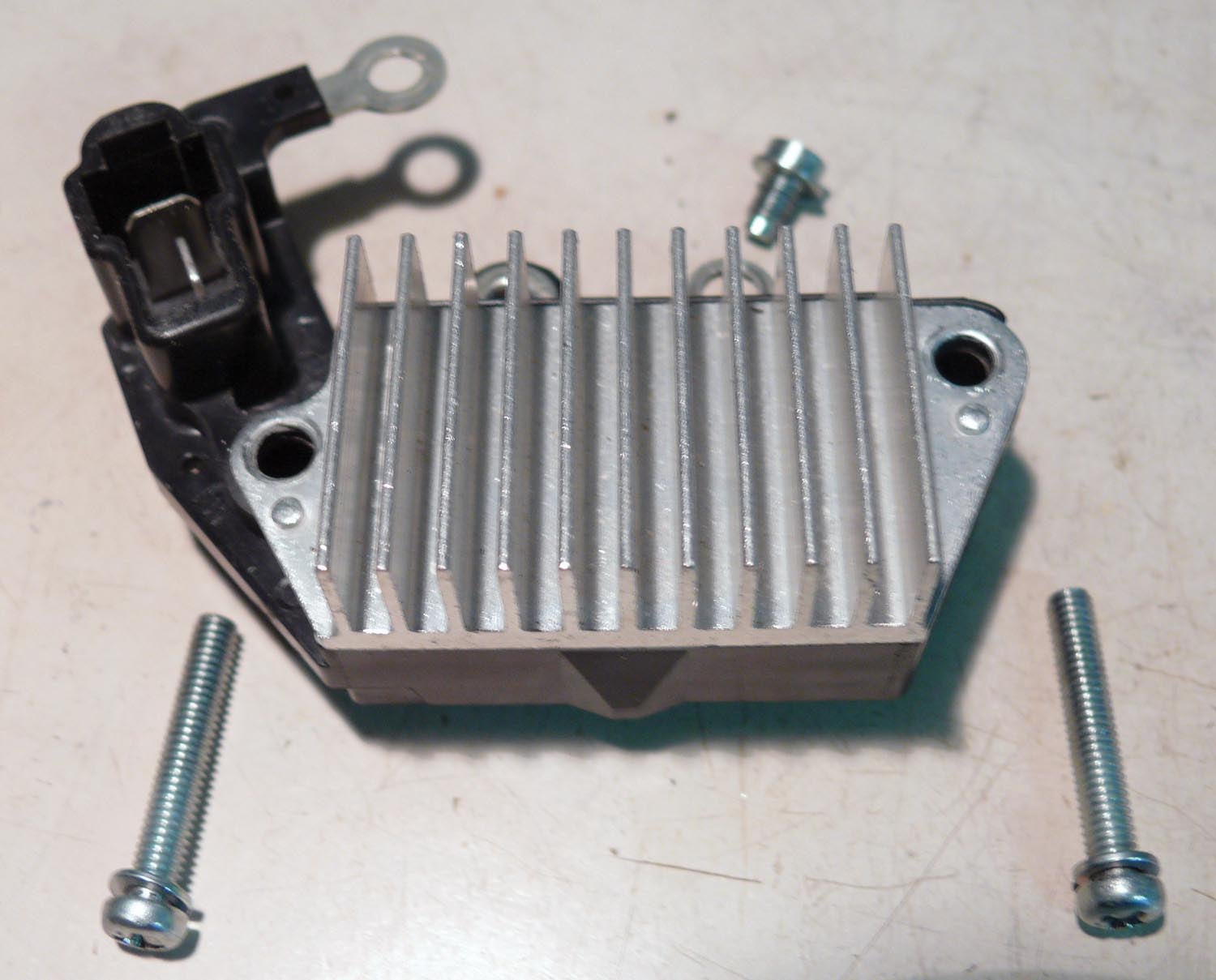

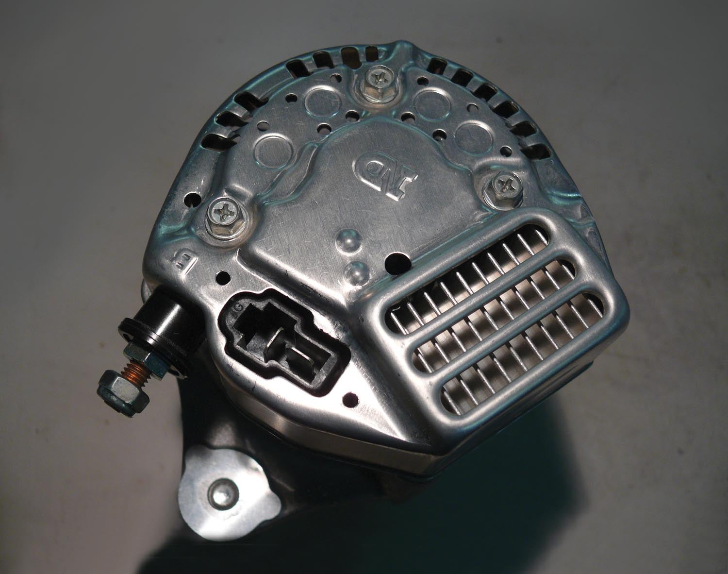

Starting with the standard alternator, remove the terminal shroud and end cover to expose the brush holder and regulator. Next, remove two screws to release the brush holder, then remove three screws to release the regulator. The two long screws will be reused, but the third screw is not used again.
Nippondenso alternator 02
Remove the terminal shroud (left) to expose the brush holder and internal regulator.
The only (tiny) modification to the alternator is to ream out the left-hand mounting hole of the brush holder to 5 mm. As mentioned earlier, this will not prevent the alternator from being restored to standard. This minor mod is necessary as the wire to this terminal on the brush holder must not contact the frame or output terminal of the alternator, or the magic smoke will escape!

To release the regulator, remove three screws.
The new components are two M4x10-mm screws; two fiber washers with 4-mm holes; one small piece of nylon tube (or equivalent), OD 5 mm, ID 4 mm, and a length of 1.5 mm; and two 18-gauge terminated wires.
A mounting block (phenolic, canvas Bakelite, etc.) replaces the regulator with three holes: two for the original mounting screws and one with a captive nut to become the right-hand mounting point for the brush holder. This block is 1/4-inch thick and precisely replaces the regulator after being cut to shape. I used two 1/8-inch thick pieces epoxied together and holding the nut. Alternatively, use a ¼-inch block, drill a 3.3-mm hole, and tap for M4. Mount this on the alternator, and put one fiber washer where the left-hand brush holder terminal was attached.

Fit a rubber grommet to the opening on the alternator rear cover, thread the wires through, and refit the screws and terminal shroud that were previously removed. Be sure to protect and terminate the two wires as necessary. An alternative to having wires coming out of the cover is to mount a Molex-style terminal in the cover, and attach it with two pop-rivets.
Done! And remember that the alternator can be returned to the standard configuration at any time.
