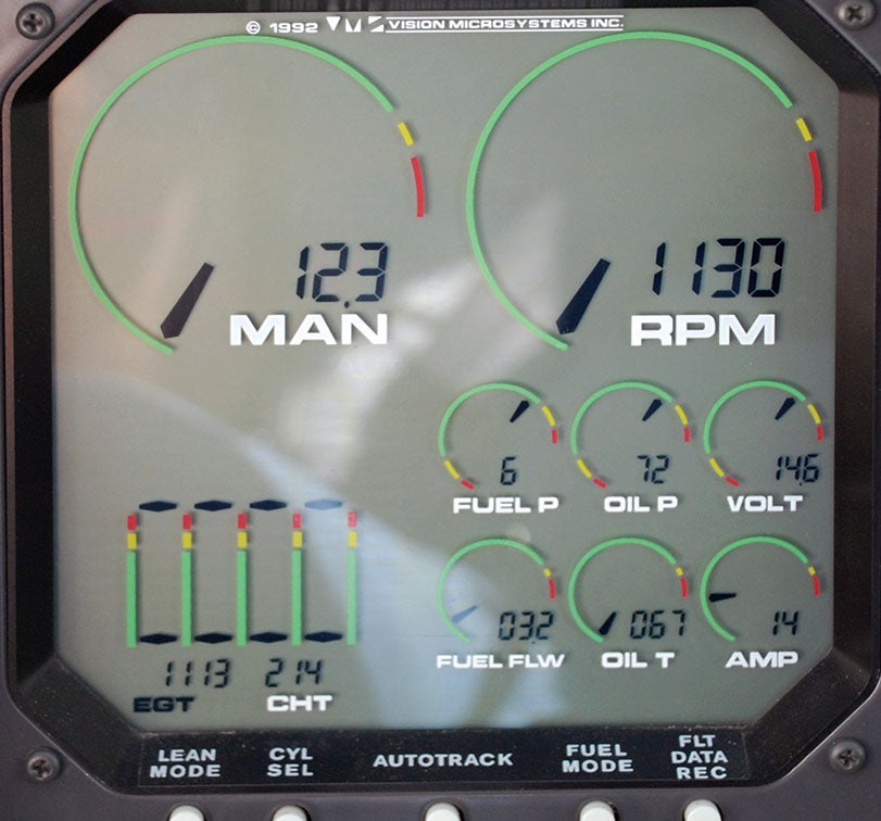

This engine monitoring system shows a charging voltage of 14.6 volts, which is a little high and may indicate excessive resistance in the field circuit.

Normal readings should be around 14 volts for a so-called 12-volt system. This is because the voltage output of the alternator must greater than the battery voltage or current will not flow into the battery, which on its own should produce about 12.8 volts when fully charged. If you normally see system voltage that is above 14.5 or below 13.8 when flying, you need to find out why. Too little voltage will not charge the battery properly and too much voltage can damage it permanently. When the alternator fails, system voltage will drop to battery voltage, which will be at 12.8 or less, and declining as the battery loses charge. At somewhere around 9 to 11 volts, your electronic instruments and radios will cease to function. This will vary from one device to another and is a number that you should know for your equipment, especially if you fly IFR. In the case of radios, transmitting will fail before receiving because just keying the mic will cause system voltage to drop a bit. This is why a voltmeter is required with electronic engine monitoring systems. The best insurance against a total alternator failure is a backup power source, which is now standard or at least an option with most electronic displays.
A slight increase in voltage may indicate resistance building up in the field circuit for some reason. A corroding connection or a partially broken wire could be the cause. The failure of one of the stator coils could also cause voltage to rise. The important point is that just as decreasing voltage is bad, so too is increasing voltage. If it changes, there must be a reason.

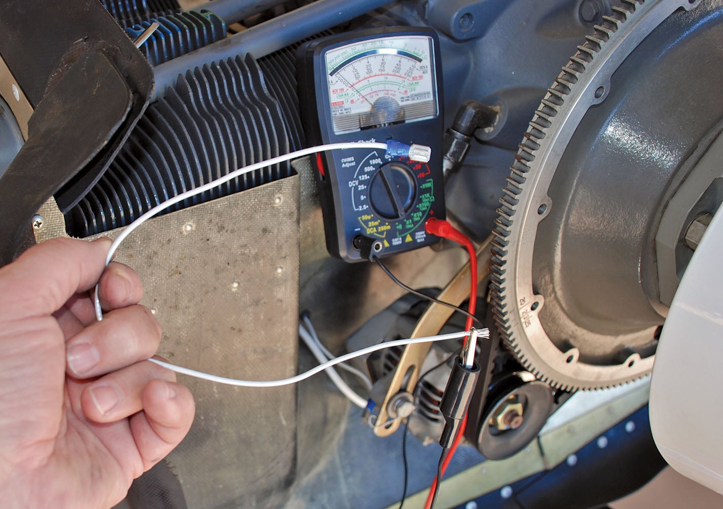

alternator belt tensionUse a torque wrench on the pulley belt and adjust the tension so that you get the specified torque just as it starts to slip. Turn the pulley nut in the tightening direction so you don’t risk loosening it. Reference: Lycoming Service Instruction 1129D.

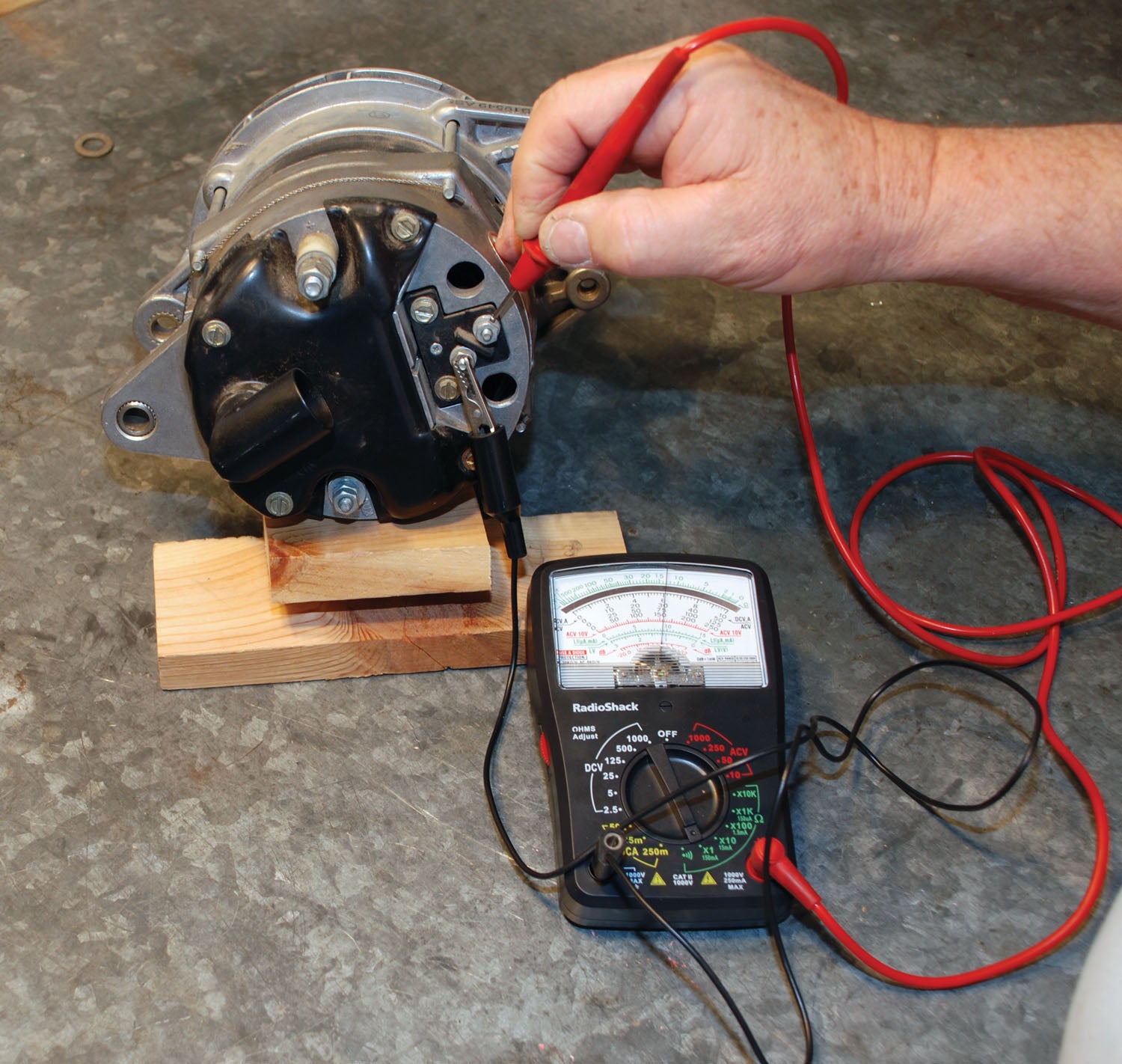

On alternators with F1 and F2 terminals, you will need to connect one lead of the meter to each terminal. The resistance reading is a little high because this alternator has been sitting on a shelf for several years. Some regular use should remove the oxidization from the brushes and slip rings.
If the alternator just stops charging, the first thing to suspect—assuming it isn’t making some terrible noise or hasn’t blown the main breaker—is the field. If you are not getting 12 volts or more to the field terminal of the alternator, you are not going to be making electrical power. Check the connector at the alternator, the wire, the voltage regulator (if you have an external voltage regulator) and then the ALT side of the master switch. If you don’t have 12 volts at all of these points when the master switch is turned on, find out why and fix it. Loose connectors can be the toughest problems to find, so be sure to tug on each one to make sure it is secure. If the field breaker has popped, suspect a chafed wire making contact with the airframe somewhere. Trace the entire path of the field wire until you find the short.

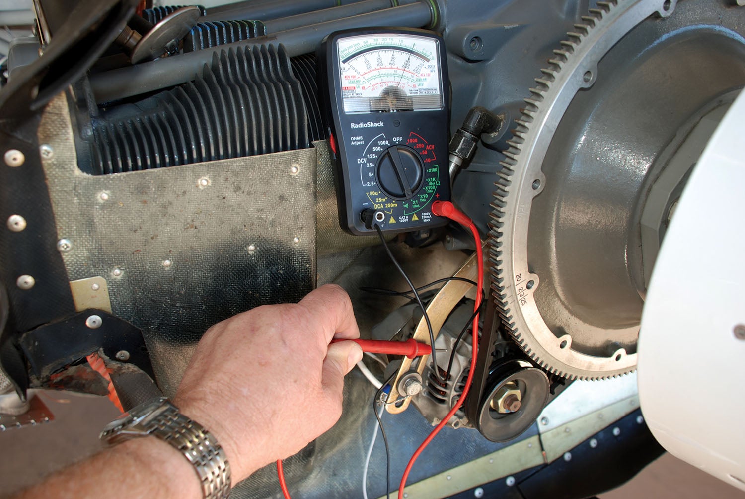

A short from the field to the alternator case inside the alternator can also cause the field breaker to trip. Disconnect the wire from the field post of the alternator and use your ohmmeter to check for a short by placing one lead on the field terminal and the other on the alternator case. If there is no or almost no resistance, you have a short inside the alternator. You should expect to see at least 4 to 6 ohms between the field terminal and ground, assuming a 12-volt system. In some cases, the field is not internally grounded. You can tell this by the existence of two field terminals on the alternator (usually marked F1 and F2). In this case, measure resistance between F1 and F2.
In other cases, you may have a poor connection between the brushes and the slip rings inside the alternator. To track this down, disconnect the field wire and the alternator belt. Then turn the alternator over by hand while checking resistance between the field post and the alternator case (or F1 and F2 if that’s your configuration). If resistance is consistently high, the contact between the slip ring and the brushes inside the alternator is not good, which means the alternator needs to be repaired. You may be able to cure this problem by using a fine Scotch-Brite pad on the slip rings. If you have an open circuit across the field (infinite resistance), you may have brushes that have fallen apart or a broken wire in the field winding. Time for some major alternator repairs.

It can be quite difficult to gain access to some field connections on alternators installed in airplanes. Here a pigtail has been made to make checking resistance easier.
Because of their extremely low operating current, digital multimeters do not do a good job of measuring resistance in the field circuit, so it is best to use an old-style analog meter for this. Even if you get a reading of 50 ohms or so there is no reason to panic. Spin the alternator a few times and see if the resistance goes down. You may also notice that the reading varies as you spin the alternator. This is pretty common and not necessarily a reason for concern if the alternator is otherwise working well. A thin layer of oxidation on the slip rings can easily produce some extra resistance. Higher resistance indicates a possible problem worth further investigation.

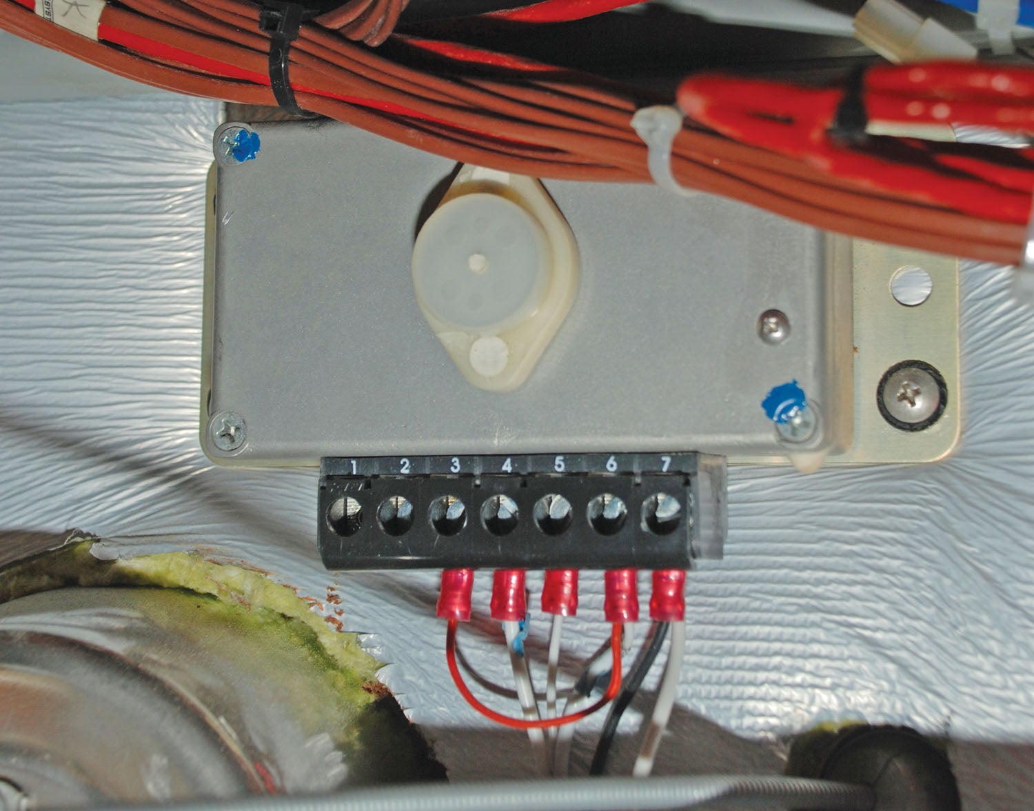

alternator voltage 03
This airplane uses a B&C solid state voltage regulator. It will work better if it is installed inside the cabin (as it is here) instead of in the engine compartment. One advantage of the B&C regulator is that the voltage is easily adjustable.
If the field wire and the alternator wire short against each other, you will get a potentially very damaging overvoltage situation. A partial stator failure can also cause the field to trip if it has caused an overvoltage spike. Make sure all wires are properly routed and secured so that they can’t rub against each other. The price of this mistake can easily run into the thousands of dollars. To guard against this, make sure your alternator has built-in overvoltage protection or use a voltage regulator that does. Rapid loading or unloading of the alternator can also cause overvoltage surges. Some of the current models of Plane Power alternators have internal overvoltage protection, but others do not. Be sure to find out if this is included in your alternator. This is especially critical if you are using a lithium battery such as the EarthX. These batteries have their own overvoltage protection, but a runaway alternator can overwhelm that protection in extreme cases, possibly leading to disastrous results. (By the way, do not fail to install the battery warning light that comes standard with an EarthX battery if you have one in your plane.)

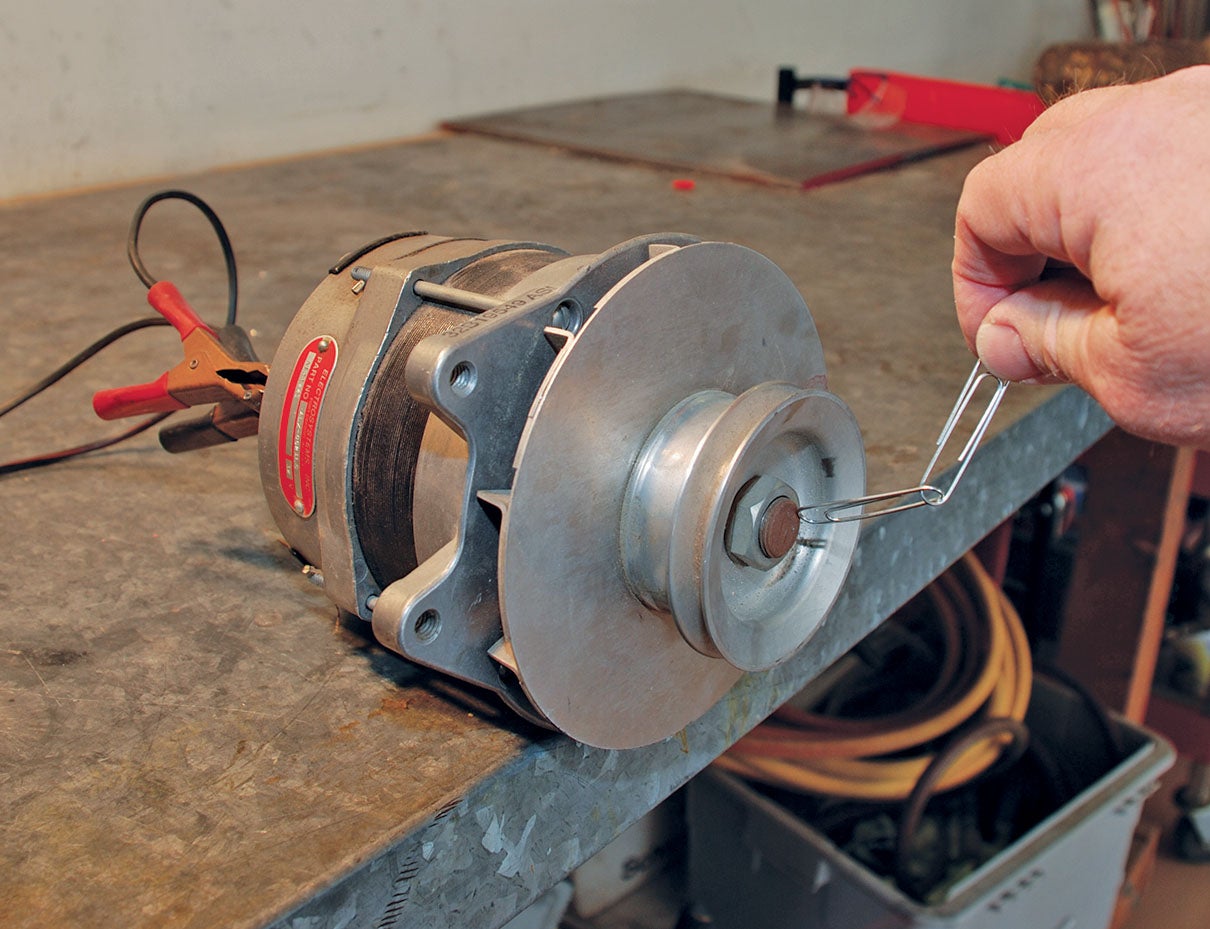

A quick test to see if the field is working is to power up the field and see if the rotor shaft is strongly magnetized. A tester made up of two paper clips shows that it is.
