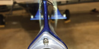

Every hangar or shop needs shelving. Shelf brackets are an easy project. These are 7 inches by 5 inches with a ¾-inch-wide flange. The converging corner was welded, but you could make an overlap and rivet the joint if you don’t have access to a welding machine.
AEPs can be anything, made from anything and as simple or complex as you want. They can be functional or artistic and usually start out from scrap material or surplus parts. While it’s cool to make an AEP out of 100% scrap or surplus, there are, of course, no rules. For example, if your AEP needs a base or a frame or whatever to make it more appropriate to, say, display in the house instead of the shop, then by all means make a special base.
The same goes for drawings. Most AEPs are freestyle projects with no drawing or plans. You just start making them and see how they end up. But if you get into it and decide that a sketch will help, by all means do a sketch. The shelf brackets shown here are a good example. The brackets themselves were made freestyle, but the decorative silhouette took some figuring and playing around with my CAD program (Solid Edge) to make it work.
Shelf brackets are an easy AEP. All you need is some scrap sheet metal and a bender. Make them whatever size you need, small and short for storing small parts or big and long for bulky items. The shelving can be 3/4-inch plywood or 2x6s. Use whatever you have. If using plywood, keep the length reasonable for whatever you intend to store on the shelves. Plywood will sag pretty easily if you overdo it.
I made several sets one afternoon because I needed some shelving to inventory miscellaneous aerosol cans, containers and parts that were in boxes on the floor. I used sheet metal screws to attach them to the corrugated metal siding of the hangar I used to rent. The outline of the airplane was incised using a plasma cutter before bending. The idea, of course, was to add something to make these otherwise simple brackets special. Absent the plasma cutter, I could have added similar artwork any number of ways, from painting the outline to using a sticker or even drilling a bunch of small holes to get the same effect.
