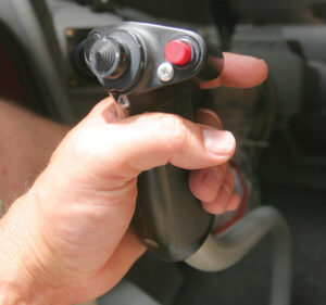

pitch control 594MAYDAY! MAYDAY! MAYDAY! No elevator. No elevator. Im going down. These are the chilling words from the NTSB report documenting the fatal crash last year of an amateur-built airplane. Wreckage examination revealed the elevator had disconnected from the longitudinal control system. The electric pitch trim motor was functional, but trim position at the time of the crash could not be determined.

Flaring to land with an inoperative elevator control system will require full use of trim and power manipulation. Don’t ever practice this for the first time near the runway; run trials at altitude first.
