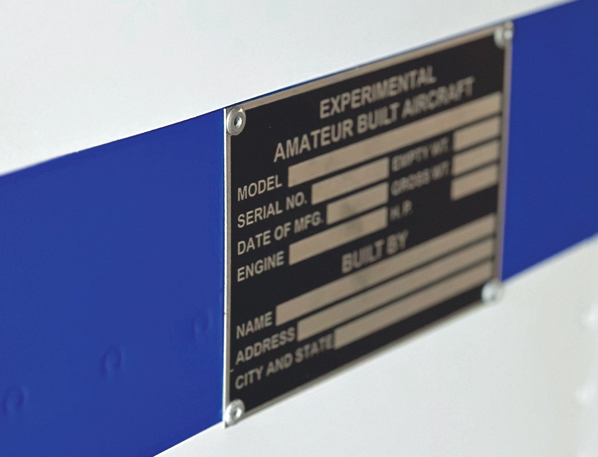

Data PlateWhen the FAA inspector or DAR (Designated Airworthiness Representative) arrives to award you your airworthiness certificate, it’s likely that everything will go smoothly, right? After all, you’ve followed all the checklists and performed your due diligence. It might not go well. Reports of certification success are all over the map. Why?
For a pittance, EAA sells a comprehensive kit for certifying your Experimental aircraft. It contains detailed instructions, forms, placards and checklists. If this is your first build and you’re not using it, you’ll spend more time getting all the details together. Success insurance, right? Maybe not. Here are the top reasons for certification failure.
Paperwork
When I went to training to become a DAR, one thing was emphasized repeatedly. Paperwork. It has to be perfect. When I say perfect, I don’t mean close. Think of it as a computer, where one stray letter or number can stop everything. You’re already familiar with this in your other interactions with the FAA. When we inspect your airplane, if the paperwork isn’t correct, everything comes to a halt. Every item, from the eligibility statement to the registration and the data plate, has to match perfectly.
When you’re pulling this together, it will help to have others look at your paperwork. They are more likely to find errors than you are. Look for legibility, matching info, spelling and dates.
