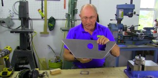

If you are going to have a panel cut, the easiest way to ensure precision is to do a layout in CAD. For the computer-savvy builder, this is simple—for the rest, it is easily done by an avionics shop or whoever is going to do the cutting.
Continuing our series on upgrading your panel, this month we’ll take a look at some hints to make the layout portion of your project easier. We’ll also take a closer look at what’s involved with “minor” and “major” surgery for your instrument panel.
Plan, Plan, Plan…
Before you begin any sort of cutting, removing or other modifications, it’s important to take some time to figure out what you’re going to do. That means doing at least a rough layout of what your panel will look like. The easiest way to do this on a budget is to simply do the “paper doll” thing and tape life-size pictures of the new components to your panel. This will allow you to play with things for a bit in order to determine where they best fit. If your upgrade is going to be a bit more involved than a simple or singular instrument, then perhaps doing a full layout in a drawing program (like Visio, Photoshop, CAD, or one of the panel planner systems) would be a good investment of your time. Many times, if you’ve decided to have an outside shop cut a new panel for you, they will do the layout for free or at an extremely good price.
Modern CNC machines can easily and precisely cut new panels. Builders can do the same thing with drills, punches, saws, and files at the expense of time and effort. The trade is up to the individual.

Before we dig into the differences of minor versus major surgery, it’s worth noting that in either case, it’s often easier to have a new panel cut, rather than trying to salvage the old one. There are a number of folks out there who can cut a new panel that includes the necessary modifications for new equipment, yet also matches the placement of existing items. The cost is usually in the $200–$500 range. You then have to remove the old panel and insert the new one. A quick search on several popular Internet forums has many posts dedicated to such endeavors. For those of you with planes where the panel is harder to remove, there are also additional options, which we’ll discuss in further detail.

A new panel can be economically cut to replace an old one, oftentimes for less time and effort than modifying the old one. A builder can do this in their own shop, or pay an avionics shop to do it for them. Either way, installation is usually fairly simple.

If you are doing anything major, let me save you some time and just give you a rule: If you are doing more than a simple upgrade, just get a new panel cut! As I mentioned previously, it only costs several hundreds of dollars to get an entirely new panel (or set of insert plates) cut. Now some of you may say, “But my panel is riveted or bonded into my plane, I can’t easily remove it and install a new one.” My response is, “Oh, but you can!” Simply leave the old panel in the plane and cut out everything except for an outer frame or mounting area of around 5/8- to 1-inch in size all the way around. If you remove everything in the middle, you now have a way to mount a new panel into your existing plane without drilling out rivets or cutting out fiberglass. Then have a shop cut a new flat overlay type of metal panel that you simply screw into the existing framework you have left behind. The caveat here is to ensure that your new devices and items fit within the remaining space you have.
Modern panels feature large cutouts for EFIS screens. Clean designs with simple organization make assembly and wiring of switches much easier.
For those who can easily remove your panel, it’s a rather simple affair. Either use the old panel to trace a new outline onto a sheet of metal and cut a new one, purchase a blank from the kit manufacturer (if you have a standard type of panel), or hire a shop to cut one for you. If you want to build your own metal panel that has a bent lip across the bottom, but you don’t have access to a bending brake, don’t fret; simply cut yourself a panel out of flat sheet, then either rivet or screw an angle to the bottom rear of the panel.
As far as actually cutting the panel yourself, the outline can easily be done with a jigsaw, a tabletop band saw, a die grinder with a cutting wheel, a nibbler, or other tools. For the holes and cutouts inside the panel there are a whole slew of options, but the easiest and quickest is to hire a shop with a CNC of some sort to cut things out for you. Simple holes and boxes are easy to cut yourself, but things like locating the mounting holes of instruments can get tedious and are easily done with a CNC.
