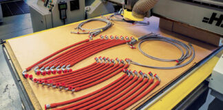

av prewired
A stack of avionics shown with professionally “prewired” harnesses ready to ship to a builder. Installation errors are greatly reduced when the stack is already wired and tested for you.

I’m biased, but I’d recommend that you have the core avionics stack wired by a professional. It’s not that expensive in the overall scheme of things ($500 to $2500), and it’s cheap insurance when we’re talking about $10,000 to $20,000 worth of avionics, or more. It’ll also save you countless hours. Avionics wiring is not magic, but it is tedious and takes careful concentration to get things right. If you do your own harnesses, at least start with a good drawing of all interconnects, and then take it one wire at a time. When you are stringing wires, make sure you leave a bit extra on removable items such as EFISes or GPSes. I leave anywhere from 6 to 12 inches of extra wire, called a service loop, to easily remove those devices from the panel and then disconnect the wires rather than trying to disconnect them first.
