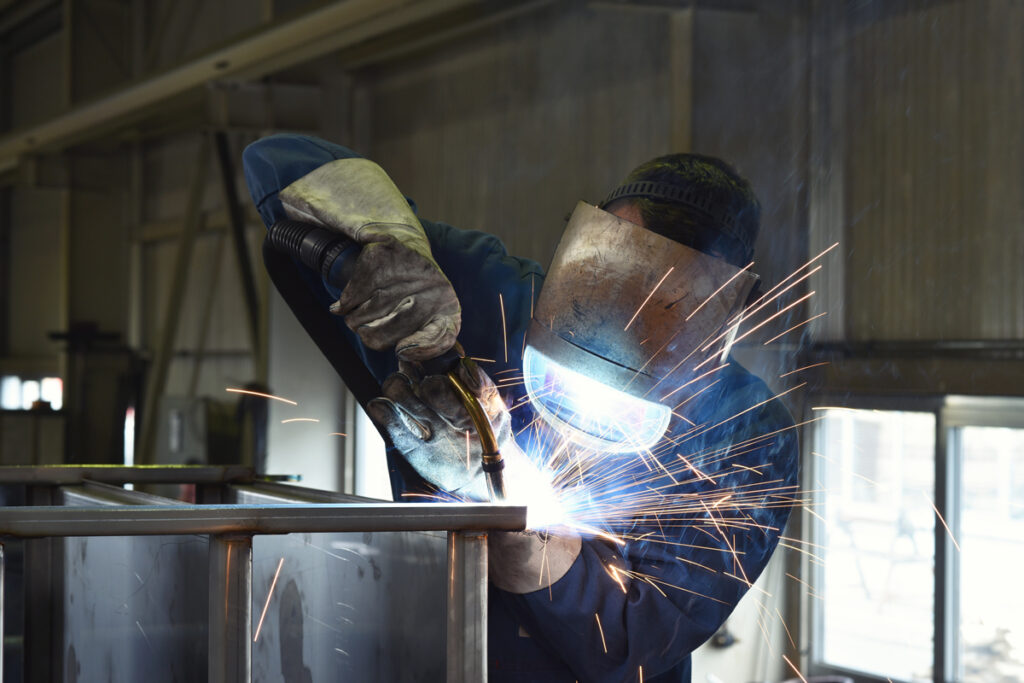

MIG Welding: Speed and Productivity
Metal Inert Gas welding, commonly called MIG welding, has gained traction in aircraft manufacturing due to its superior speed and relatively easy learning curve. The process uses a continuously fed wire electrode with shielding gas protection, enabling faster welding speeds than TIG or oxy-acetylene methods].
Technical Performance
MIG welding offers significant productivity advantages, with welding speeds 50% to 200% faster than TIG welding depending on material thickness and joint configuration. The continuous wire feed eliminates the need to add separate filler material, reducing skill requirements for acceptable results.
The process works well on a variety of steel alloys used in aircraft construction and can accommodate material thicknesses from very thin sheet to heavy structural members. Modern MIG equipment provides excellent arc stability and bead appearance suitable for aircraft applications.
Several major aircraft manufacturers, including American Champion and Maule, have successfully used MIG welding for production aircraft since the 1960s. This commercial validation demonstrates the process’s suitability for aircraft applications when properly implemented.
Critical Concerns for Aircraft Applications
The primary concern with MIG welding for aircraft applications involves the potential for elevated hardness in the heat-affected zone. Sources indicate that MIG welds can produce hardness levels of Rc 38-41 in the weld zone, compared to Rc 19-23 for unwelded 4130 tubing. This increased hardness may affect ductility and create potential brittleness issues.
Industry experts recommend careful attention to welding parameters and post-weld stress relieving to mitigate these concerns. The American Petroleum Institute sets maximum hardness limits of Rc 27-30 for their pipeline welds specifically due to martensitic formation risks associated with rapid cooling.
The process requires more complex equipment setup compared to stick welding and depends on shielding gas availability, limiting its suitability for field repairs. Spatter and slag removal may be required depending on welding parameters and techniques used.
Equipment and Operating Costs
MIG welding equipment suitable for aircraft applications ranges from $300 for basic hobby units to $2,000 for professional machines]. The Lincoln Power MIG 215 MPi, priced around $2,249, represents a popular choice for serious homebuilders.
Ongoing consumable costs include welding wire and shielding gas, typically resulting in lower operational costs than TIG welding due to faster welding speeds. Gas mixture selection (typically 75% argon/25% CO2) affects both weld quality and operating costs.

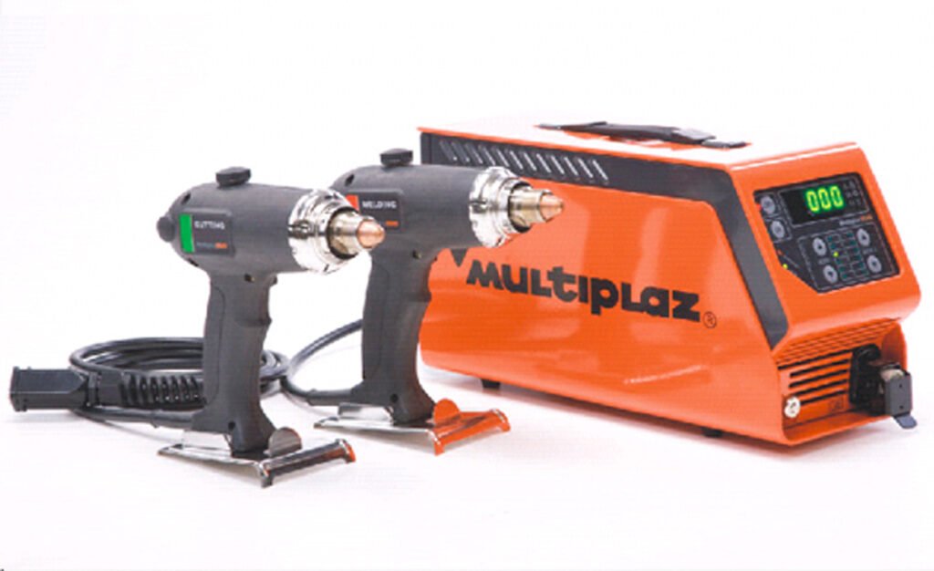

The Multiplaz System
Plasma welding is my personal go-to choice for almost all welding projects. The Multiplaz 3000/3500 represents a unique approach to plasma welding, using water and alcohol solutions instead of traditional shielding gases. This Russian-developed system earned recognition at the Geneva World Invention Show and offers several compelling features for aircraft builders.
The system provides welding, cutting, brazing, and heating capabilities in a single portable unit weighing approximately 30 pounds with a carrying case. Operating on both 110V and 220V power, the system offers flexibility for various workshop configurations.
The Multiplaz 3500 can weld steel from 0.4mm to 50mm thickness and cut steel up to 10mm thick. The absence of expensive consumables beyond water and alcohol provides long-term operating cost advantages. The system creates a vapor shield around the plasma arc, reducing atmospheric contamination and hazardous emissions.
System Limitations and Considerations
The primary limitation is the substantial initial investment, with the Multiplaz 3500 priced at $3,900 at time of writing. This represents a significant cost compared to traditional welding equipment, though the multi-process capability may justify the investment for some builders.
The technology is relatively new and not widely available through traditional welding supply channels, potentially limiting service and support options. Limited experience within the homebuilt community means fewer sources for technique development and troubleshooting guidance.
