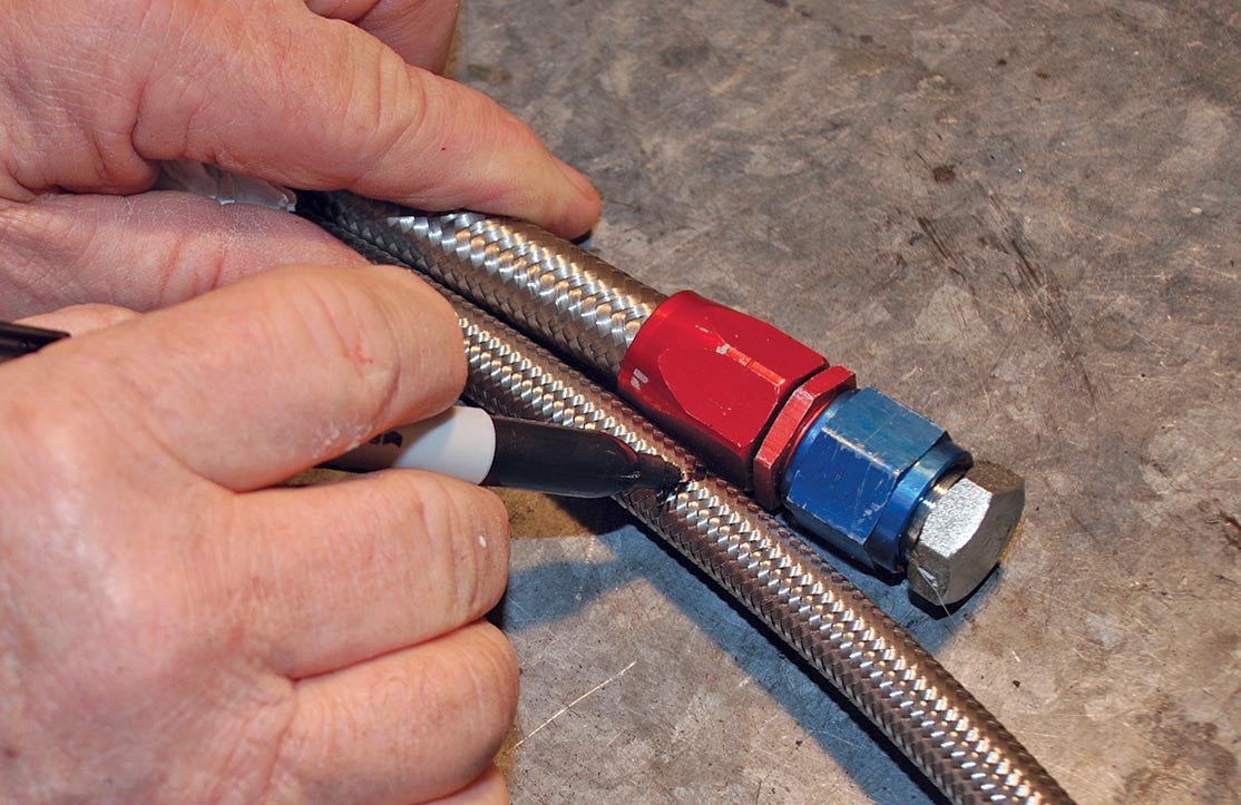

If we are talking about best practices, it is hard to avoid the question: Is it the best practice to make my own hoses from fittings and stock hose, or do I really need to have a professional shop make them for me? Shop-made hoses have two distinct advantages. One, they are tested to twice the rated pressure of the hose and fittings (test pressures of 3-6000 psi). And two, they are available with machine-swaged fittings that cannot be duplicated by most people working in their home shop or hangar. These are distinct advantages of professionally made hoses. The downsides are that they are pretty expensive and any discrepancy in communicating the desired length to the hose maker may result in an unusable hose.
Homemade hoses have the advantages of being less expensive and easier to get made to the correct length (more on this later). The downside is that an incorrectly installed fitting could fail at a very bad time. Many years ago, in my off-road racing days, I had a hose fail and pump all of the oil out of my engine in what seemed no time at all. Luckily, I simply pulled off the course and waited for the tow truck. Since then I am much more careful about how I assemble hoses, and I have never had another failure. The bottom line is that if you use new material and fittings and carefully follow the manufacturer’s instructions, there is no reason why you can’t put together a high-quality hose in your own shop, but if you are careless in your assembly process, you can get yourself into trouble.
Few people will be equipped to test their new hoses to twice the rated bursting pressure, although it is possible to get a pump that will achieve those pressures for around $150. If you decide to test your hoses, it is much safer to use a hydraulic pump than a high-pressure air pump. In any case use extreme caution and be sure to enclose the hose being tested in a sturdy container of some sort. If a hose fails at 3000 psi, flying debris can do some real damage. This is one place where factory-made hoses have a real advantage.
The final concern with hoses, factory made or otherwise, is making absolutely sure they are clean inside before installing them. At the very least blow them out with compressed air. Better yet, pull a cloth cleaning patch through each hose with a piece of safety wire.

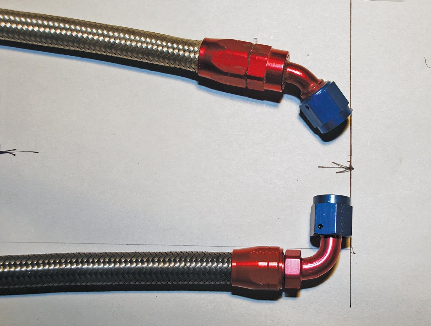

All hoses should be measured for overall length including the fittings, even hoses with 45 and 90 degree fittings.

If you decide to have a professional shop make your hoses, you will need to take accurate measurements to get the correct lengths. You would hate to pay $50 or more for a hose only to have it come up an inch short. The best approach is to first install the AN fittings at the points where the hose will attach, such as your fuel pump or oil cooler. An AN816 nipple or an AN822 elbow would be some of the more common fittings you might use. Then take a length of inexpensive rubber hose of about the same diameter as the hose you plan to use and run it from one connection point to the other. Be sure to use the exact same routing you will use for the final assembly. Hold the beginning end on the end of the far end of the threads of the flare fitting, and run the hose to the end of the threads of the other flare fitting. You can then easily measure the length from the end to the mark. Please verify with your hose maker that this is how they want you to determine your hose length before you submit your order.

Cut your hose off so it just reaches the beginning of the flare inside the fitting. Be sure to tape up the hose before cutting to minimize fraying.
If you plan to install a 90º fitting on one end of the hose, you can get a very close approximation of the correct length by temporarily installing a 90º swivel female to male fitting. Then measure to the far end of that fitting. To be sure you should talk to the hose maker to verify your mutual understanding of the length measurement for any hose with an angle fitting on the end.
