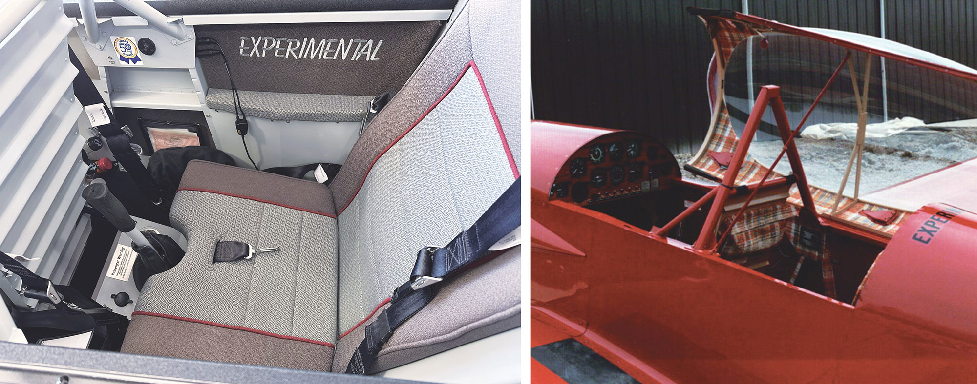

I remember showing up with my RV-4 to Oshkosh in 1983. It was completely different from the other RV-4s in that it had an interior. There were some “persona-non-grata” vibes from the RV crowd as it was kind of unspoken that the RV was supposed to be spartan and light. Hmmm. I knew it needed to be comfortable. Carol was going to fly in it, so who was I to complain, especially since I benefited?
Fast-forward a few years and there were multiple companies making interiors for the RVs, some of which are still going strong today. I think they did a wonderful job of fulfilling a need. Today, I think only about 5% of the RVs I perform a prebuy inspection on do not have an interior. A quick look at most sales ads for RVs will definitely show the interior as a highlight.

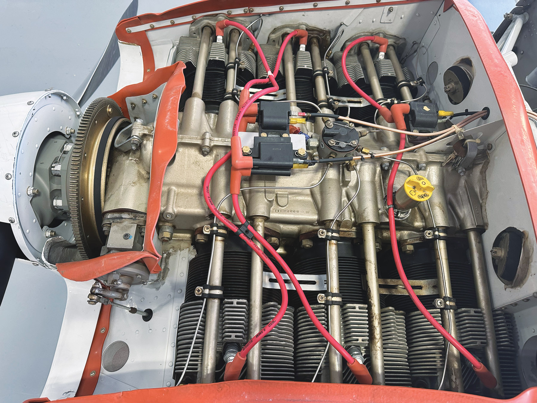

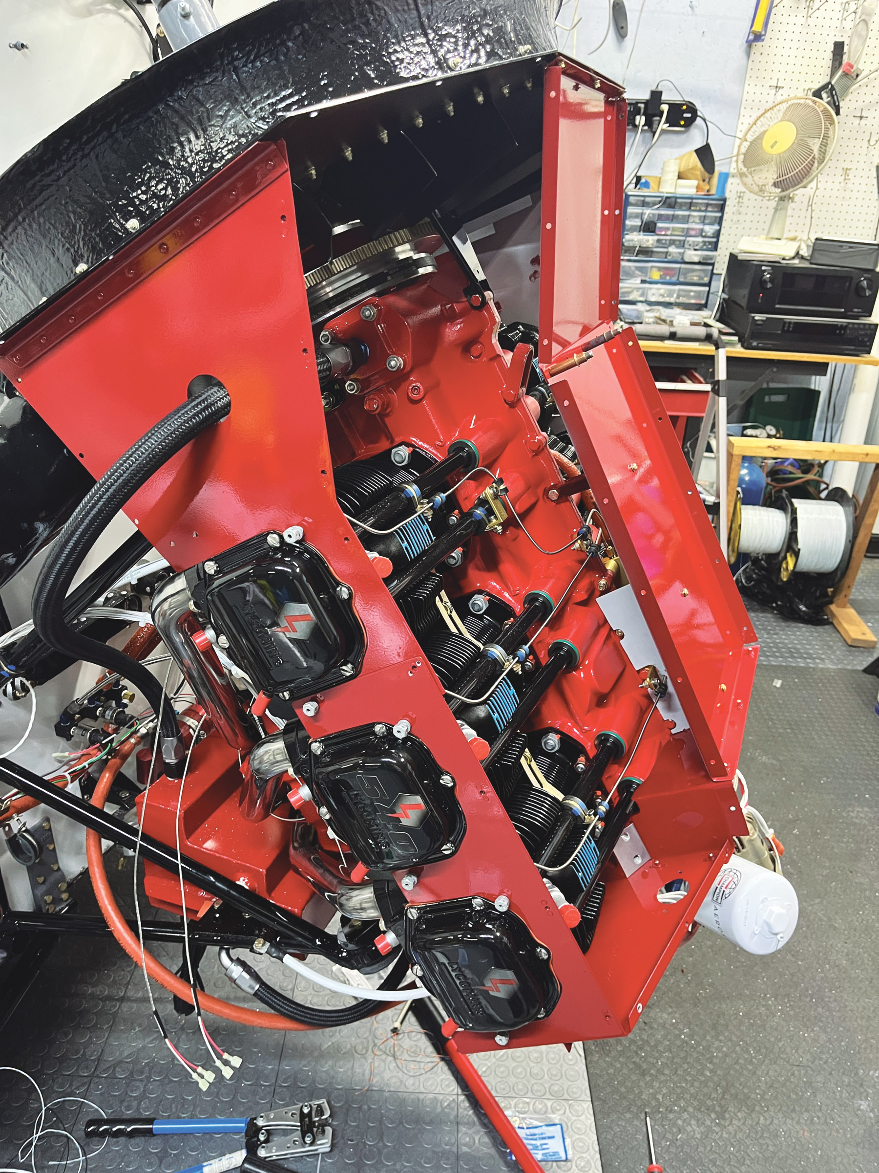

Let’s start with speed mods. It seems every pilot is always wanting to go faster. One of the most prominent speed mods I see on the Van’s aircraft has to do with both speed and cooling in the form of a cooling plenum on the engine and different inlets on the front of the cowling. To be candid, the cowling looks nice with the rounded inlets, but I find the plenums to be a pain.
First, most of them are not built correctly in a couple of ways. They are usually too close to the top of the engine to prevent the plenum from rubbing the cowling and therein lies one problem. For the air to cool the engine properly, it needs to have room to slow down and change direction by about 90°. My experience with our customer base is that the plenums cause higher temps.
Second, the cylinders do move around quite a bit when the engine is running, so the baffling and plenum should not be hard connected between the cylinders. The plenum needs to flex. I have yet to see one that accommodates this need and consequently it causes cracking in the plenum, which I’ve seen in the field. The plenum is usually more efficient at capturing all of the intake air and moving it past the cylinders, so usually there is a need to increase the outlet area of the lower cowling or the increase in back pressure will contribute to the higher cylinder temps. Lastly, the plenum can be a real pain to remove for maintenance as the top is usually held on with a large number of screws. This is, in my view, a case where the improvements aren’t worth the compromises.

There is a practical mod for some of the two-seat RVs that I really like and it has to do with easing the loading of the baggage for aircraft with a slider canopy. There are a couple of companies that make the modification, but basically it allows the canopy to either tip up or slide farther back, enabling you to load the baggage from outside the aircraft rather than struggling with it over the top of the seatbacks. I think it is a very practical modification and we have been asked to do several of them.

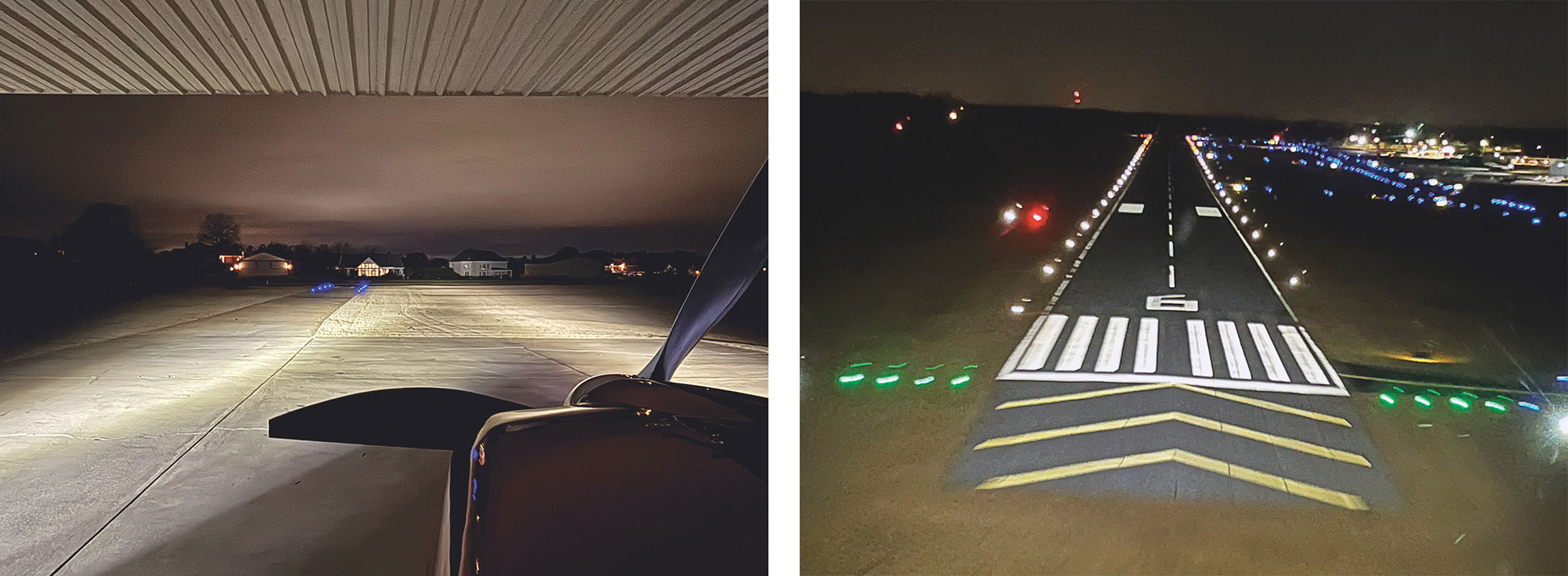

For those of you who plan to do any night flying, I would recommend that you take the time to put the brightest lights possible in your aircraft. It seems to me that as you get older you just can’t get enough light. At least that is my experience. The advancement of LED lights has made night landings so simple. With the right amount of light, properly aligned, it’s almost hard to justify logging a night landing!
