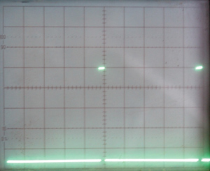

Now let’s look at the lamp driver for the red LED, U101C. Depending on the setting of R101, the output of U101C can be varied from a needle-wide pulse width (very dim) to full on all the time (very bright). By adjusting R101 from one end of its range to the other, the red LED can be full dim or full bright or any value in between.
If the waveform at the output of U101C looks like this, the red lamp will appear very dim.
