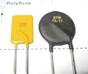

The left device is a polymer fuse; the right device is an inrush current limiter. They are both made with the same chemicals, but one has more of the heat polymer while the other has more of the cool polymer.
Plastastic
Let’s have a little discussion of these plastic fuses we’ll use. Im no chemist, but as I understand it, these fuses are made of two differing types of plastic polymer. One is a cold polymer, and one is a hot polymer. By adjusting the ratio of the two plastics, you can have a material that is a near dead short until it gets hot (a fuse) or a near open until it gets hot (an inrush current limiter). By adjusting the ratio just so, you can have a polymer that gets hot at a particular current level. Our old friend the Mouser catalog shows that the Raychem series of PolySwitches can have fusing currents from 50 mA (0.05 amps) in the RXE series to 14 amps in the RGE series. You can pretty well have any fusing current you wish between these two limits.
Picking a fuse value is something of an art. With regular circuit breakers and glass-tube fuses you generally pick a fuse that is 20% to 25% over what the maximum current of your device is going to draw. Because Polyfuses take a little longer to break, you want no more than 5% to 10% headroom over the protected device. For example, if you have a radio that draws 2 amps on receive and 4.5 amps on transmit with all the lights and bells on, you would pick no more than a 5-amp resettable fuse, and Id probably go with a 4-amp fuse. Why? Because a 4-amp fuse has an 8-amp trip rating, meaning that you have to draw 8 amps to cause it to trip instantaneously (or nearly so). With a 5-amp radio in the transmit mode, it may take up to 5 minutes to get hot enough to trip the fuse. Anyone who is chattering on the radio for 5 minutes deserves to be cut off. And it performs as a dandy stuck-mic indicator.
