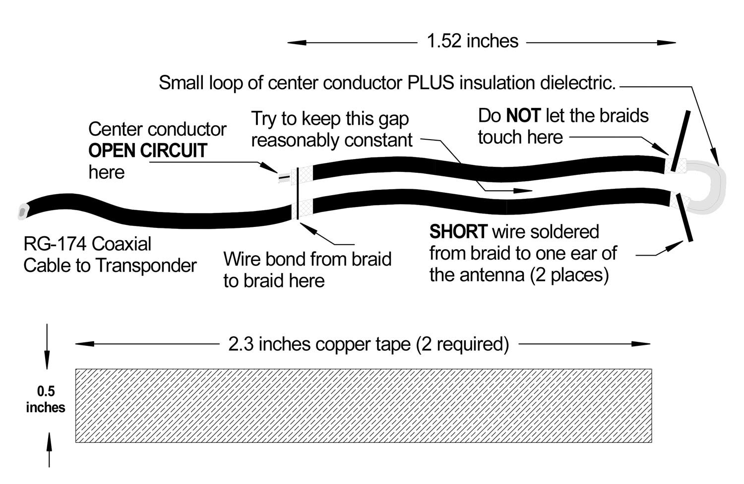

antenna IMG 0939
The entire antenna system, elements (copper tape) and balun (black RG-174 coax), is much less than a 6-inch square.
antenna IMG 0940
Closeup of the balun attached to the copper elements. The green stuff is the homebuilder’s greatest adhesive—hot glue.
So, for the first time in my 35 years of writing this column1, I’m going to give you a design that may or may not work for both USA and “other” systems. Maybe yes, maybe no, but at least I’m going to give my best shot at giving you something to try. Understand that I know the device will work as designed, but whether or not it is compatible with other systems is nothing I can swear to.
What I am going to show you is an antenna that will transmit simultaneously to the sky and to the ground. You folks with plastic ships should be able to cobble up a test antenna in the aft fuselage, but metal ships are going to have a bit of difficulty…with the exception of plastic wing tips and plastic vertical fin fairings.
antenna IMG 0941
The end of the coax-matching element soldered to the main line (right). Note the center conductor of the coax (on the top) is not connected anywhere.

Balun
How to make the balun. It is a tiny little rascal, and unless you are really good with an X-Acto knife, this design may be a challenge. Normally, I use ferrites for a balun. Unfortunately, ferrites that work in the gigahertz range are hard to come by.

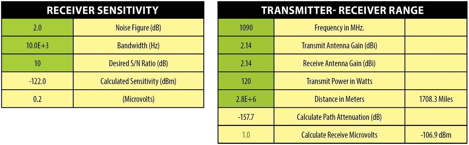

With all of these things factored in, hold tight—I’m going to try and not lose you. The Iridium satellite is going to have to hear your transponder signal over and above the noise generated in the receiver itself. To be quite generous, I want a signal that is 10 times stronger than the noise (10 dB). Even though I ought to be able to decode that transponder pulse train in a couple of kilohertz of bandwidth, I’m going to go five times over on that to 10 kHz. And although there are transistors that have noise figures of less than a decibel, I’m going to say that we have a garden-variety input transistor with a 2 dB noise figure. Putting all that into a spreadsheet, we find that this receiver ought to be able to work with a 0.2 microvolt signal.
transponder range
The spreadsheet showing how I calculated range of the transponder and the required sensitivity of the satellite receiver.
On the transmitter side, it seems that the satellite can be a bit over 1700 miles away (1708.3 to be exact) with a 120-watt transponder transmitter to provide a 1-microvolt signal to the satellite, or roughly five times more than we need for the system to work.

So here is my idea: A simple dipole has a “radiation pattern” that looks like a figure 8—sort of a big fat donut with a hole in the middle. It can radiate up and down simultaneously. The signal that goes to the ground station is also going up into space to “squirt the bird” at the same time. Two antennas are not required with this concept.
Is there some electronic reason that this will not work? No, we’ve been using dipoles for an awfully long time now (Google “Marconi 12 December 1901”), and we are pretty sure we know how they are going to work. However, there are a few tricks that we are going to have to play to get the antenna to work well up at a gigahertz (1090 MHz).
