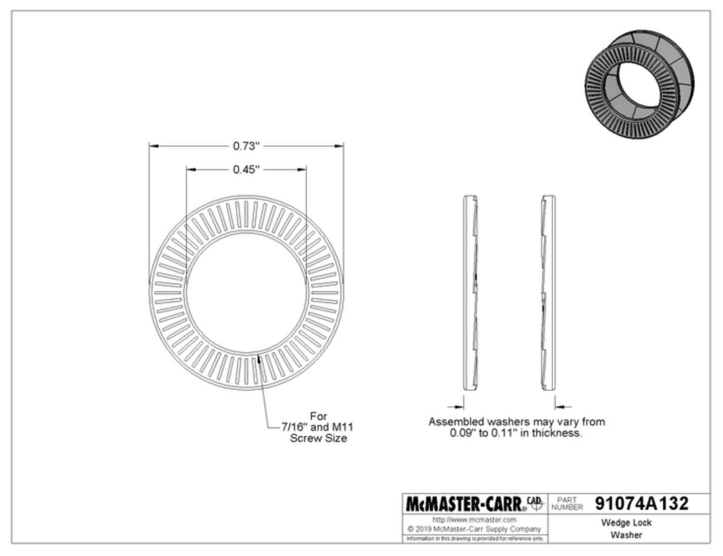

I was also planning to replace the Nord-Lock washers. I don’t have a lot of experience with them and they seemed to be working fine, but I didn’t have a good idea of what to look for when they’re worn to the point they aren’t able to resist fastener movement. Nord-Locks are available from Sensenich as well as my go-to hardware store, McMaster-Carr for a very reasonable price. Erring on the side of caution, I decided to put new ones in when I changed the prop clocking. I’d removed all the bolts, changed the hub orientation (actually remembering to move the spinner backplate, too, so that the blade cutout alignment was maintained) and then fitted new Nord-Locks.
Nord Lock
The Nord-Lock washer, also generically known as the “wedge lock,” is an ingenious device that saves you the effort of safety-wiring with every change of prop pitch.

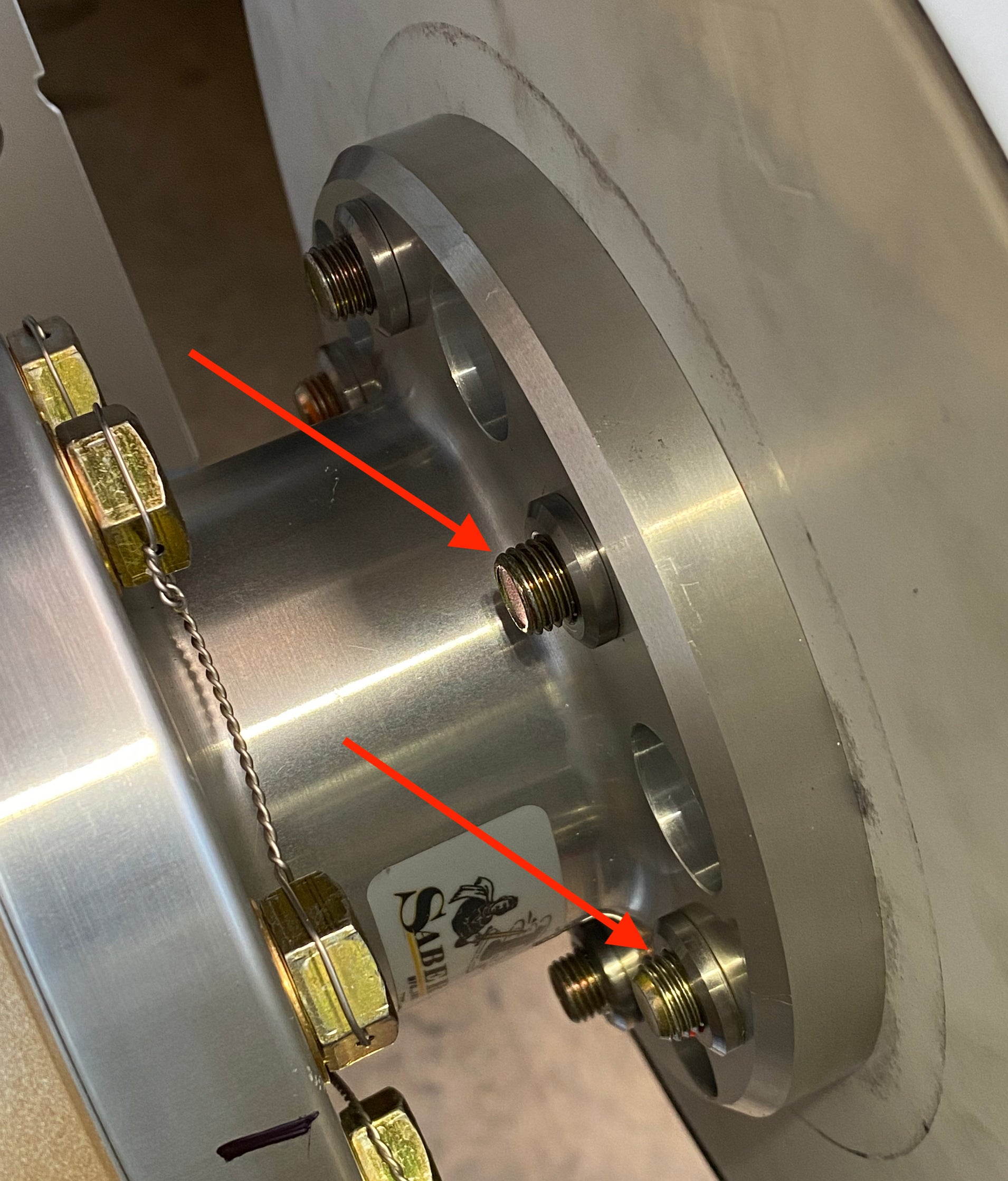

All went well until I realized that one of the two bolts that would later be hidden wasn’t protruding far enough through the threaded inserts on the back face of the prop extension. Hmm. I thought for a moment that I’d mixed it up with one of the four outboard clamping bolts, but they’re all the same length. Hmmmm. I had started the torquing process but stopped part way. Even at half torque, the threads were uneven. It had to be something.
I pulled the bolt wondering if I hadn’t somehow missed part of the Nord-Lock, though I was fairly sure I hadn’t. When new, these washers have an adhesive between the two faces and they act like one washer until you torque them for the first time. So, look at the other one. The single Nord-Lock was on the shank of the bolt and the interior socket of the hub looked fine. It wasn’t until I’d turned to my mobile work bench and noticed that my pile of old Nord-Locks was missing one half. Ah-hah! Look more carefully inside the hub and there it is: half of one of the washers, which looked a lot like the hub itself. Why? The Nord-Locks turn a little dark between their halves and the lighter serration on the outward-facing surfaces can dig into the aluminum hub and make the area look a little shiny. I’d become accustomed to this trait and just didn’t notice when half of the washer stayed with the hub. They looked enough alike that I’d not noted the difference at a glance.
Mystery solved, and another lesson to remember: If something doesn’t seem right, keep going until you understand the reasons why.

  2. Your lock wire on the engine side looks like it was done wrong (bolt closest to the viewer) it looks like slacking the bolt will loosen the wire. May be optical allusion in the photo.
    Mike
    • It’s an optical illusion. The safety wire does angle down toward the other bolt, so it would be in tension if the bolt tried to back out.
