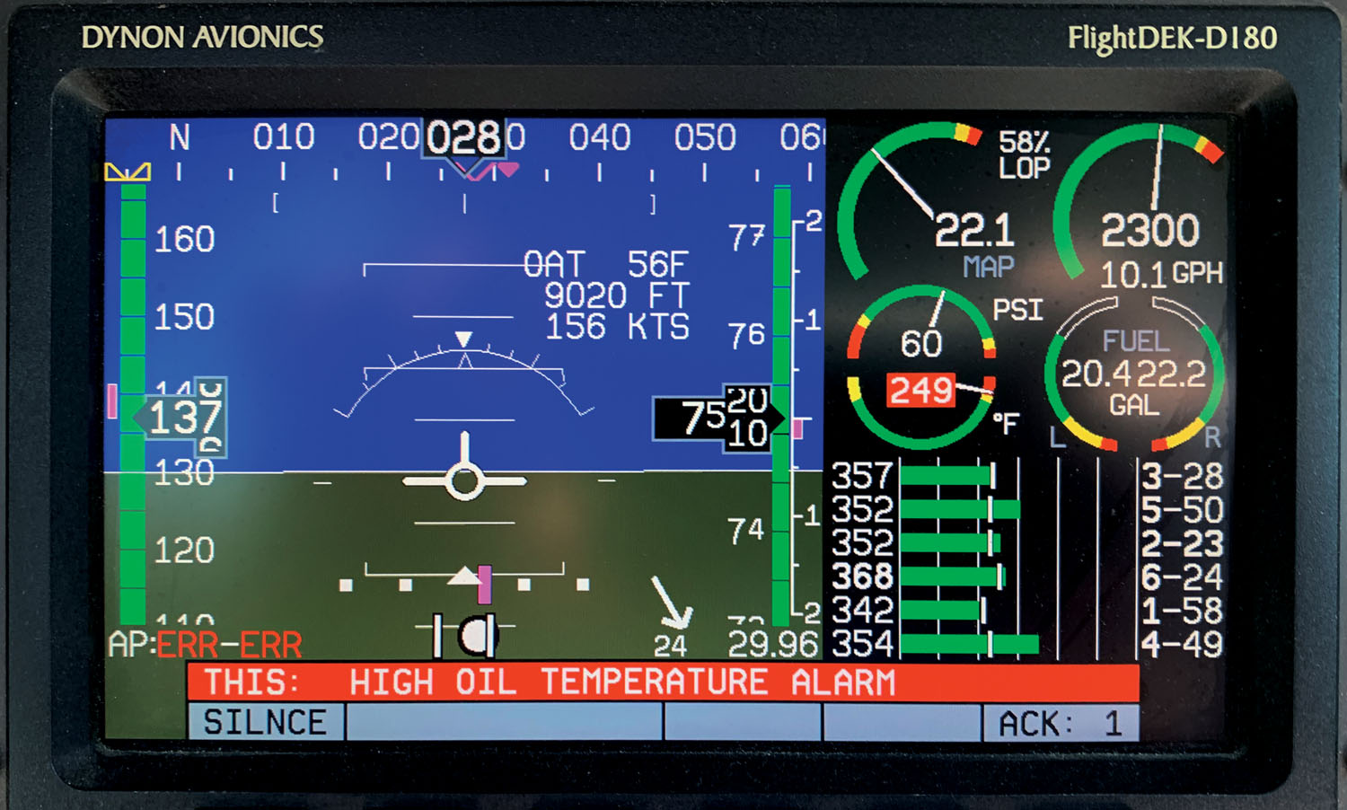

I emphasize that it is vital that you verify that the oil temperature sender and its gauge are accurate and working correctly and that the oil is flowing through the cooler before futzing with the vernatherm. On my Velocity, I have an older Dynon EFIS that digitally displays the oil temperature. I have consistently high oil temperatures in flight. For seven years and 400 hours, I saw oil temperatures in cruise of 225 to 235°. And this plane has two oil coolers. I did attempt to verify the accuracy of the oil temperature sender by testing it in boiling water before diving deeper into troubleshooting. I swapped out the vernatherm for a new one. Still too high. For years I tried increasingly creative (and time-consuming) ways to fix the problem, including several radical alterations to the airflow across the oil cooler and a few different oil cooler locations with all the downtime and fiberglass havoc that involved. I also came perilously close to irritating my on-field A&P and friend with incessant questions and complaints. No joy.
On one flight, I had to use pitot heat. Not for the first time, mind you, but it was a rare occurrence. I flipped the switch, and the digital display of oil temperature jumped 15° and then dropped 15° when I turned off the pitot heat. Later testing showed that when I shut off the avionics switch, the oil temperature magically dropped 15° only to jump up 15° when I switched it back on. Obviously, I have some stray electrons to corral to solve my oil temp “problem.” For now, I choose to fly the bejeezus out of my airplane on fair weather days, troubleshoot electrons on other days and always send my oil in for analysis at oil changes. My vernatherm works just fine, thank you very much. In short, the simplest solution is probably the correct one and remember always to fix the cheapest thing first.
Postscript
In the process of reviewing this article, the editor suggested looking at a somewhat well known issue with Dynon oil-temperature probes for Lycomings—that they can be error prone where there is potentially a great deal of difference between the engine ground and the instrument ground. The change in readings with and without pitot heat suggested an electrical/indication issue that I thought could be wiring.
On his suggestion, I tried substituting the Dynon sensor (model 100409-001) with GRT FT-LC-01 sensor; both mount in the traditional probe well on Lycomings. Legacy Dynon engine monitors can read this probe with a simple setup change.
Miraculously, by changing the probe, my oil temps fell by 25° with no other changes. Other builders report similar experience, and note that the GRT two-wire probe seems to work more smoothly, with less of the “needle wiggle” often seen with the Dynon probe. And even after Dynon “re-characterized” the probe in 2006 to help reduce high-indicated oil temps, there seems to be some electrical sensitivity present.
Of course, the question could be: Which is more accurate? Was the Dynon right and I do have high temps, or is the GRT closer to right and I’ve been chasing ghosts all along? Well, this is why we test. One thing I know: It wasn’t the vernatherm.
