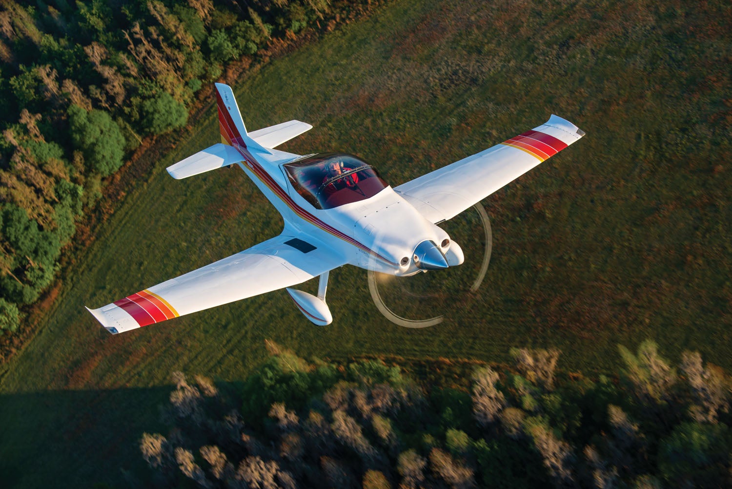

Mustang II KP RV84697 R VanderMeulen“For the time and money invested, there is no other airplane of this type that I would rather have,” said Paul Cox of Fort Myers, Florida. Without context, his opinion leans toward the homebuilder hyperbole side of the dial. The Experimental/Amateur-Built design he’s talking about is the Mustang II. He’s scratch-built two of them from the same 78 pages of plans he bought from the designer, Bob Bushby, in 1968.
When requesting N-numbers, Cox asks for the year he finished building the airplane. He was successful with his first Mustang, N72PC, in which he logged 1050 hours over 10 years. He sold it to build the second one with more fuel and horsepower and equipped so he could earn his instrument rating in it. “N86PC wasn’t available, so I had to settle for N80PC.”
Cox earned his instrument rating in 1989 and since N80PC’s first flight in 1986, he’s logged more than 3300 hours in the Mustang II he still flies a couple of times a week. “I’ll be 85 on my next birthday, in January, so you can imagine that I’ve slowed down a bit,” he said, adding that he hasn’t made many long flights for the past couple of years, since his wife of 63 years, Sara, can no longer climb into the cockpit.

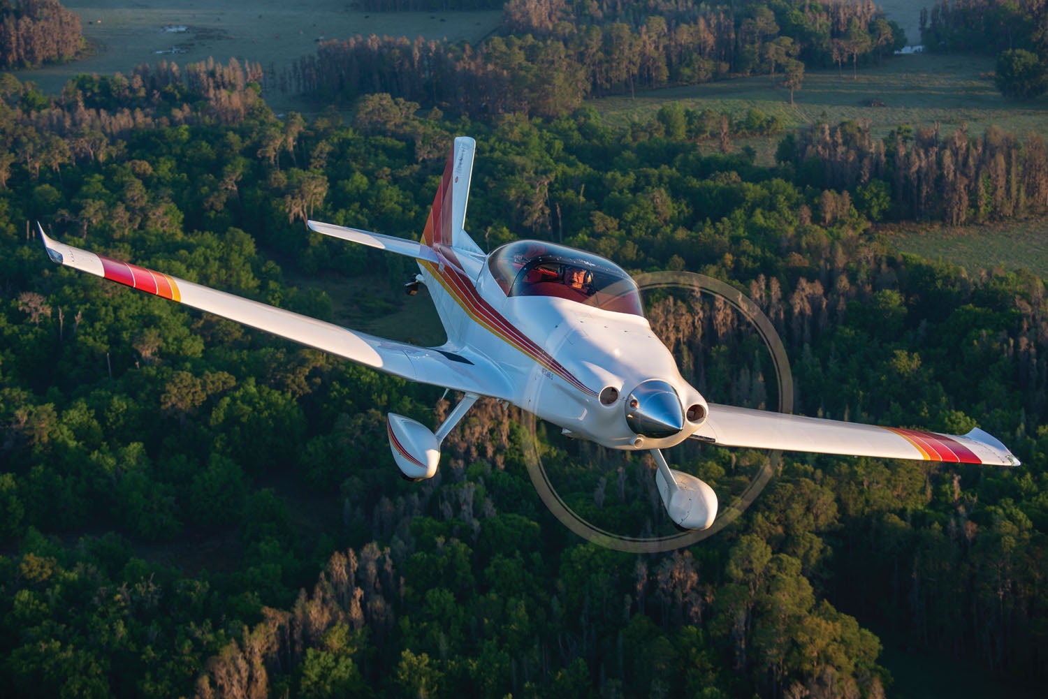

Cox built N80PC (shown here) from the same set of plans he used to build his first Mustang II.

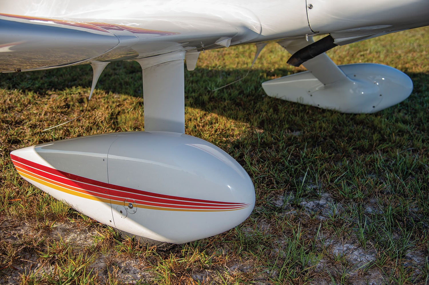

Cox built N80PC as a taildragger, but the Mustang II can also be built with tricycle gear.

The tailwheel is from a Maule.
